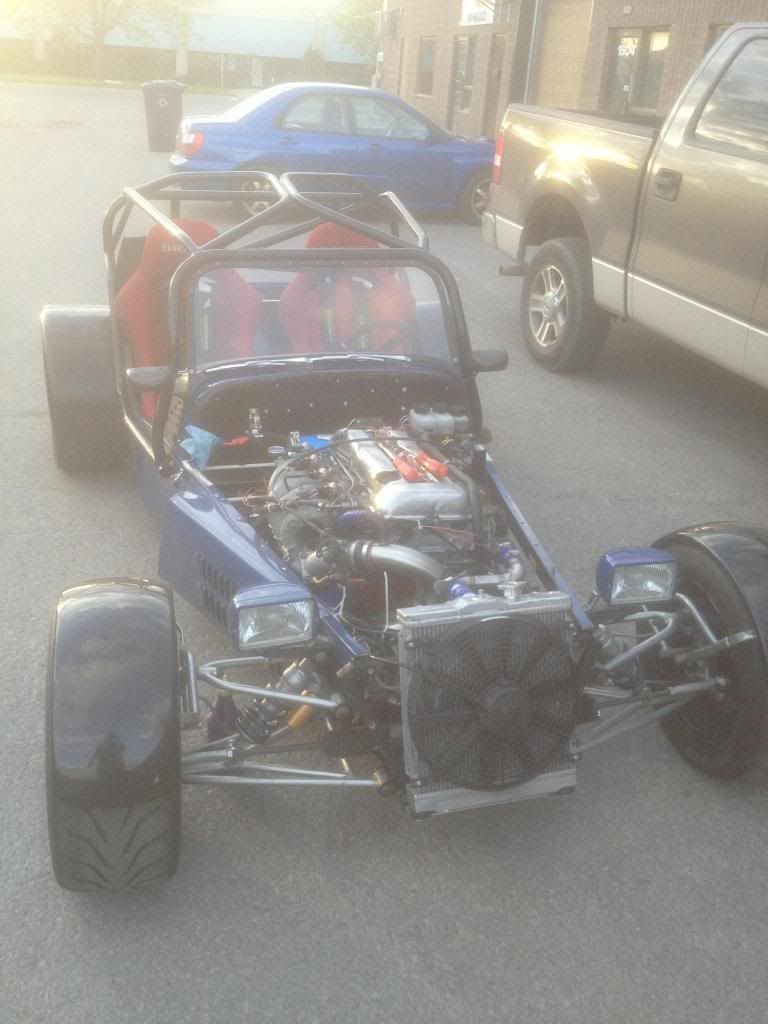

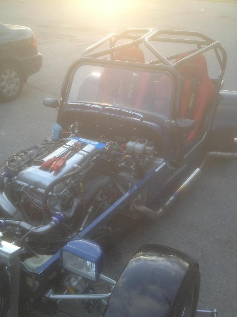

Here is a lotus super7 replica with a sr20det ! We just did a tuebo swap from stock s14 t28 to gtx2860r !
Ill post the dyno result soon

sweet project..... that thing street legal?

Yes ! The owner is driving it to is time attack chalenge around here ! Must be a blast to drive
We ran out of fuel ! The owner didnt even know what fuel pump he had in the tank !
Sr20det engine and transmission , mazda miata diff , custom drive shaft , aem ems4 ecu , 7**cc injectors
It made Around 280whp at 14psi // mustang dyno
