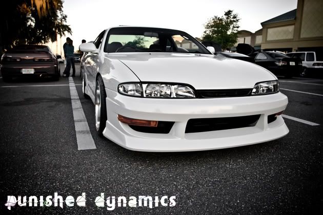

here are more pics as requested
i still need my clear corners and to match the rear fitment one side diff then the other im trying to decide which one i wanna go with
cant wait to get the valences on
about to reinstall the motor in about a hour

Wow, looks good!

Whoa, that zenki is perfection man, that car is so clean, good job

Specs on the wheels? Looks freshhhhhhh

The car's looking fresh with the new wheels. I like the rears like this, I say do this one. Either way though, your car's look dope.

dude....clear corners make your car look 100000x better. seriously.

10.5 +15 with 8 mil spacers to clear coils and 225-40-18 front
10.5 +15 265-35-18 rear

s14fbs....car looks good! Love the new wheels....as for the rear alignment, I like the passengerside, I prefer the poke than the tuck.

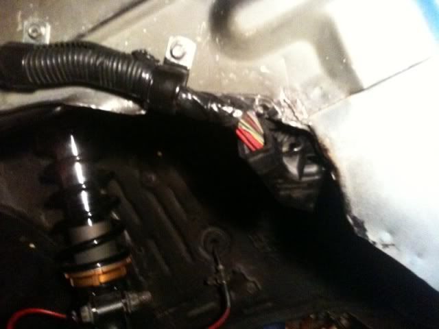

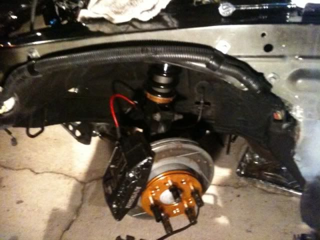

oh and i remember somebody asking about harness relocation i have my fender off so im going to take a pic of the way i have it located to help who ever was asking

heres some pics of the way i did my body harness i also cutt that metal flap out that like joins the body together and i run a 10.5 with a good amount of angle and it doesn't touch
sorry night iphone pics
