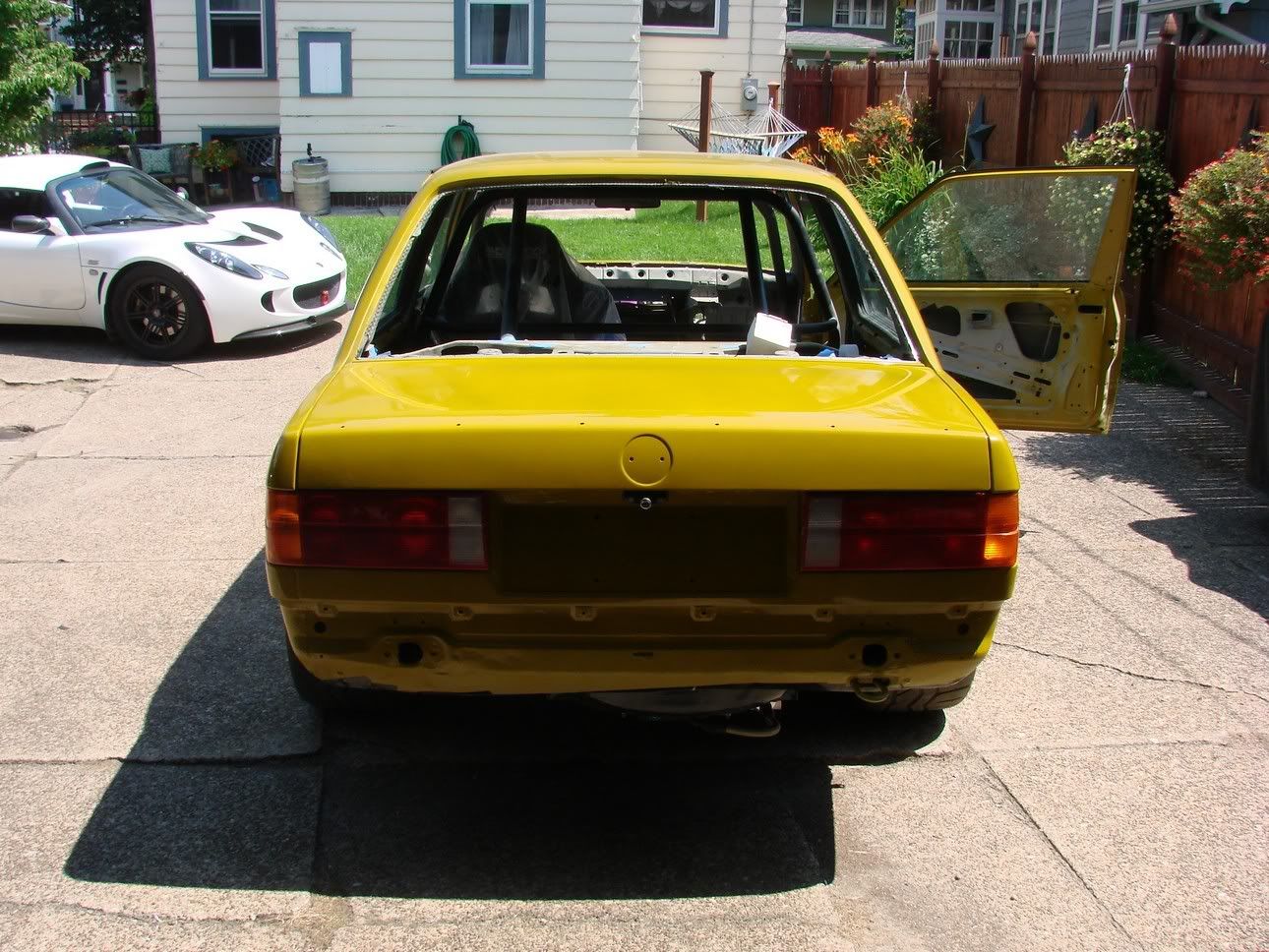

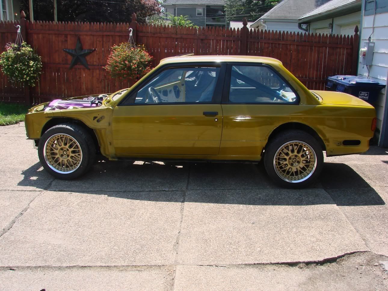

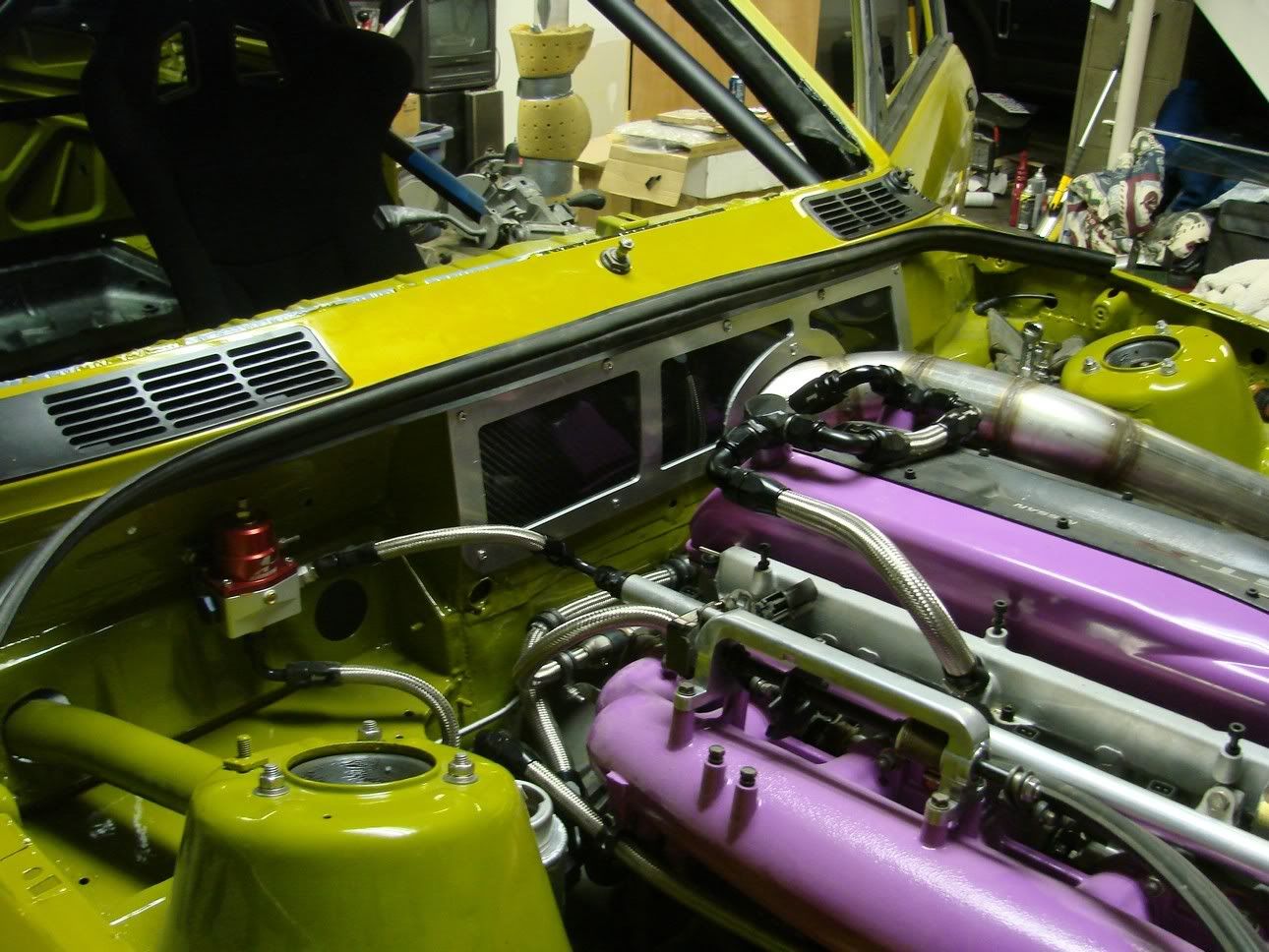

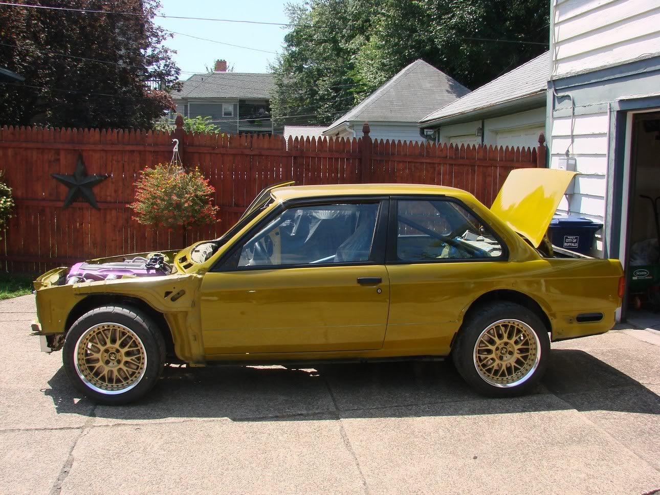

More shots of the outside. It's even more yellow than it appears in photos. Very odd color indeed. 4/6 windows are in. As is BLACKED OUT TRIM
PHAT AZZ... (the apron has some black on it at a weird angle so it looks crooked, but it all gets covered by the rear valence) Also got the trunk latch and tails installed. Looks like a fox notch hahah.

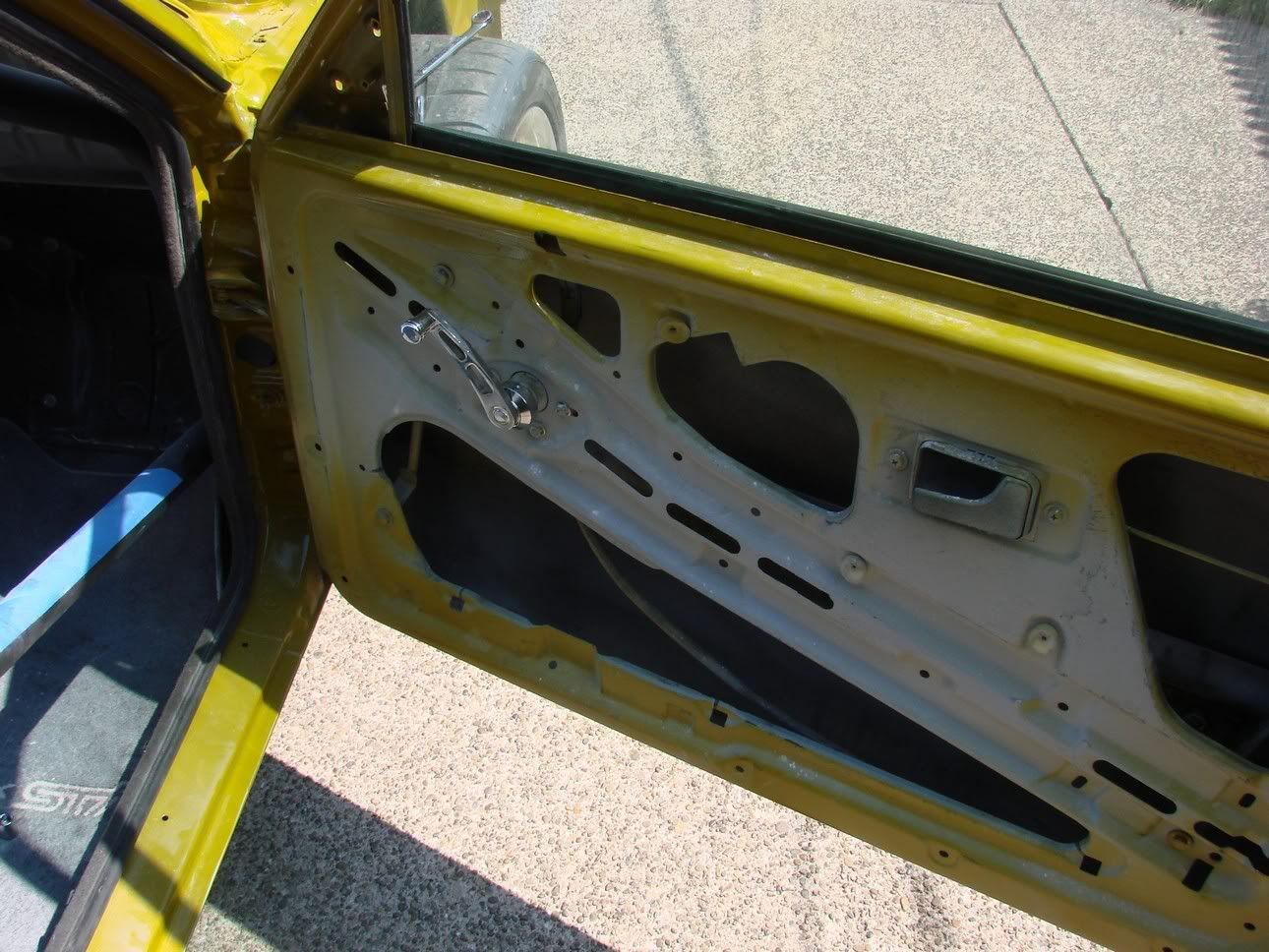

A shot of the CHROME BILLET WINDOW CRANK$$$ installed (23 bucks from summit)

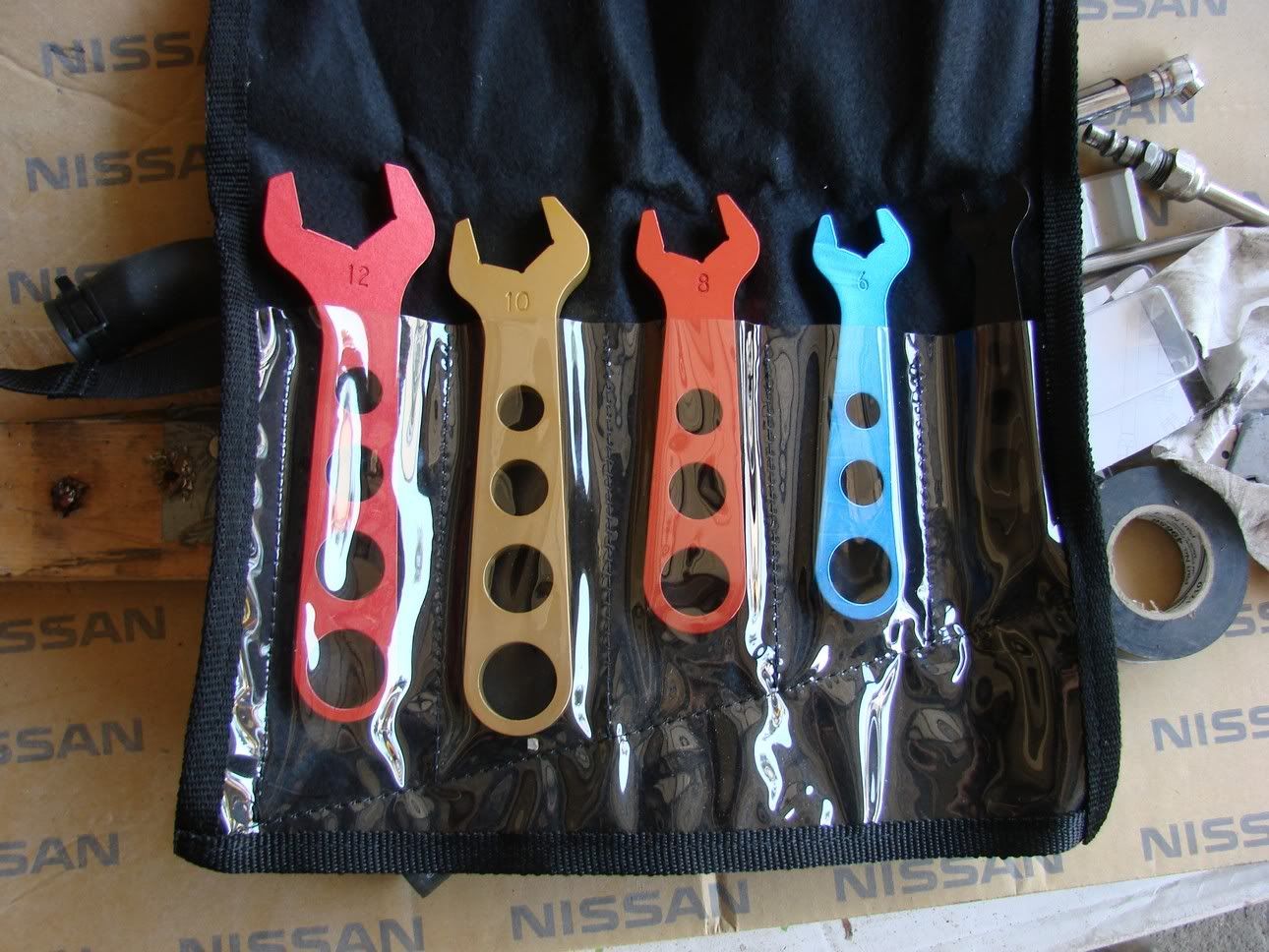

And FINALLY got a set of these. SOOOO much better than a crescent wrench with electrical tape on it.

lol sti mats.... and im lost on the wrenches? but they look sweet

They are AN wrenches. They have reliefs on each corner so you don't scratch up your AN hose ends.

Yup, work fucking sweet too!
... and they're small enough to fit in most places, while limiting the torque you put on the hose ends. I've seen soooo many people overtorque their AN fittings... That set run you about $100?
Yeah, it's sad seeing the shape most people's AN fittings are in! There's not a LOT of torque needed for a proper seal, and most times, more torque creates problems! Please, anybody reading this thinking "Man, I'm TOTALLY blowing some money on sweet fittings for MY car!" LEARN TO USE THEM PROPERLY!!
These wrenches are pricey, but that cost will come back to eat your face when you're replacing fittings! Also, read about the proper way to use them! NO teflon tape!!

i see. i have not gotten into AN fittings yet i have tried to study them some but unfortunaly for me i live in a small town so i cant find a local car place if you will to just go check them out and see what i need. maybe i should just order some from summit and just figure it out. lol
Not to threadjack too much, but whatever purpose you're thinking about using aircraft lines/fittings on, has been done before. Google is your friend. As far as sizes, it's all based on what size pipe/hose you're starting with, and you can usually stick with OEM size (or 1/16" bigger) for everything.

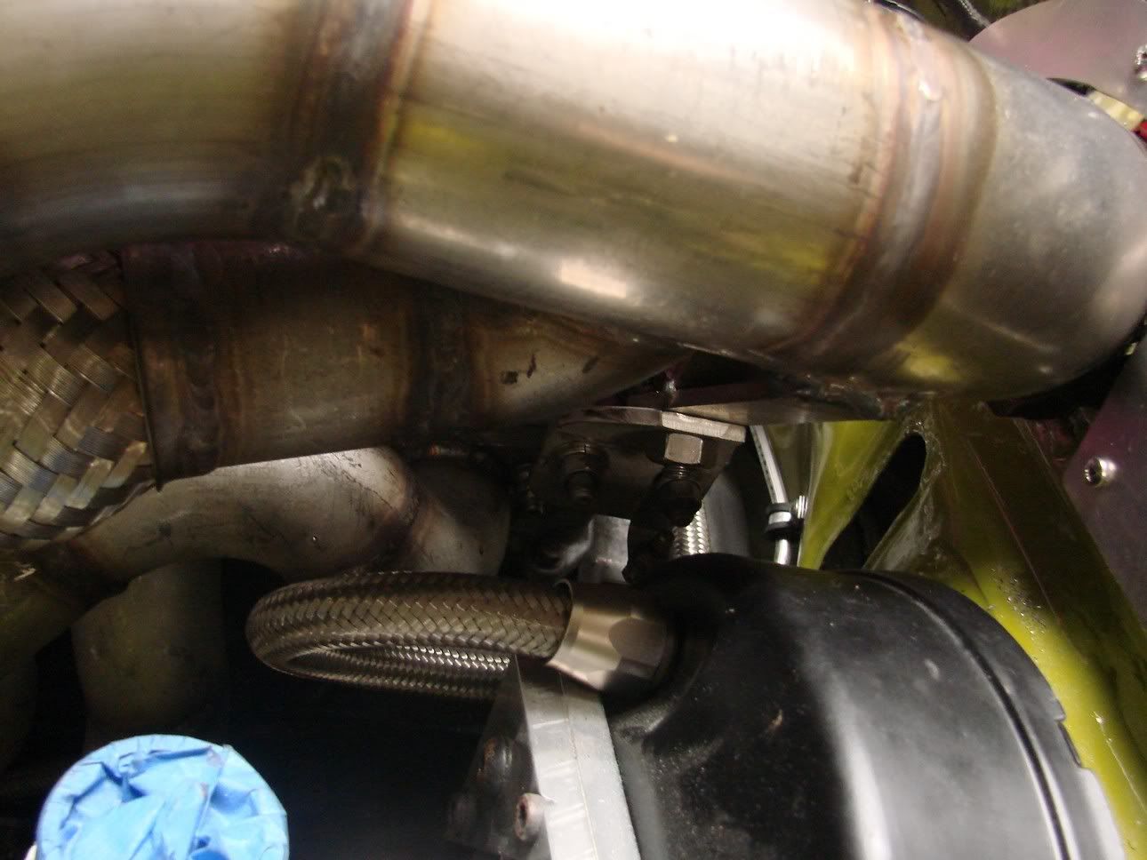

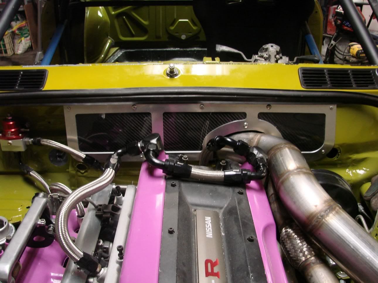

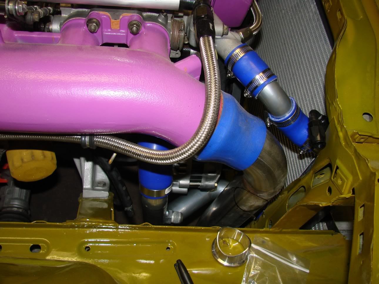

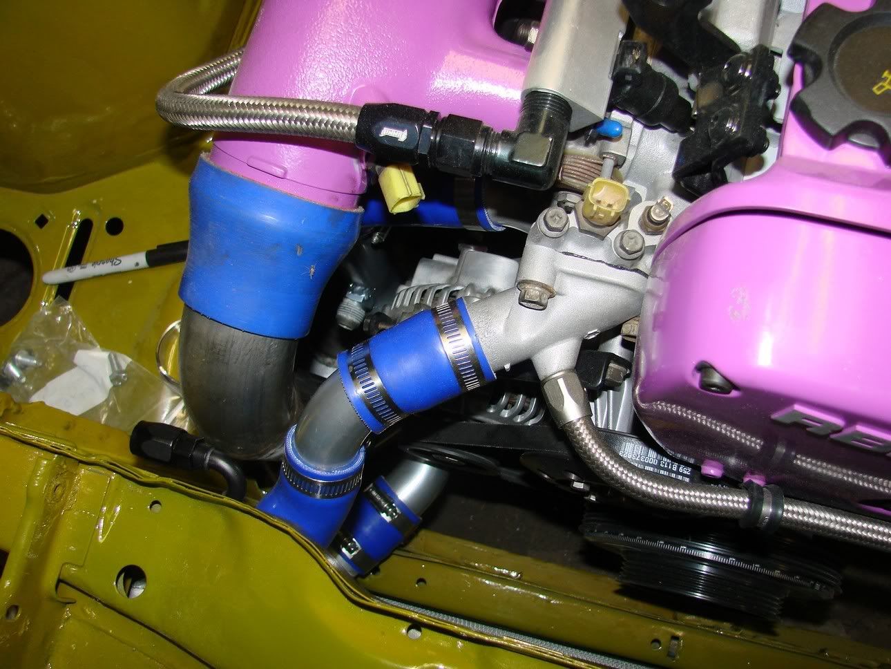

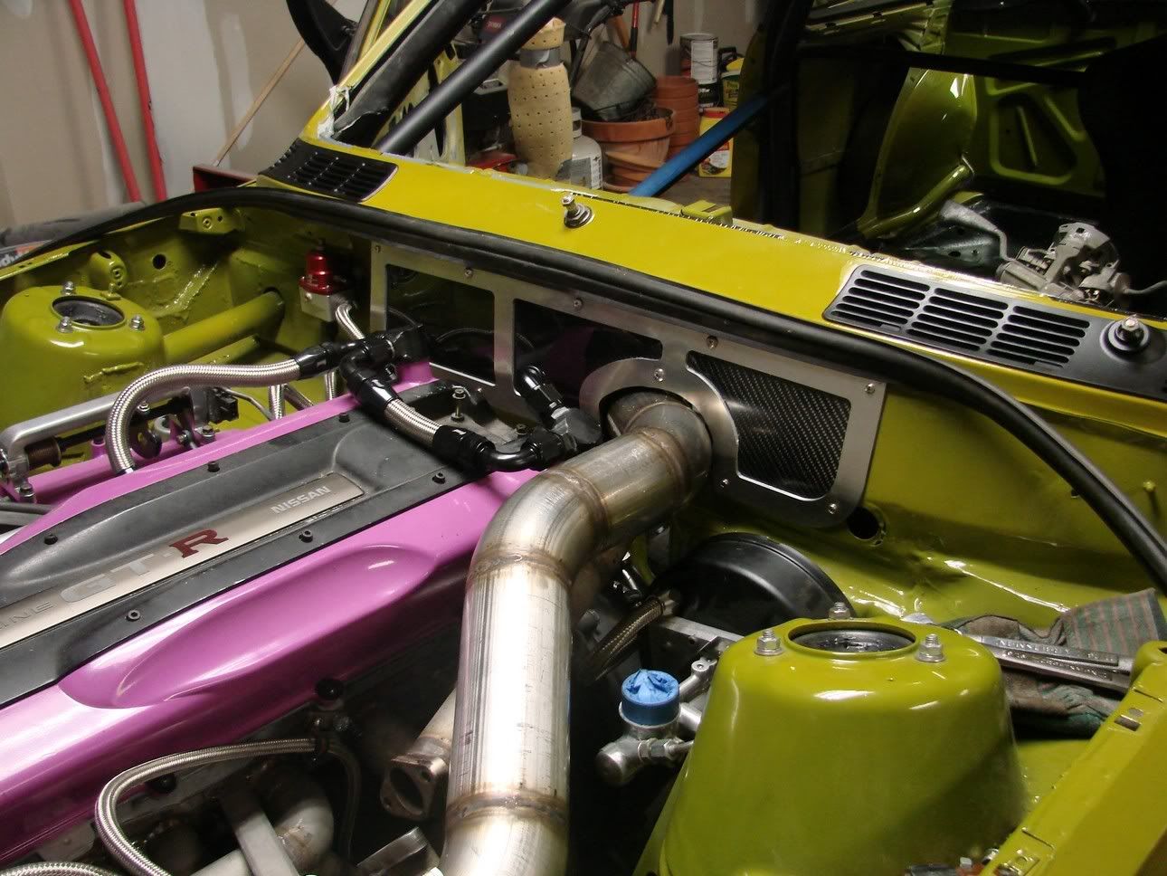

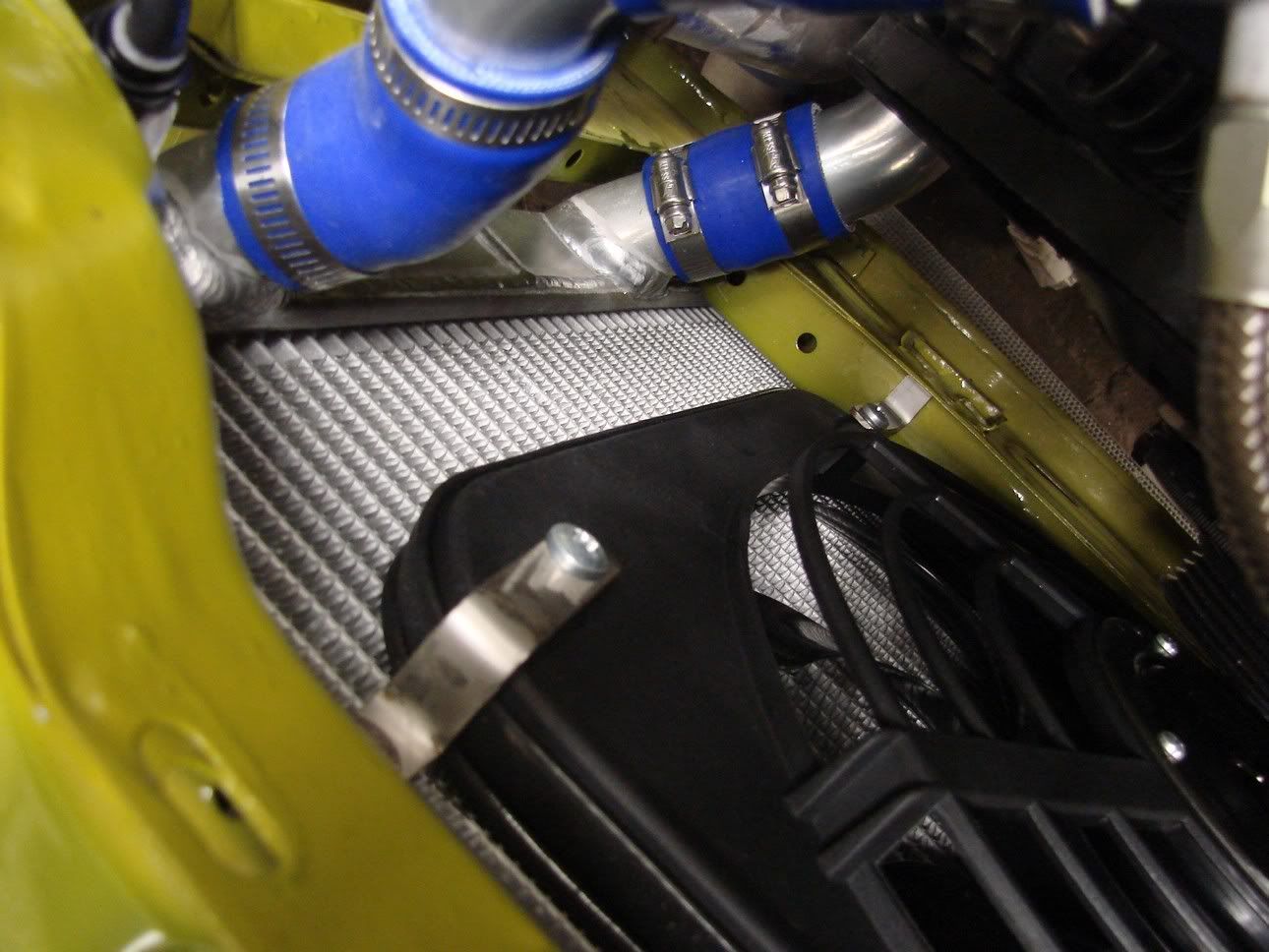

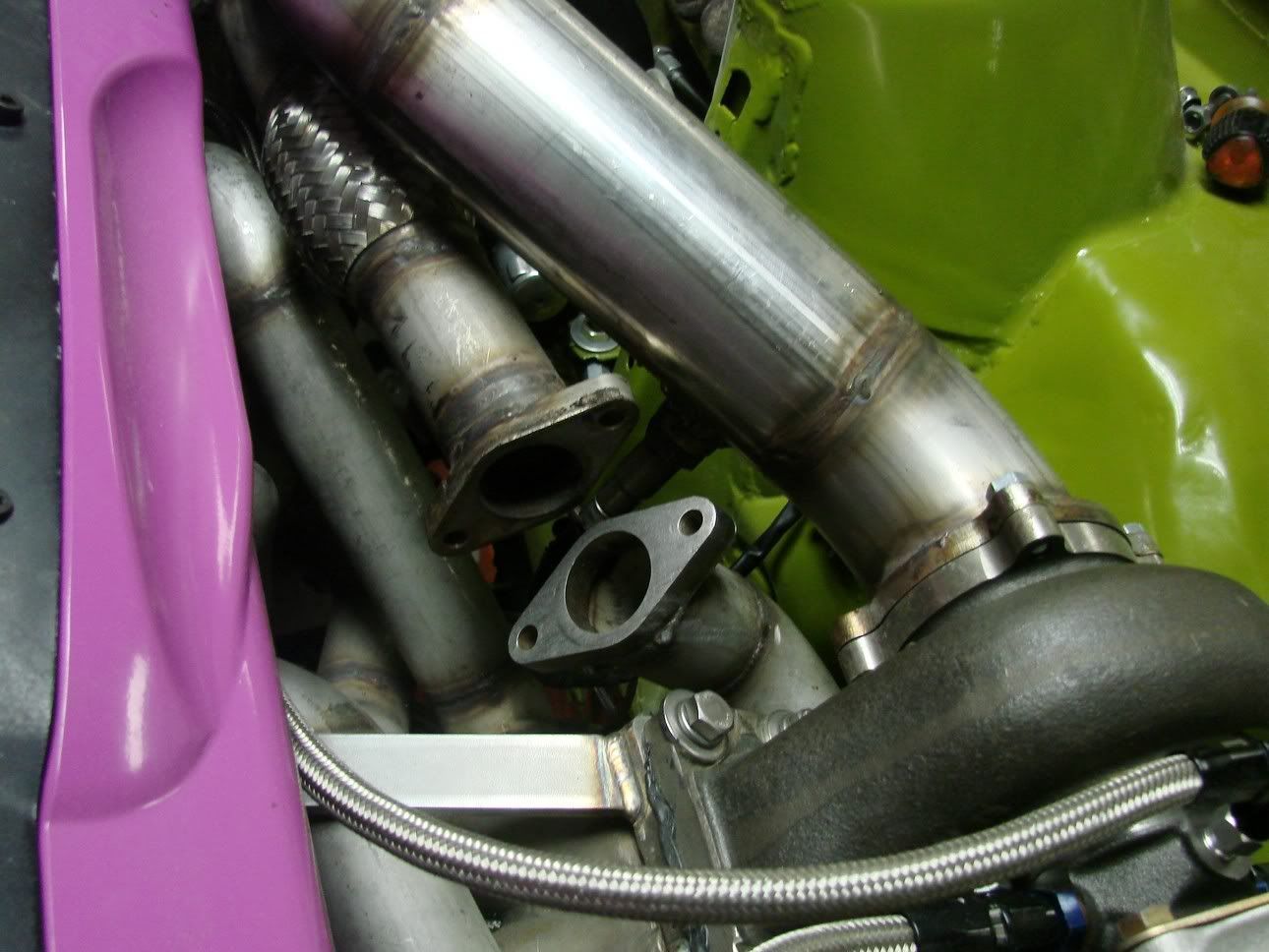

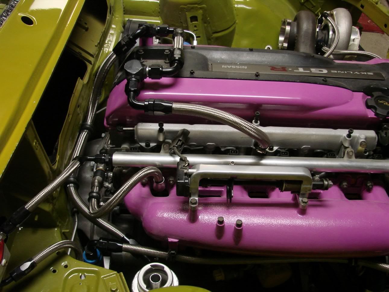

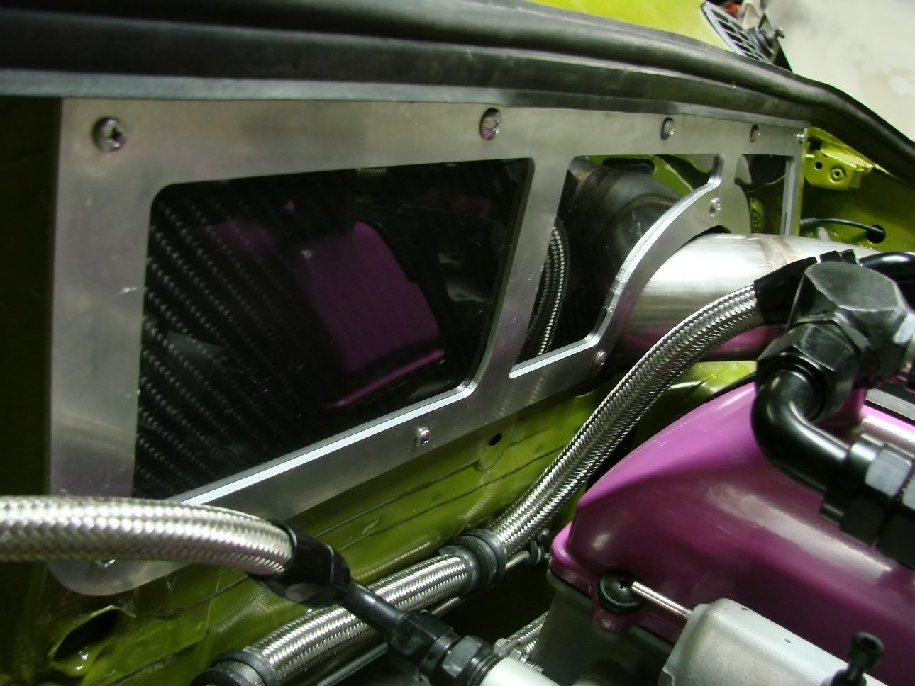

Added a line clamp for the oil feed line and installed the EGT fitting into the manifold. The schedule 10 should be thick enough to not weld a bung on there, time will tell.
Powdercoated coolant pipes installed, you can also see where I am going to weld the BOV flange on.
Steph's baffled catch can installed. You can kinda see how the lines route now. One more line comes from the bottom of the catch can to the exhaust scavenger, which will be after the WG return and flex section.
A shot of the line feeding the catch can and also notice the brake booster check valve installed in-line.

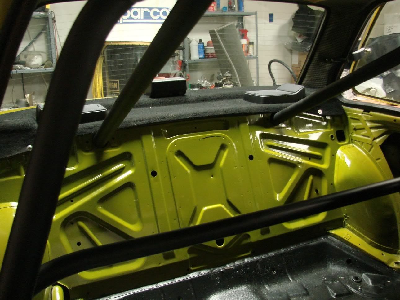

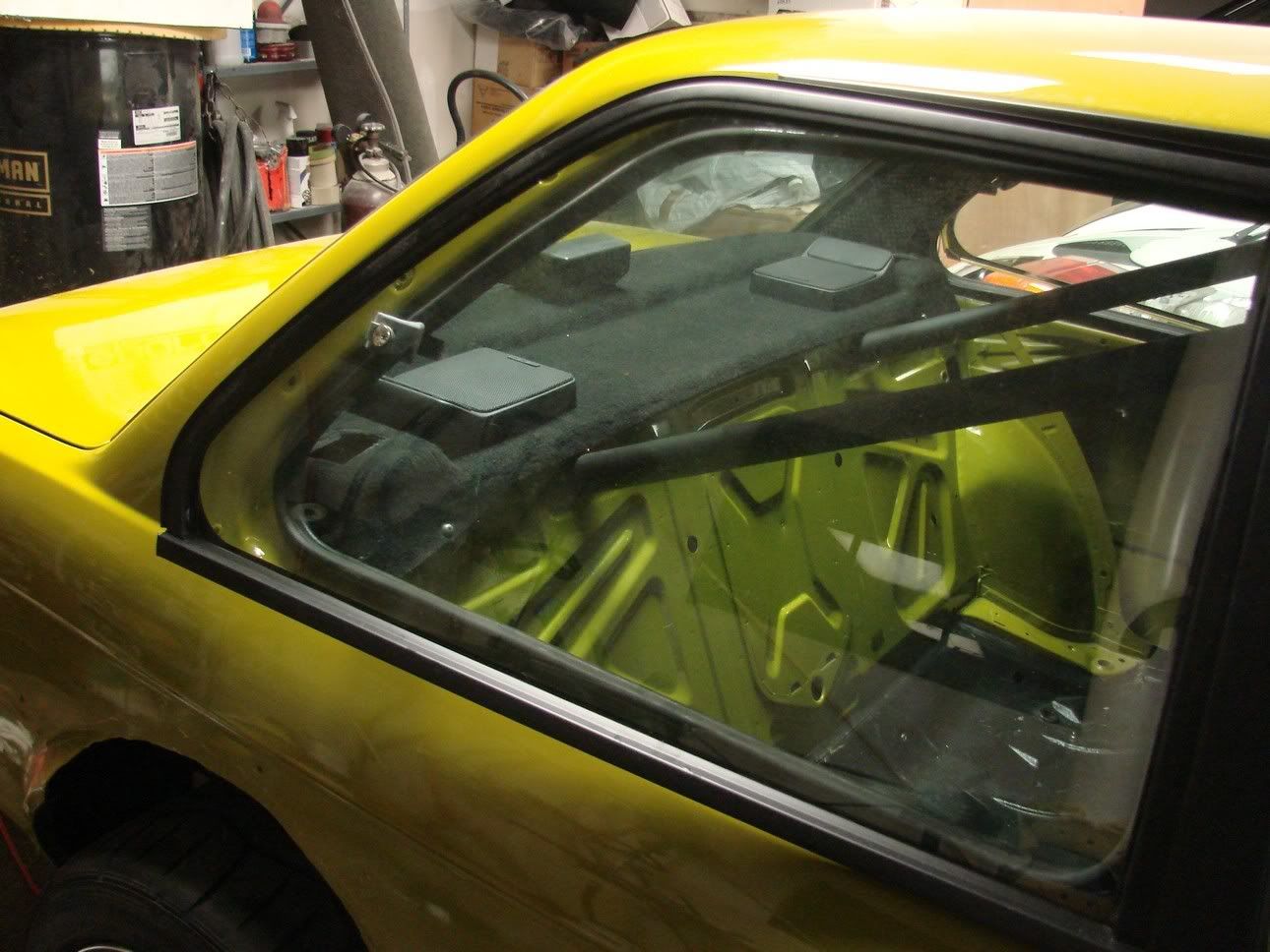

Rear PACKAGE TRAY dyed black and installed. Instead of factory mounting I simply chose to use 2 stainless self-tapping screws in the front and clips in the back.

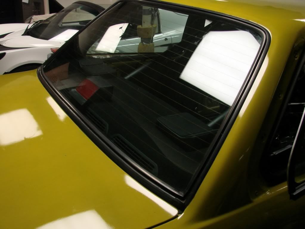

Lastly for tonight: Back Glass.
RB26DETT BMW E30 BUILD:
onyxsyndicate.com/newman/e30gtr/e30gtr_00.html
ctnewman is offline   Reply With Quote
Old 08-04-2009, 09:04 PM   #761

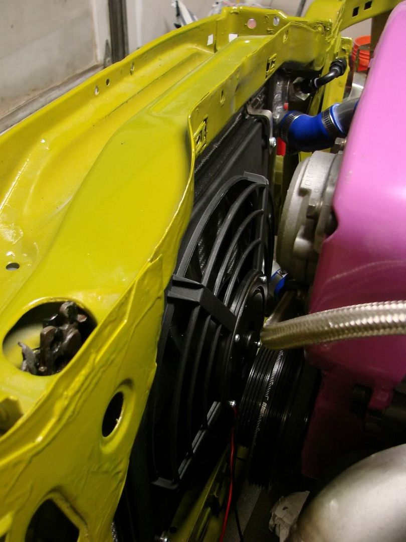

Wiper motor installed
Cowl grill installed
Radiator fan installed
Wideband O2 Bung welded on
Exhaust hanger welded onto rear of downpipe, bolts to head. Very sturdy.
My shit is near OEM.
My firewall closeoff needs to be remade, though. It doesn't fit that well, but it's going to look pretty slick.

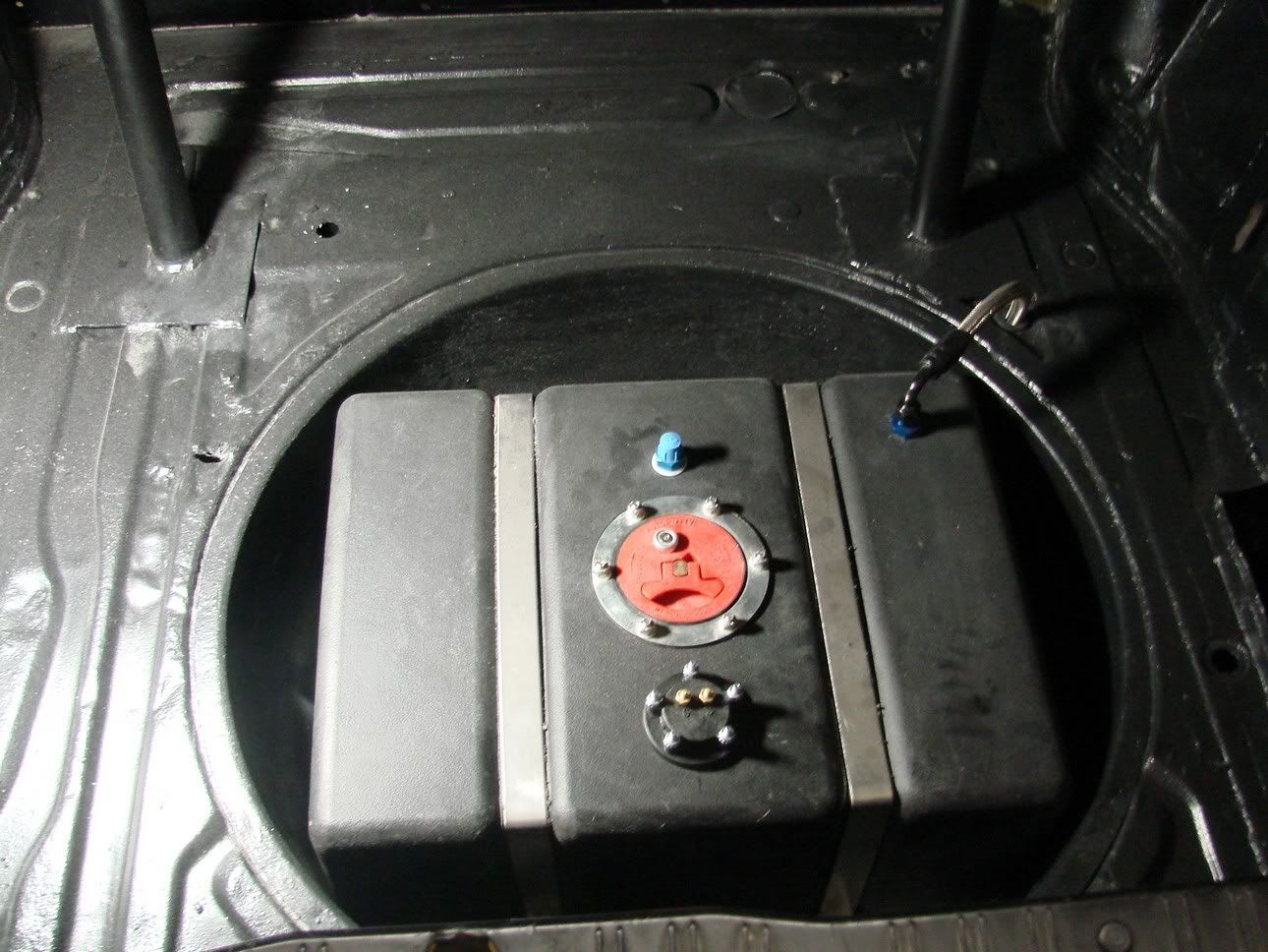

Send a message via AIM to ctnewman
First thing I did was install the fuel tank level sending unit. Pretty straightforward.
Radiator fan installed:
Wideband bung welded on:
Spiffy downpipe bracing to motor:
Lastly, and most awesomely, I made this closeoff out of laser cut aluminum and pre-preg carbon fiber.

its to bad you couldnt just dump those terribad exhaust fumes right out your fender.... that would have been interesting to see. either way looking great.
oh and i guess im blind cause i dont see the o2 bung.
not to be a dick, but to be a dick....
Devil Man is offline   Reply With Quote

haha, just look for the silhouette of the O2 sensor itself.

holy crap i dont know how i missed the o2 sensor in that pic. and you know in the animes how they just fall over when they see something... i just did that looking at that 3d mold... and its hollow.. i mean come on.. now your just showing off lol. looks really good though.
