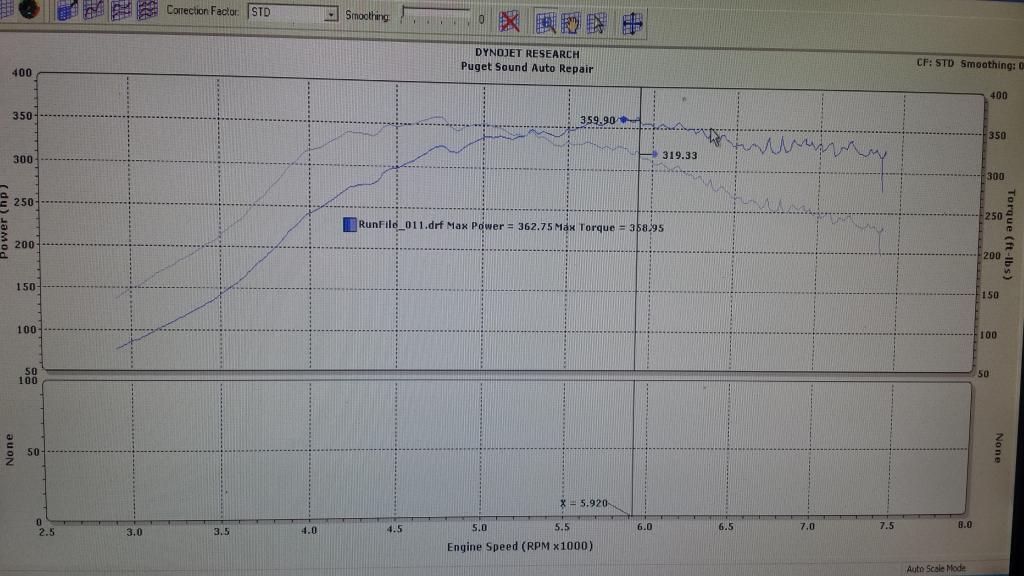

Hey guys! Just looking for opinions here if my results seem right to you guys.
Specs;
GTX2867R 3" Intake, Z32 MAF
Stock Mani w/ EWG 38mm, Cobb tuning IWG delete
740cc Inj.
Tomei Poncams 256/256
OEM Re-Ringed Piston Rings, Honed properly, clearances good (Piston to wall, piston ring gap, etc)
RS Enthalpy dyno tuned by Martin
RS Enthalpy Z32 Coilpacks, and modified ignitor/er
Apexi 1 piece 3" Exhaust
Cosworth HG, ARP Studs
Stock Intake Manifold
3" Intake piping, 2.75" Hotpipe
92 Octane
Results; 362whp/358 ft. lbs tq @ 20PSI
AFR 11.5-11.7
Dyno Sheet;
Dyno Video;
http://www.youtube.com/watch?v=mnI_dn0ruRQ
Tried removing exhaust to see if restriction was there, but same results, same goes with removing the suction filter.
Wanting to break 400whp, think 264/264 BC Cams & Ti Springs (of course), + Freddy Intake Mani will get me there?
Johannes is offline   Reply With Quote

That is what I normally see from the gtx2867, @19-20psi boost and running more boost is an option. The 260 cams are better suited for the engine and turbo on a street setup. I wouldn't recommend bc anything. Shifting the power to the right, does help a lot, but you still have room with your current cams.
If you do turn the boost up you can hit 400hp but that will be at the end of the power band and the torque would have probably dropped off significantly. Most gtx2867r users don't mind that.
Because they make a butt load of torque before 5krpm
92 Octane
AFR 11.5-11.7
Dyno Sheet;
Dyno Video;
HP looks pretty good. TQ drops off a lot though. Should extrude hone your stock intake.
98 240sx w/ S15 SR20DET, T2 20g, 11.22 @ 124.98

Originally Posted by cotbu View Post
If undesirable results are proof, then yes! But we're looking for that underdog that doesn't have to run 25-30psi to break 400whp��
Sent from my Highly Tune Galaxy S3.4!!!
I thought cody was able to hit 400whp with less than 20psi? I think the point of this turbo was all about hitting boost earlier, rather than the increase in power.
Originally Posted by unijabnx2000 View Post
You could make a intake for the money it costs to send off your stuff to be extrude honed.
But you lose low end.
fatduece is offline   Reply With Quote

In all honesty, you are right on track! assuming you gain 10hp for every psi of boost you would need to run approximately 24psi to make that 400hp.
This is the average!
Originally Posted by galant_x View Post
It has been done!
I got 413 WHP at 24 PSI :-D
post number 730 in this thread
If you have another dyno pull, we could get your exact hp to psi and make a better estimate.
Your hot pipe looks like its 3inches, that's the only odd thing i really see. maybe it's coated/wrapped or something.
The intake manifold will help some probably after 6500rpm, but you need tuning to extract more power at the same boost level.
#Don't be to disappointed.
