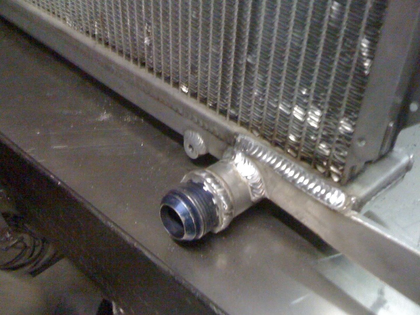

here we cut off the original filler neck and overflow connection and blocked it off, every thing will be done from the coolant expansion tank.
-16 AN on the upper radiator hose connection.
-16 AN on the motor side waterneck with a tap for the coolant expansion tank.

so got the motor back in, turbo and exhasut manifold and wastegates on. AN fittings on the oil return line. All turbo lines on, heat shielding on the lines, and reclocked the turbo.
left my camera at home so I apologize for the blurry cell phone pics.
using sway bar brackets to mount radiator in bushings to reduce vibrations.
