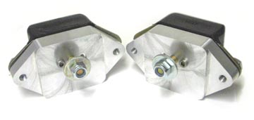

Using high quality polyurethane and our custom billet brackets, we have designed our own heavy duty MMs. This design will not seperate like stock type mounts but will provide less vibration than solid designs and is designed with the the stock offset for just like stock fitment. Also more economical than other mounts on the market. Only one small modification is required, the engine to MM bracket hole must be drilled out to 7/16" (11mm). This is very easy and can be done without removing the brackets.Pics of mounts installed 1 (pardon the dirt)Pics of mounts installed 2 (pardon the dirt)Install ID diagramTK218-S $119.99 USD a pair
So....Why are we contemplating mounts that dont involve an offset that nissan designed to effective hold the engine in place? Does anybody even understand why there is an offset on the mounting bolts? Why are we totally half assing things, I thought most of zilvia stereotype was about 240 owners cheaping out...however your spending an ammount of money already, only for them to end up in the trash bin because they arent the proper application.
In my opinion based on my observations Nissan designed their inline engine mounts offset because the engines do have a tendency to torque to one side. Therefore they put offset mounts in that lean the engine slightly to the opposite of its torque push. I could be wrong but this what I have observed and feel it to be a logical conclusion based on the observations of the actual torque of the engines and the fact that they indeed lean to the oposite side. Which most likely would be achieved between a combination of slightly different brackets on each side and offset mounts.
OH and Nissan is not the only Automotive company that does this BMW does it as well on their inline engine setups.
With that said indeed the mounts I sold were offset. Is it super critical? Well they design these things for passenger cars and some kind of longevity, as well as comfort i.e. less vibrations and whatnot.
We are basically putting or cars into a performance segment that usually throws comfort out the window in favor of better performance.
Given that, not having offset mounts is a world ending issue. You can run them and their will be no problems.
I see no problem with it at all.
Oh I should add, those mounts look very well designed and now that its been cleared up that they do not have a solid shaft or connected metal in them, they sound great.
He is talking about the bolts being offset. Not the engine being TQ angled.
Nissan angles their motors mainly for oil drain back. BMW angles their motors to the right for packaging. The Chrysler Slant-6 was angled to the right for the same reason. To the right would make tq shock worse by your math.
Most engines can flip themselves over. TQ angling does little to counter act that load. It's mostly done for packaging and a little for oil draining.
hmm interesting points S14DB never thought about it that way. I was talking about the reason for the bolts being offset though. Maybe I have drawn a wrong conclusion here.
If anything they move the engine to sit at an angle not inline with the chassis front to back. The stock drivers side the engine stud is behind the chassis stud and the passenger is in front of the chassis stud. Probably less than a degree but would create enough U joint rotation to be effective.
This is an old trick to remove drive line NHV. As things that are not inline can not develop sympathetic vibrations. Chrysler moves the engine 1.250 inches towards the passenger side. Ford and Chevy move the engine above or below the differential.
This makes complete sense. S14DB I think you have nailed it.
