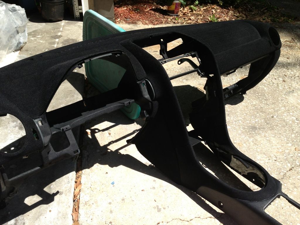

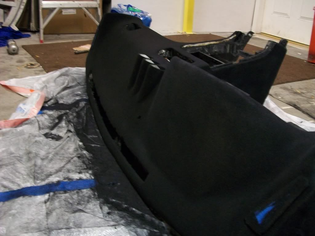

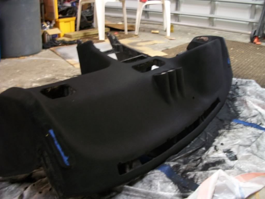

Took a while but finally got it flocked. Don't let this thread die, infinite potential.
Took 3/4 can of adhesive
2 3oz bags is enough to do the dash.

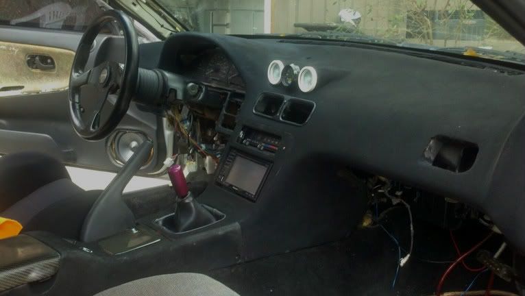

Camera phone pic.
All i had time to do before class sorry bros. The radio bezel needs to be re-done it was painted white and i guess the adhesive allows light transmission so it is slightly off color, even though it was completely black with adhesive.
Also going to flock another center console for better coverage.
Maybe throw my DCC in do a write up, going to try and rig up a blend door actuator.
Also excuse the wiring mess, need to bolt my distro block up under the dash.

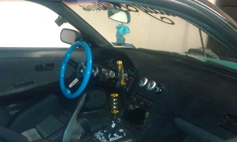

Heres mine. I do some fiberglass and flock it with the donjer kit. The open trap on the top is for pedalbox reservoir.
http://www.youtube.com/watch?v=7R-2uP-gWq4&feature=plcp

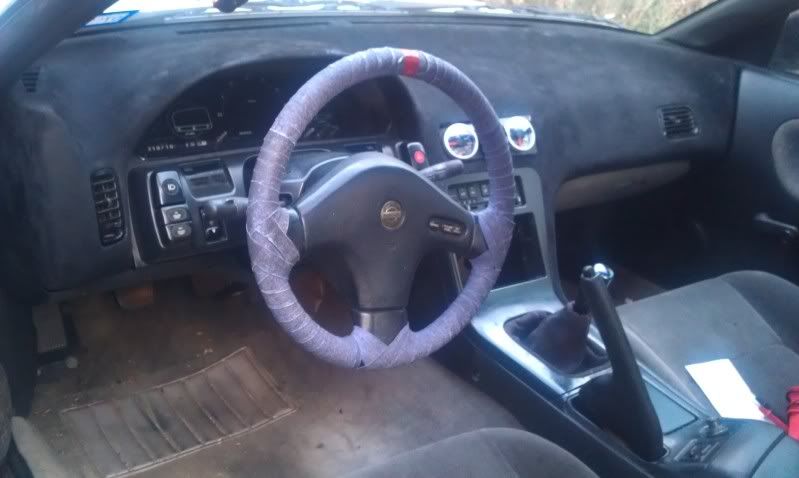

Update on mine
