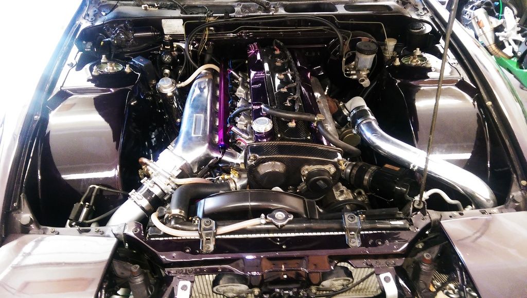

Majority of the tuck summed up. At least chassis harness wise. Need to clean up the engine harness next

Nice. That's clean.

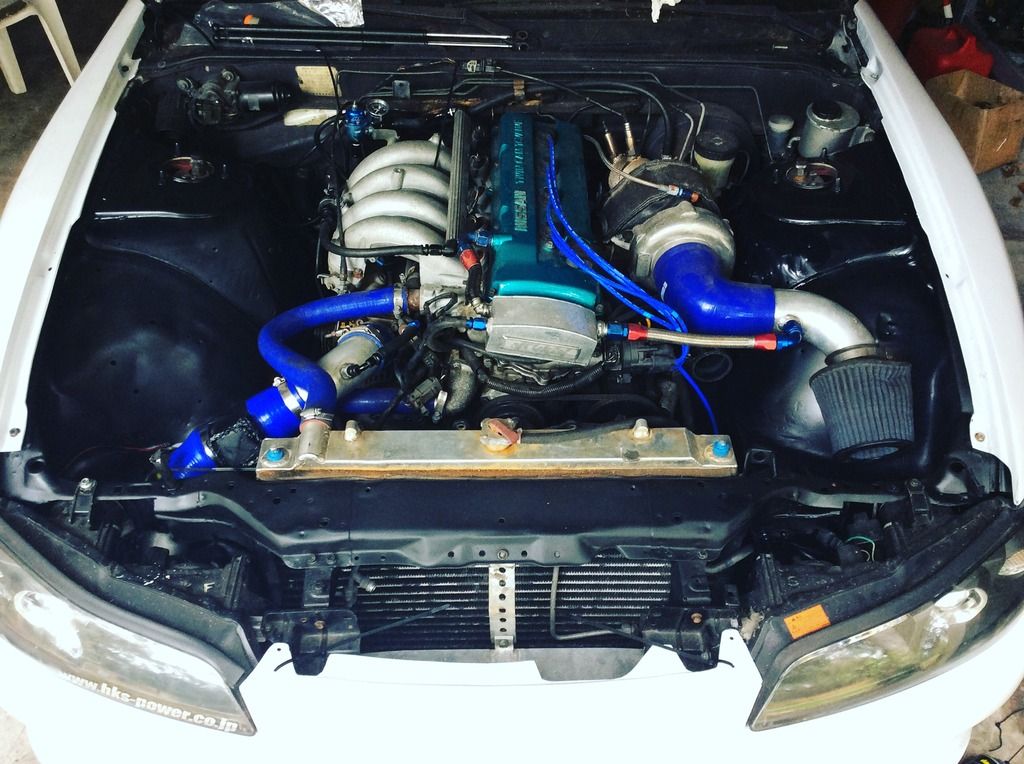

Almost done....

wow looks dope! more current photos?

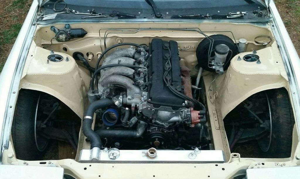

Most recent picture I have
