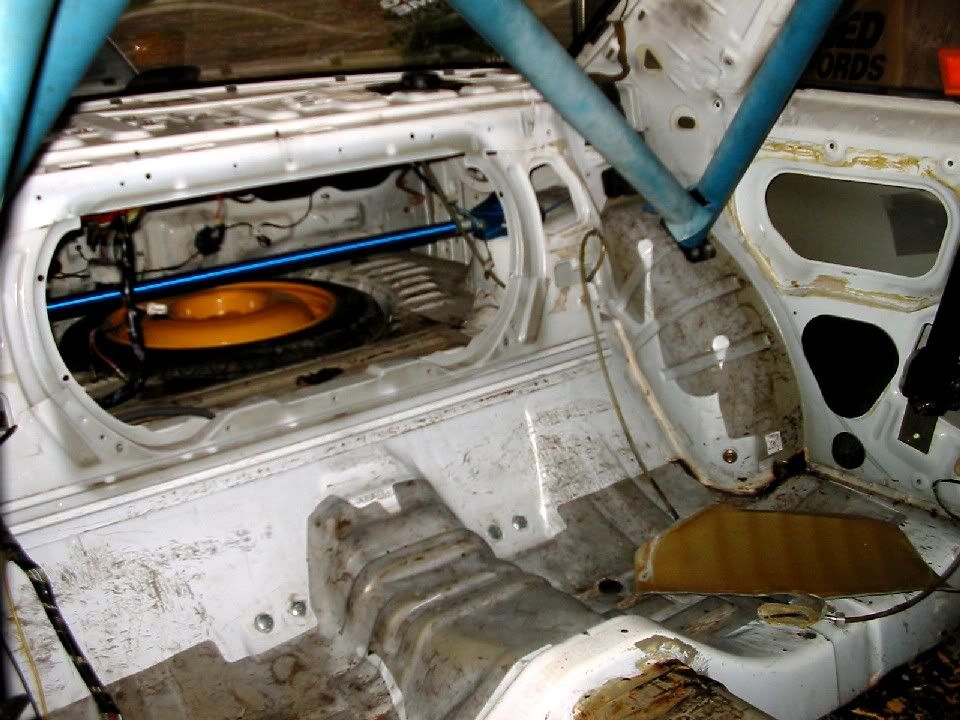

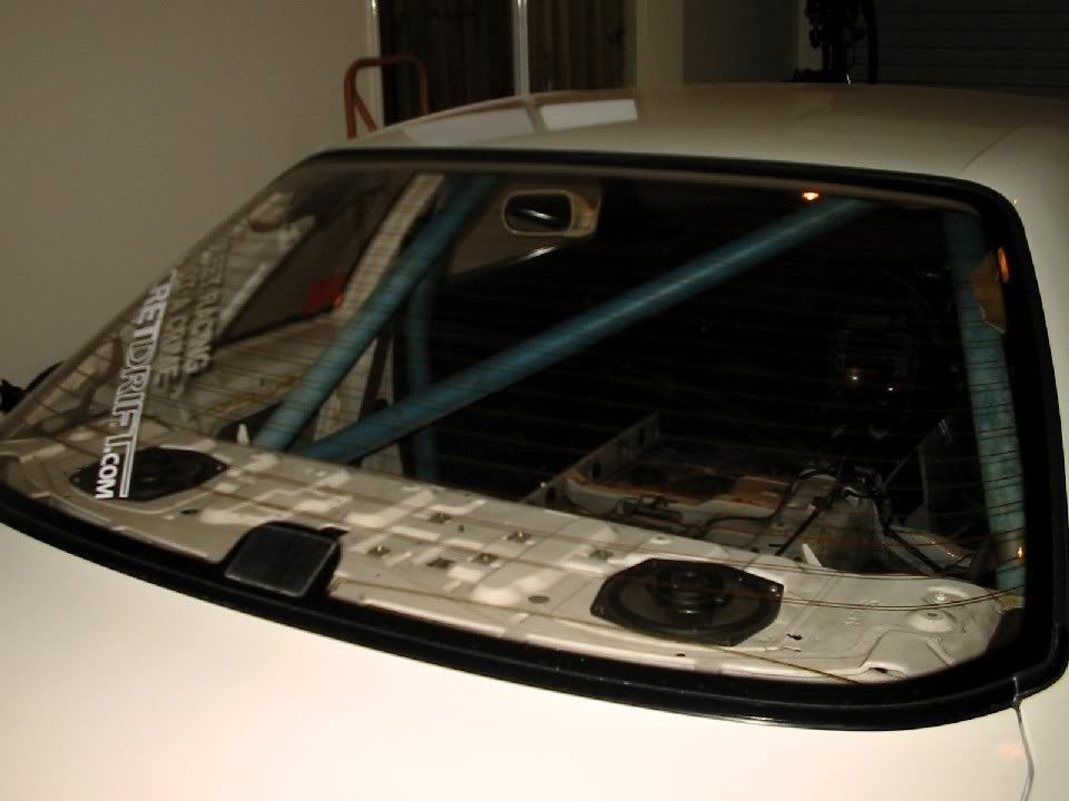

the part that makes the above cage good or bad....is the dash bar, door bars, and dash bar support, no main hoop diagonal, and no harness bar. I didntlook to intesnly at it, but those are the things that stand out hte most as not legal, or confusing.
on the plus side, it ties into the front struts, and fits very snugly everywhere else, and all the welds look good cleanand strong.
i will bring my cage through the fire wall to the front struts, use NASCAR door bars or an x-brace when i complete my cage next year, for now my 4pnt is sufficient.

I do not condone the cage above. With that said, it looks like the dash bar is solely there for more stiffening, many org. (including D1, FD etc) don't even require any dash bar at all. And that style of door bar is relatively common.

If properly connected I can see those door bars working just as well as an X...But I'm no engineer nor am I a cage builder

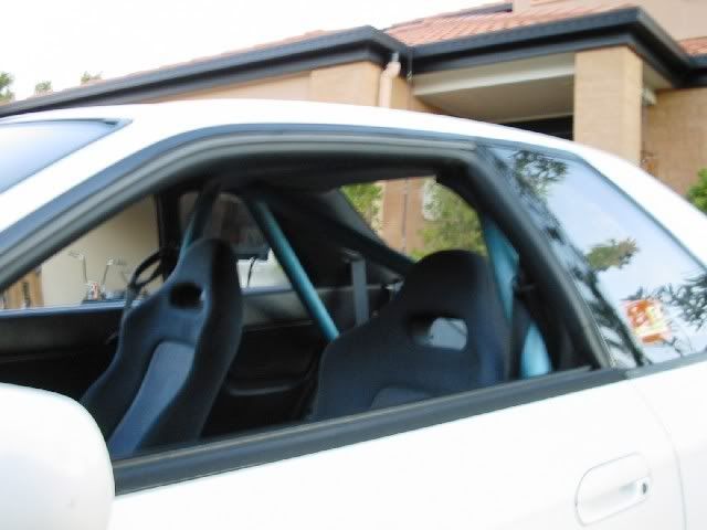

no its not padded, yes i know its dangerous, but its in the works, just gota order the pading.

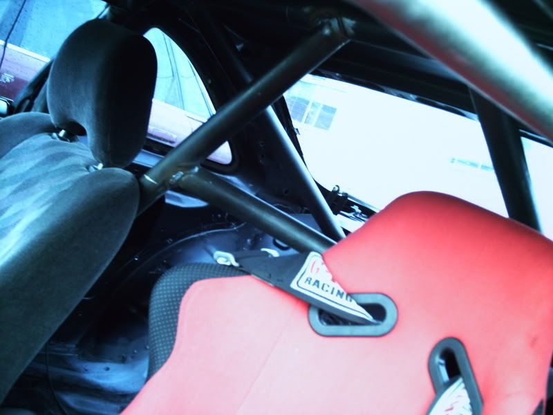

just my opinion, but that cage wont be very safe padded or not, the front down bars have too many bends, not going to do anything in any type of roll situation. No diagonal bar or harness bar on the main hoop either..yeesh. Good luck with it tho.

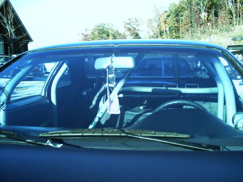

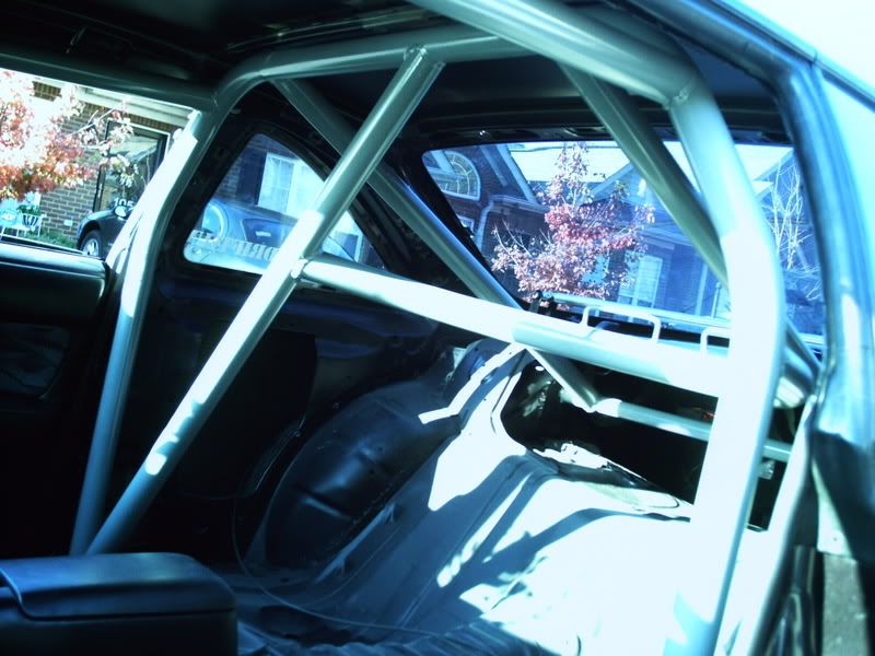

The Cusco and Safety 21 cages shown weren't designed to be "roll cages". They are a roll bar with the front A-pillar bars added more for stiffness than anything. I haven't seen a huge amount of drifting but with the high levels of lateral grip and the fact that you are already scrubbing off speed most of the time makes me wonder why they mandate more than a 4 point roll bar. It doesn't look like there are, or would be concern for any kind of major "off".
If anyone has seen a Pug 307 WRC, it is one of the most extensive cages ever built due to the fact that it started out as a convertable. I have a good amount of WRC and Group N cage photos somewhere. I will see if I can get them on my site.

Here are some photos of my Safety 21 half cage in my old R32. With out a doubt no-where near as flash or good as a custom weld in, but did the job for a daily driven 490rwhp streetcar.

is there any bolt in NHRA and SCCA legal cages. i would eventually get it welded. but it well be a start.

Originally Posted by Dousan_PG
AUTOPOWER
thas baout it
and those a pillar bars are a fucking joke
worst cage design ever
get the rear 4 point
make your own front section
the autopower ones are TERRIBLE
Thanks, I have never sceen the autopower front bars. The rear stuff looks good from what i have scene.
also anybody have a cage, and keep most of the interior?

Nothing special, but heres a shot of mine.
