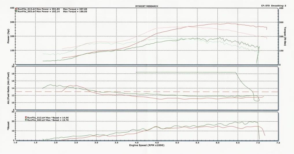

i just got back from the dyno dynamic's (heart break dyno) in ohio and made 338.00whp 19.1 psi on the garrett internal wastegate, if i'm guessing right thats around 400whp on a dynojet so i'm pretty happy with my GT2871r about now thanks everyone for your knowledge
What mods do you have? I'll be on 18psi and my tune will be on the same dyno.
Be sure to get to a track to get your trap speed, as we all know dyno racing isn't an exact science. 340 whp at 19 psi def is fast car on a DD setup!
that all depends on the driver the 60ft time and the amount of spinning these light asses do lol.
I've seen 330whp s14s run borderline 10/11s and 370+Whp s14s run 12s but trapping 11second soeeds.

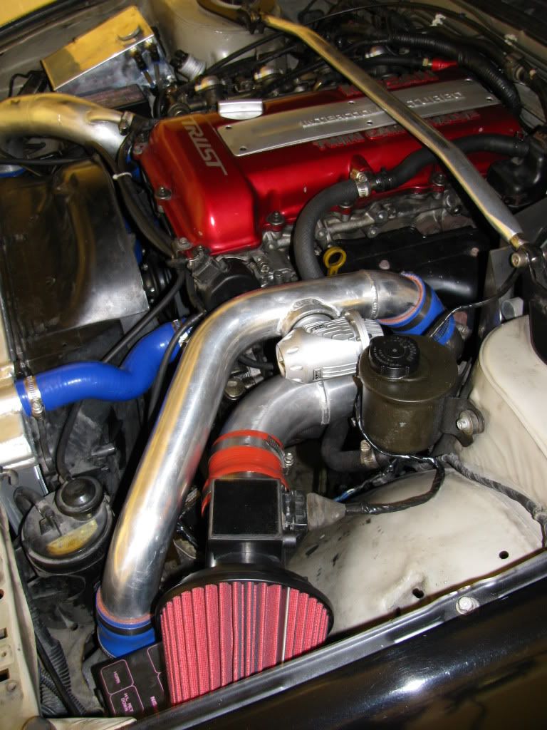

numbers my set up made at 15psi on 91oct
Standard Block, standard Head.... Cosworth 1.5mm HG, ARP Head Studs, GT2871R .64, Z32 MAF, 740cc injectors, walbro 255, and a Nistune ECU Tuned By Seb at Specialty Z.

Nice^^^. Been looking somebody running stock internals with a GT2871. Looking to do something similar and get 300hp.
