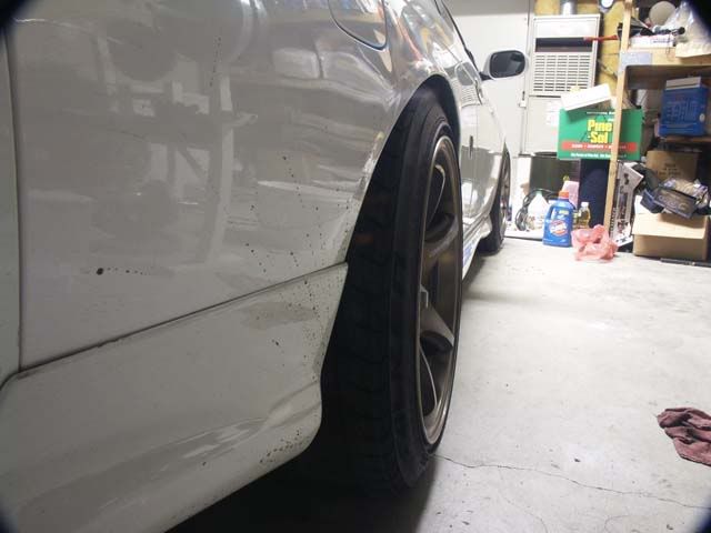

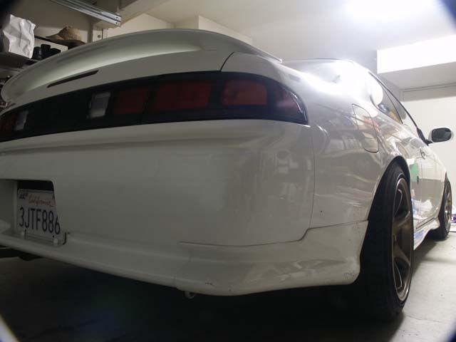

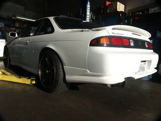

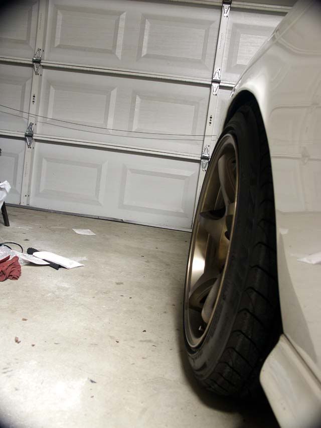

Before
After
Gab&Eibach Vs. Megan Racing
About an inch lower, I'll lower it more later.. Took about an hour to install..and yeah the holes were off..

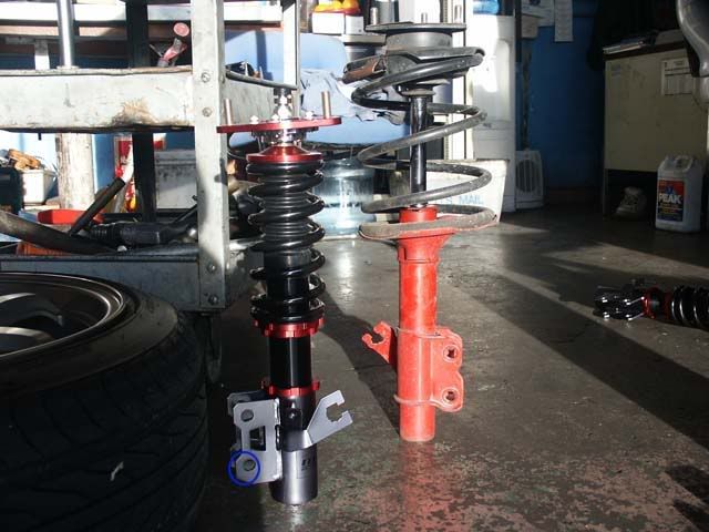

I really suck at writeups, but I'll try.
Installing defective Megan Racing Coilovers 101:
The defective front coilovers have one misaligned hole, for me it happened to be the bottem of the two knuckle holes. At first, I thought you had to make the holes bigger, which was half right. When you take the knuckle bolt with the coilovers off, it wont go in. So what you'd have to do is take the bolt, slide it in the hole and move it around to break off the paint which makes the hole a tad bit smaller so the bolt wont slide in. Once tha'ts complete the paint breaks off and you're able to slide the bolt through the hole. Now the bolt well go all the way through once you've done this on both coilovers. So I figured that was the only dumb thing that went wrong.. And why did Jeff240sx make such a fuss about this stuff? Well, as I was installing the front C/Os it turned out to be more than just paint blocking the bolt from going in. I installed the top bolt first(after installing the three on the pillow mounts) and couldn't get the second bolt in at a straight angle. So I had to notch the bottem of the hole. All you need is a round file and 10 minutes per side(depends how fast you go). Once you have that done, the bolt should go in freely. But since the coilover is shorter, it's pretty difficult to raise the spindle to the coilover. So I had to place a jack under the Lower Control Arm(LCA) with a piece of wood on top to lift up the knuckl assemly. Top bolt went in flawlessly, second bolt needed to be worked alil bit, make sure you push/pull the knuckle assembly to get the holes aligned. You can tap the bolt in or turn it clockwise so it threads itself in. There you have it, coilovers installed nicely upfront.
Rear install is pretty tricky if you do i yourself, ifyou have two people.. it's CAKE.
First, you put down the rear seats. Second, the speaker cover pulls upward(just tug it), and the clips will release. There are two 12mm bolts holding the shock assembly. You will need a 12mmDEEP socket, and a 3" extension, nothing larger, which will give you just enough room so you don't bang on the window. Once you have the 2 bolts on each side removed, you can go under the car and remove a 17mm bolt holding the shock up. Once that is off, you can pull the shock off with force or you can tap it gently with a mallet(pulling the shock off with force can cause you to hit your head or loose your balance, so I suggest a mallet). Now that the shock is off you should be able to manuever it so that the top part of the shock assembly comes out of the upper fender well.
Here is the tricky part. If you're by yourself.. You place the pillow mount in the shock tower, and you let the bottem of the shock sit on the knuckle.. carefully climb in the car, and gently install the bolts wich attaches the pillow mount on the shock tower. If you have two people, you can just have the other person hold the C/O while you tighten the bolts on the inside. Do that on both sides, reinstall the 17mm bolt on the bottem(the washer faces outward like "(" ). You just need some muscel to lift up the rear brake assembly which isn't too hard..cause I did it myself.. 6'1 150lbs..yeah I'm a twig.
So there you have it. I left the height the way they it was, since I don't have any spanner wrenches(must have fell out of the box during shpment, cause it was beatup) to fine tune the system. Ride is a bit bumpier, handles well, braking has improved due to stiffer springs which I noticed immediately.
Just some notes.
Spring rate are 8kg/6kg and 56 is what you multiply the numbers by to get pounds. 448/336. 448lbs is what it takes for the FRONT springs to be compressed ONE inch. 336lbs is what it takes the REAR springs to compress ONE inch. They're also a LINEAR type spring, which means that they compress evenly with weight..meaning for every 1x force it goes down 1". PROGRESSIVE springs like my eibach rear(maybe front to, but they don't seem like it), the spring compresses at a different rate.. something like every 1xforce it compreses 1", then 2xforce, it compreses 1.5".. not exact but that's the concept.
There you have it.
I e-mailed MR about the spanner prolbem, they said they'll send me some as soon as they get some.
EDIT:
This is where you would drill, but on the other side(for me at least)

Smog Tech that was a great write up. Yeah the fix for the defective coilovers was really easy. I got a grinding bit from Home Depot for my impact gun. It only took around 2-3 minutes to do both holes. Very easy. I'm very happy with my purchase.
Chris I will try to post up pics after I get a chance to wash my car. Its all gloomy and rainy where I'm at. After looking at Smog Tech's pics of his car, it makes me not want to post pics of my ugly car. But oh well.
