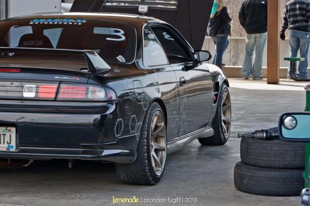

How would I go about making the fitment in front more aggressive. Without having to worry about my tires fcking up my fenders. I do not want to pull them either. Example
This is my fitment up front with about a finger width in between tire and fender. 17x10+3 ~-4 degrees camber. When at full lock my fender sits right on top of my tire. Would more aggressive offset and camber help eliminate this?
These three sentences cannot coexist in this world for your car. Unless you like staring at a parked car.
An aggressive offset at that width will only push your wheels toward your fender more especially if you only run about -4* of camber which is definitely not what you want. You need more camber to even be close to the cars you posted.
I know you're opposed to pulling your fenders but if you stare at the pictures, they modded their fenders to accommodate for the tires. What I'm trying to say is if you want to be anywhere close to the first you posted, you need to follow the leader and do it the same way. You can mickey mouse your car and fuck your fenders like everybody else or you can do it the right way.
Car A and car B are slightly different fitments, btw. I think the 14 is slightly less aggressive. It looks like it's got a bit more neg camber which would make the top more sunk in but would alleviate some rubbing issues.
Thanks for the detailed answer. I didn't know how to word this question. So thanks for bearing with me.
As you see my fender sits right on top of my tire at full lock. Mind you this is 17x10+7 with -4 camber.
My question is, how do I eliminate this happening when i make it more aggressive?My fenders are rolled.
I realize that ^^ he has his fenders pulled in the front to accommodate the wider wheels. But that still brings up the question. How does he drive and not bounce his tire up into his fender while turning.
Is it more camber? Is it caster?

^was that second car in your initial post yours? Lol, my bad.
Anyway, adjusting caster can help alleviate your fitment woes but it's not worth touching for the sole purpose of wheel fitment. Camber and toe adjustments is about the only things worth correcting and after that, you may want to downsize or modify something else. Set your caster to what is functional not to where it helps your wheel fitment.
Putting in a bit more neg camber will slightly help by bringing the top part of the wheel inwards but if your car is at the same height, something will still rub. There's rubbing issues at that ride height not with your alignment. Does that make sense? You either raise it a bit or hammer in what rubs.
Modding your fenders will be the only way that you can go about turning and giving the tires a bit of clearance. If you stare at the fenders, they have a slight hump where the tires can have a bit of clearance.
