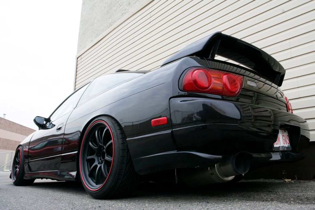

car's awesome. your style's always been one of my favorites, buttt...
that rear sidemarker's killin me. is this a whole new car or is this the red one repainted?
i'm also a sucker for white TE's, but i'm glad you built YOUR car

And yes, this is the red car, and yes, the rear sidemarkers are horrible, damn us DOT.

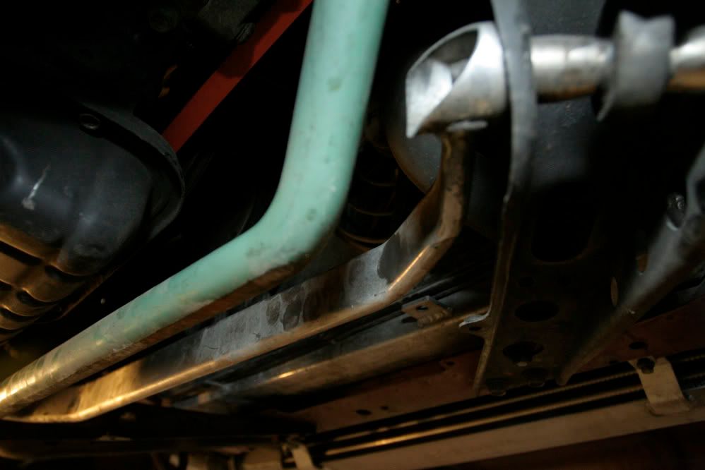

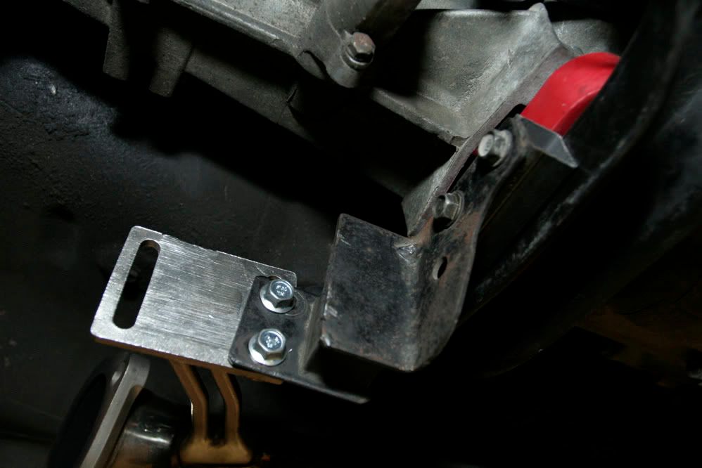

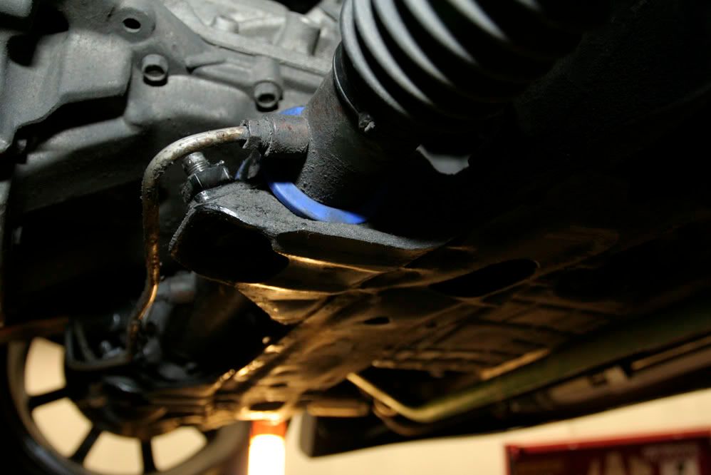

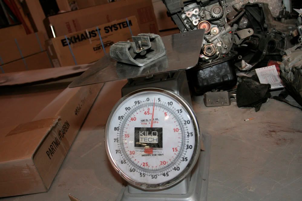

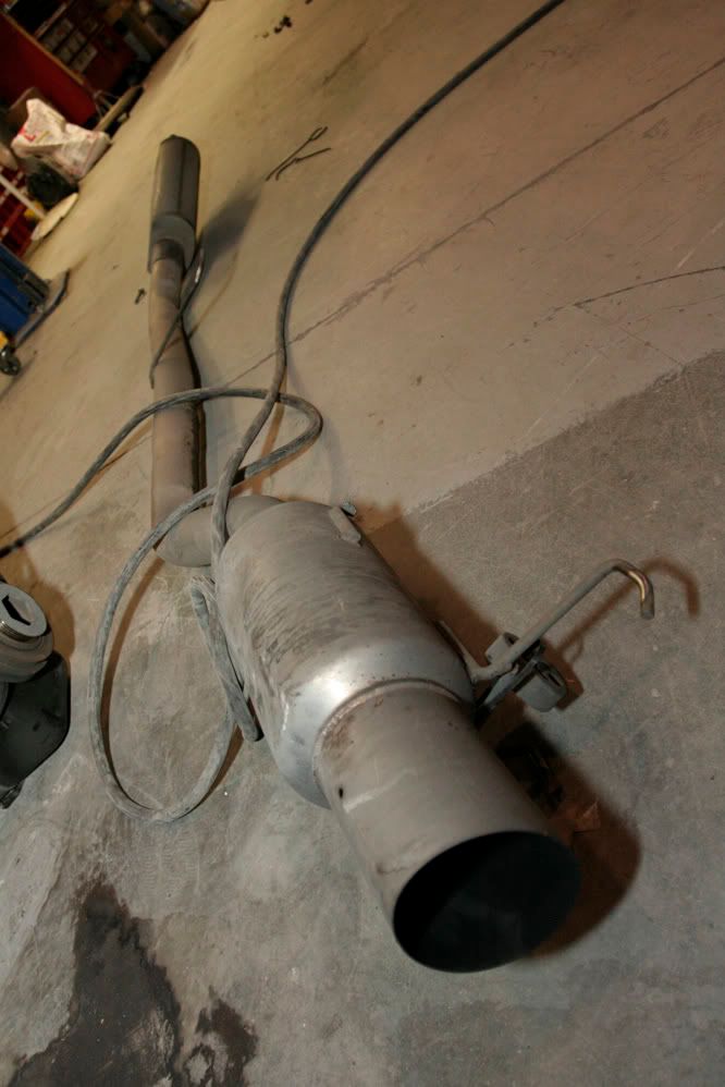

Stupid exhuast hasnt come in, but iv had some problems with the exhuast draggin a lot so I swapped out the exhuast hanger bushing and put in some other things too.
The pile of poo, cant wait to throw it.

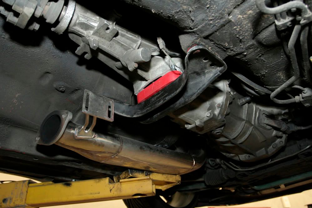

Installing the Peak Street trans mount, I need to make something for the down pipe bracket.
I came up with this...
Stock mount is heavy, glad its gone now.

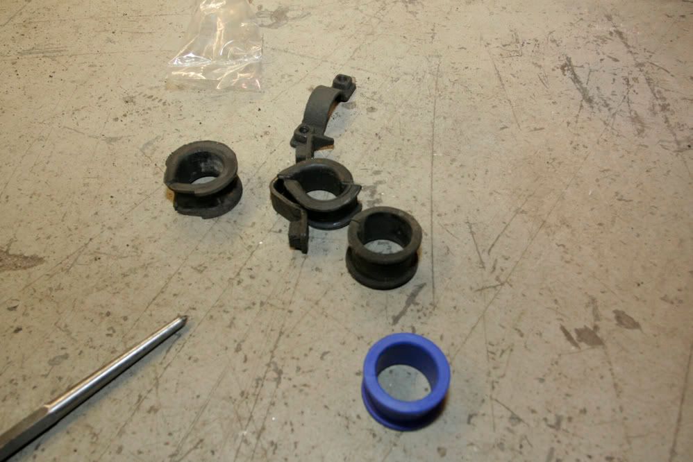

Next up steering rack bushings. (epic fail megan)
Easy install 4 bolts took about 10 mins.
Dont mind the nasty grease and other poop on my chasis, its a daily driver.
This brace is a piece of shit, it doesnt work you can bend the mounting brackets with your fingres. (its a project nissan piece)
Ordering in a Nismo power brace.
All back together, its a little higher and should last me through the weekend till the exhuast comes in...

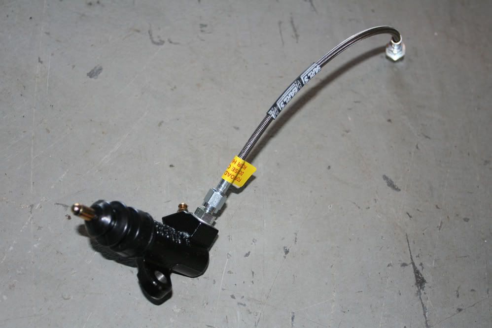

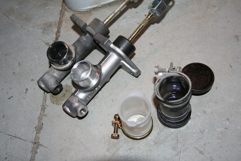

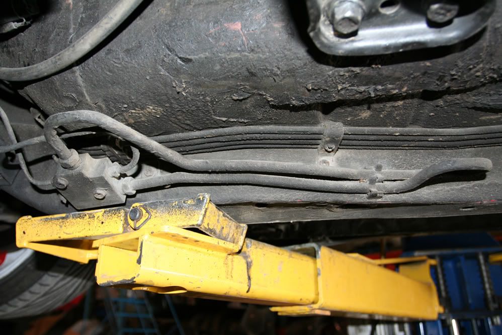

clutch was starting to act up, iv been neglecting it of a bleed.
Oh shit! is that black paste my hydrolic fluid? ahah
In the process I removed the damper, its very large on the 91-94 chasis.

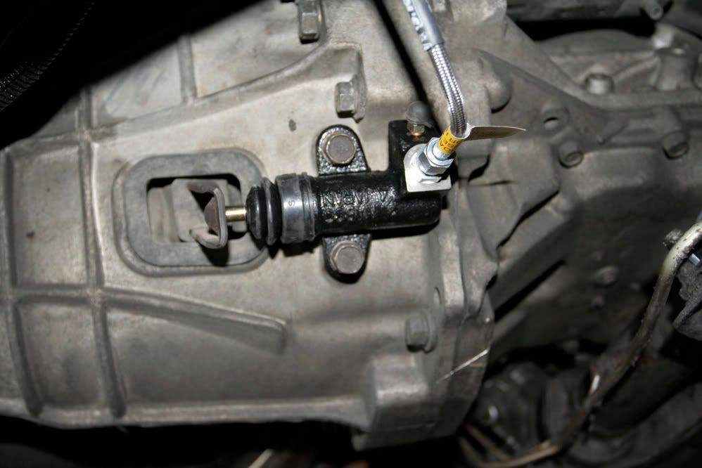

Yes Weight savings
This $20 Stainless line and fittings replaces the damper.
OEM Slave and Master installed

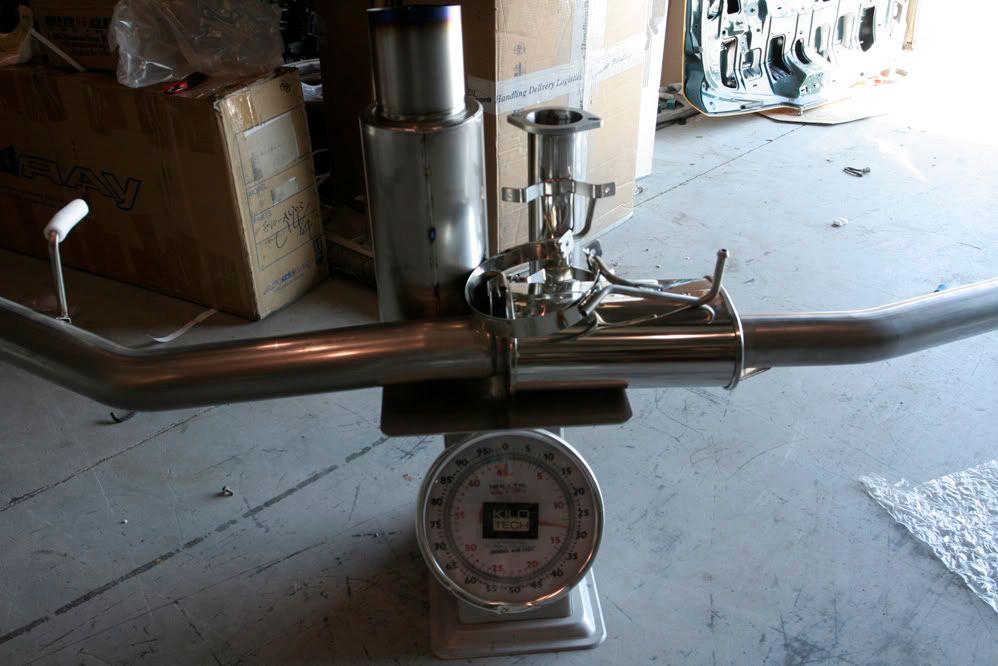

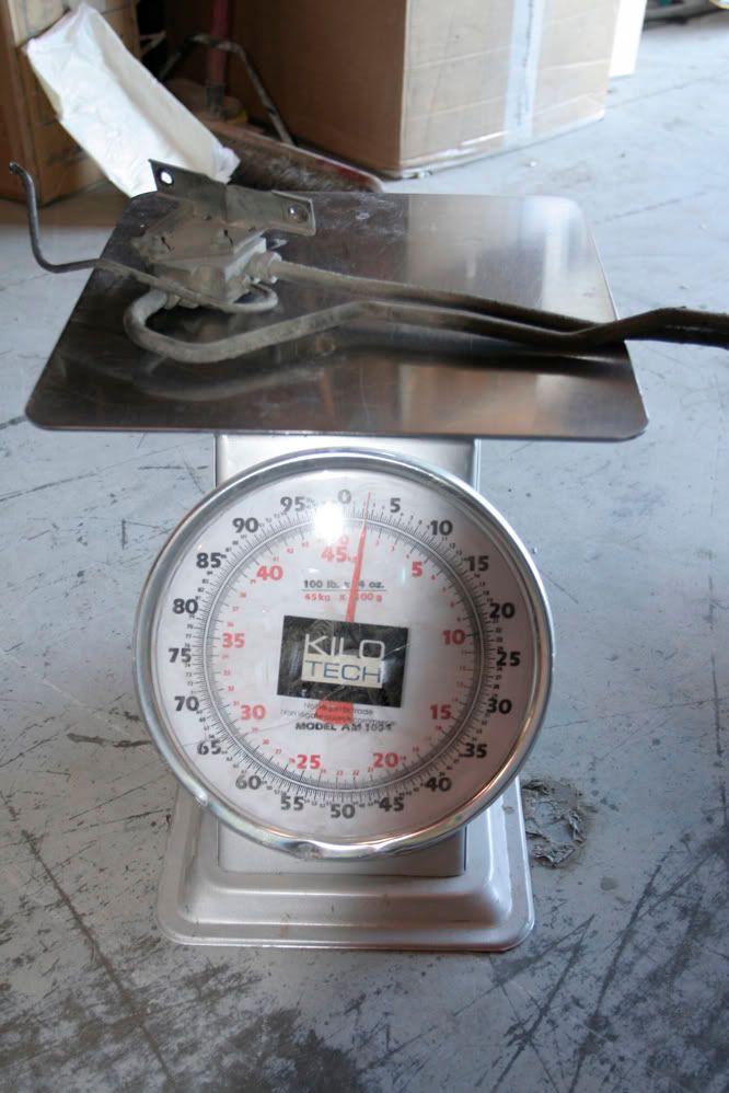

I cant remember what it read, but thats about 28lbs including test pipe.
My original system weighed in at 36lbs, so I saved a little weight but not much. The Titanium canister isnt all that light.

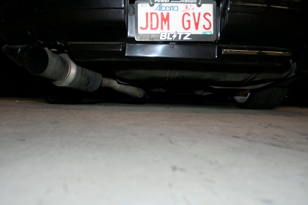

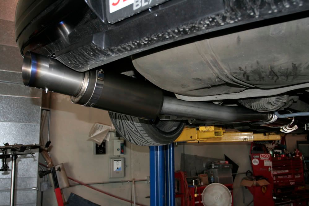

The clearance with the Apexi exti.
It sucks it scrapes every where, so much that i had to raise the backend up. The canon has way less clearance than the blitz.

be careful man.
usually the full titanium exhausts are thin as F. !!!
It would be as hame to wear through it so fast
