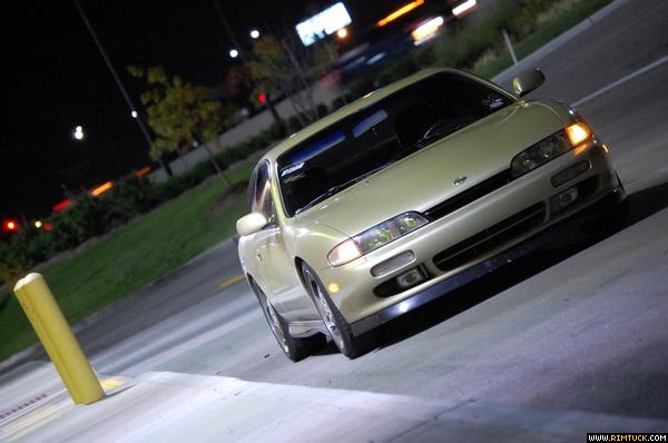

From the pic that zoom posted:
That 17x8 +30
did the math with +0 and doesn't look like the above pic in any way... so that's why I am trying to figure out with 15s if it will work (since it's 2" smaller)

correct 225/50/15x8 +0 I just don't want to have to pull or roll the fenders. it's stock height >>at the moment<<
That 17x8 +30
What are you so worried about then?

stock with 15x8's 195/50/15 how to make this look more flush?Attachment 29782

Caliper clearance is dependent on spoke/disc design so you would have to see if the wheels that you plan on purchasing will be able to fit them in there.
As for your tire questions: http://zilvia.net/f/chat/166563-maxi...nt-thread.html --that's where you want to be searching.
0 offset & +15 will not clear coilovers so you would need to have spacers. And with that aggressive size, you will need tubs for the fronts, a roll, and a pull (or overfenders)
