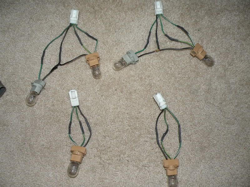

Well a while ago (and once again lately) there were a bunch of threads poping up asking for how to wire up the Kouki tail lights so i made a dummy guide.
Very Simple any ra-tard can wire this up becuase ALL THE WIRE COLORS ARE THE SAME.

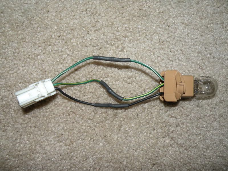

Very simple clip the OEM (Zenki-Chuki) wire harness plug off the stock taillights cut the Kouki harness plug off the sockets and match the wires.
Thats it....
Brown Sockets are Brake/Parking Lights
Gray Sockets are Blinkers
Outer Brake/Parking and Turn Signal
Inner Brake/Parking

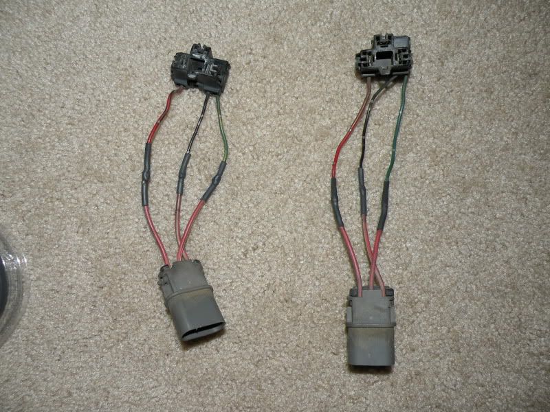

As a bouns heres the Silvia Q's (Dual Projector) wire up
all ya gotta do is cut the the OEM pop up light harness and splice it into the Silvia haress .
I cant remember what the whole Silvia H/L harness looked like I think mine was cut when i got them. So if yours is cut heres how you wire it up
Done
