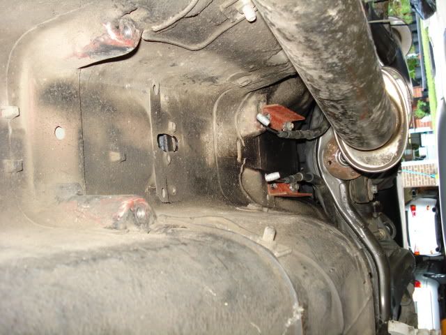

for e-brake...2+2 cables (you will have to make a simple bracket to mount cables..i can post pics of mine if you need)....backing plate and all hardware..rotor and caliper. alll will bolt up to stock s-13 upright.

this is from the front looking back, all it is, is angle 1"x1" that will move mounting hole back.
for the front i used s14 knuckle, s-14 hub and s-14 front lower control arm.
