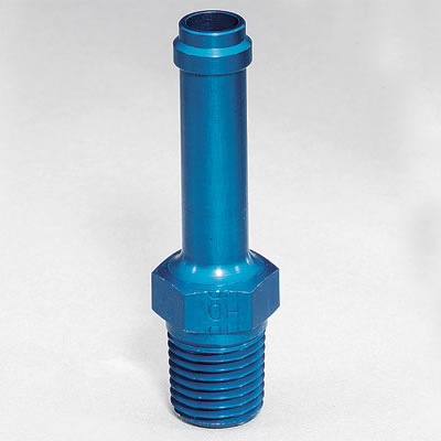

Found the NPT fitting for the adaptor: (1/8NPT to 1/4 inch hose)
http://store.summitracing.com/partde...5&autoview=sku

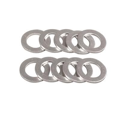

Here are the aluminum crush washers to keep it air tight:
