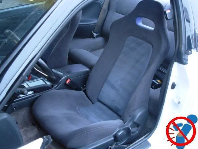

hehehe... i remembered when i had the same problem...
youre going to have to drill a hole to drop that buckle part lower... i used my s13 buckle which worked fine...
as far as the mounting tabs... this is what is did:
found various parts and brackets at work... and made this in 3 minutes... the rest of the mounting points line up just fine...
that bolt/bracket is pretty safe... i drifted on those all day and it held fine...
ignore that little icon of a guy w/ an aching back... i had it up there to show that these seats helped my aching back... =)
btw these are r33 gt-r seats but i'm pretty sure they are the same...
