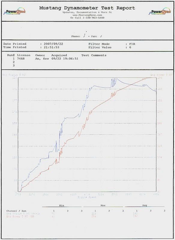

Alright, finally got it semi-tuned and ready to go. First taste of more boost.
Originally had some issues with the spark plugs not being cold enough, so the first run we did it misfired and hit 234rwhp.
Then we changed the spark plugs to colder ones, and added some timing. Next run made 251rwhp. Misfiring was still there a bit. Plugs warmed up a bit, next run made 254rwhp.
Best run all day was 258rwhp/238lbs torque. at 14.5psi on their mustang dyno. However there was still alittle misfiring uptop, but the A/FR's were in the mid to high 11's at WOT.
We went to the street to see how it was, sure enough it was misfiring again, quite a bit actually. We tested coil voltage, good 13.5V, swapped coil packs, and finally we adjusted the tach signal from within the megasquirt control unit, and that did the trick, it ran better then ever.
In the dyno graph the tach signal is weird, so that might have been the cause of the problems. I believe that it would have done much better if it had another chance on the dyno. Maybe 260rwhp - 265rwhp. On a dynojet, it'll be around 300-310rwhp I'm guessing.
I think the dyno its pretty accurate but the numbers might read lower then other mustangs. In comparison Stock SR 740CC, AEM, IM, 8.5-1 CR, same turbo/AR at 18psi made 255rwhp on race gas... only thing I had he didn't have was CAMS !
Quite happy with the car, future upgrades will include water injection, larger injectors and a bit higher on the boost.
Try to keep it as safe as possible on the stock bottom end.
Heres the dynosheet for the 254rwhp run, couldn't find the 258rwhp run, thanks for reading everyone! Its very faint, i'm sorry I don't have photoshop

Looks like you have some pretty serious ignition problems from the look of that graph. Are you getting timing errors in the megasquirt?

The spiking graph is the result of a bad tach signal.

Are you sure? Usually a bad tach signal to a dyno makes straight left to right breakups, while some of your breaks are up and down, representing power not rotation over time.
Does the car feel spotty in power delivery or "surging"?

I am very confident in my tuner's abilities especially with the many hurdles, his had to figure out with this megasquirt/SR combo. I'll double check with him.
When I first saw the graph I was like wtf? He reconfig'd the dyno to read a different ohm/volt ? He had to reconfig the dyno itself to give the graph in its current form and says the spikes are the result of a bad tach signal.
On the original format the lines would go ALL the way up and all the way across the whole graph, it looked like a scribble.
The power feels very smooth throughout the powerband, on the first pull after the startup of the car, I felt a VERY minor blip uptop, but every pull after there was no signs of misfiring. I've been told that the plugs need a bit of time to 'warm' up. Insight?

THATS IT, the temp correction, we were playing with that for a while and after some fiddling we got the graph you see. Its not perfect, but they ran with it.
It'll go back on the dyno next spring, and we'll sort it out. Hopefully w/ meth kit and 20psi
