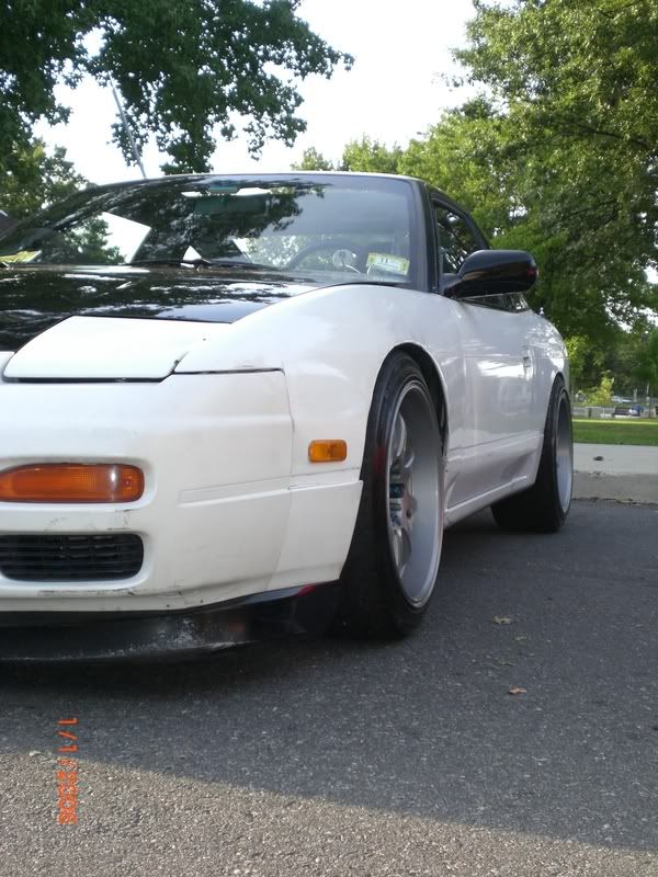

at full lock to the left my drivers side wheel is rubbing against harness boot and part of the wheel well. i have 17x9 w/ 215 45's on my front wheels. i was thinking about just taking a hammer to it but i wanted to see what other people did 1st.
here's a pic of how it looks.
how low i'm at in the front

okay got it caster and hammer. just wanted to make sure i was gonna do the right thing.

I made a small steel bracket to hold mine out of the way, works great and only took about 10 minutes.
