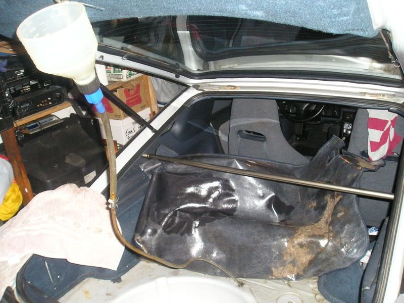

This is the way we fill our diff, fill our diff, fill our diff

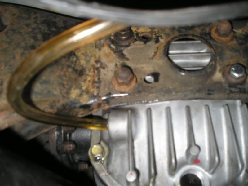

It's just much easier this way, don't even need to lift the car. Great if you beat on the car.
Just a small hole I cap off with a rubber square cap from Home Depot. The ones that go on the bottom of tables and chairs.
