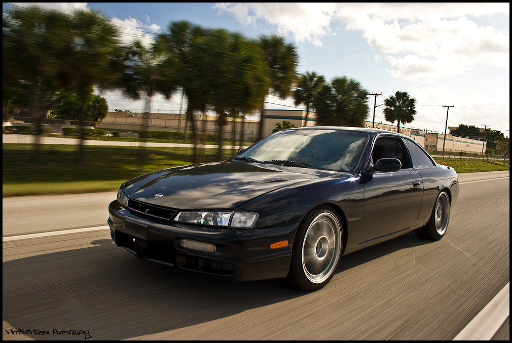

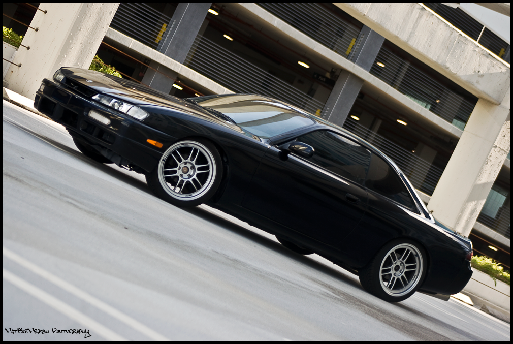

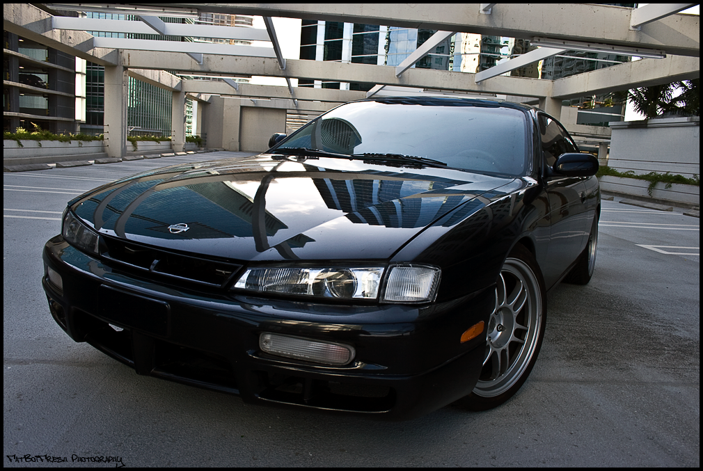

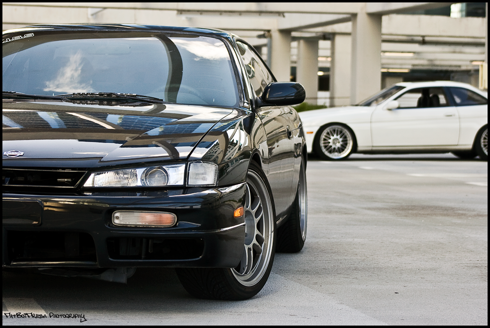

Hey guys, I wanna lower my S14 alot lower then what it already is. My problem is my tire rubs with the wiring harness and it already ate the plastic so I was forced to raise the car up. I dont have the splash guards on it yet. Tire size are 225/40 on 18x8.5 +40 and 235/40 9.5 +38 What do you guys do to be so slow and not eat at your wiring harness. Thank you. Ive always had low cars and now I feel weird having this one so high. Thanks once again.
My old coupe:
Here's some pics of how my car sits.
