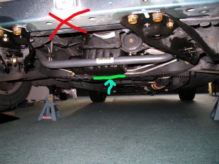

I have a low pro jack. While I can clear the core support to get it to the front cross-member. I can't pump the lever more than an inch without it hitting the bumper.
If I can't drive/push the car onto the ramps. I jack one side up and put the mini ramp under the wheel. then repeat on the other side. Then I have enough room to jack up the car from the cross-member.
Old 09-24-2008, 12:25 PM   #10
GSXRJJordan
GSXRJJordan's Avatar
Location: San Diego, CA
Posts: 9,135
Seriously... real men have intercoolers and aero, so you can't lift from the crossmember.

Originally Posted by codyace View Post
I wouldn't lift ANY car from the front rad support. Half of them are all rusted to shit and fucked up anyway
Note that he said CROSSMEMBER not Rad support. Where the engine and LCA's bolt to. It's a hard point to jack from in the FSM.
Also, he was quoting me where I said my jack cleared the rad support to get to the cross-member. The problem with most jacks is not the shoe getting under the cross-member but the pivot box being to high and hitting the rad support or the bumper.

Originally Posted by twistedsymphony View Post
Similarly if you're crazy enough to jack the front from the cross member that would work but I personally don't feel safe jacking from there.
Why not? Its not like the crossmember doesn't support the engine or anything
Apparently someone doesn't know shit about his own car. But hey, it's not like that's a new thing here, confusing one part for a completely different and unrelated one. Crossmember, core support, steering wheel, radio, they're all the same thing really.

Old 09-24-2008, 06:37 PM   #26
S14DB
AFC #1
S14DB's Avatar
Join Date: Oct 2003
Location: 昨晩あなたのお母さんの家
Posts: 20,181
I swear people get the core suport and cross-member confused.
Red X = Core Support, Don't jack here.
Green Line behind the oil pan = Cross-Member, jack here.
Dude, people get the engine and transmission confused on here. Shit.

The best money can buy, 2.5" minimum height, extra long reach, 2ton capacity. You can skimp and buy a shit ass Torin jack from Northern, Harbor Freight, or Costco but you'll be replacing it within a year or tracking down parts to replace the lost rollers, handle, etc. Craftsman makes a good one but it's not long enough for a good reach to the crossmember or diff. The Omega one above is THE jack for a lowered car. Buy right or buy twice. Add a pair of low profile plastic ramps from Ebay ($49) and you're set to raise anything.
That's whats up. Just to clarify with you so im sure though, how low is your car? Like I said the one I have now has no problem going under the car its just the lever doesnt have enough space to move up. I would hate to get this thing and still not be able to jack up.
Crappy pic
Thanks guys
Crappy pic
Thanks guys
Shit, you're fine. I'm way lower than that, and have a lip. The main thing is the long reach this jack offers, the handle has plenty of room to move.
Crappy pic
Thanks guys
lol. u have plenty of room. the HF one thats <100 bucks will work fine for u. its 3" saddle height
