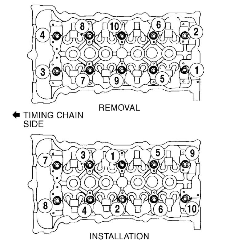

Hi everyone so I'm doing a head gasket job on my ka and I'm having trouble putting the cams back into place. All the things that I've read just say that it'll just go right back into place but this is t working for me. I've only tried putting in the exhaust cam in but my problem is that it won't sit right because the middle two lobes hit the shims. I'm pretty sure I don't have the cams mixed up and the motor was at tdc when I took it apart. It's normal for all the valves to be closed at tdc right? I'm just wondering if there is a tool I need to compress the valves so that the cam lobes will clear them? The motor is in the car already if that matters. This is my only car and I need to deal with this asap really hoping that I'm just not trying hard enough, any help is appreciated. The picture is of how the lifters are sitting in the car right now, is this normal?
https://s22.postimg.org/ad3vpcak1/IMG_5380.jpg

With no camshaft in place, all the valves should be fullly closed due to spring pressure. When you try to install the cam, some lobes will be pressing on the buckets, in turn pushing down on the spring and opening the valve. No.1 should be at TDC which would mean all valves for that cylinder are closed.

If the crank is as TDC, install the cams with their gear markings in approximately the right position, then start bolting down the caps. You might need an extra set of hands to press the cam down on the lifter while getting the caps started. Then just tighten the caps down as per the FSM. Which I'm sure explains all of this anyway.
EDIT: Should also mention: make sure the cap bolts are threaded in sufficiently before trying to use them to completely seat the cam on the lifters. Without enough thread engagement, you could strip the threads in the head which would be a major headache.

Tighten them down slowly in steps as per the FSM.

follow the damn FSM, otherwise, you're BEGGING to snap a camshaft.

He's more referring to the illogical part where you tighten front to back instead of working from the middle outward in both directions applying force evenly across the width of the cam

As for tools, you can just use a 1/4" drive short ratchet and a normal 10mm socket, you will tighten them to snug and then a little past it. They will not all go in evenly, you will be tightening them snug then move on to next bolt in the order, as you tighten them the lobes on the cam will be pushing the valves open, this will give some resistance and once you feel it it's time to stop and move to the next bolt.

Weird, I've seen instructions that say to tighten from the chain end first since that end of the cam the lobes aren't pushing on the valves. And then slowly work back and forth along the cam length until it's all the way down. Could be wrong though.

It's easier to do it that way if the chain is on the cam...the correct tway is center out...even pressure as its tightened down...

I don't know about the KA, but the SR20 instructions say something like this for sure. The bolts close to the front of the engine get the first torque. And then it goes back to middle-out I think.
you have to read the whole thing, the picture alone might not tell the whole story.

This would be relatively true if you were installing the cams with the gears already installed but when you're building from scratch you start with bare cams then install the gears.
Regardless of the engine, you always torque camshafts from the inside out. The only time you'd skip around or deviate from that order is when you're snugging the cam down due to the valves opening. Basically you tighten 1 cam cap at a time till it starts to build resistance then move to the next in order and repeat. As per final torquing inside to out side is how it's done. Same as a head or crankshaft.
