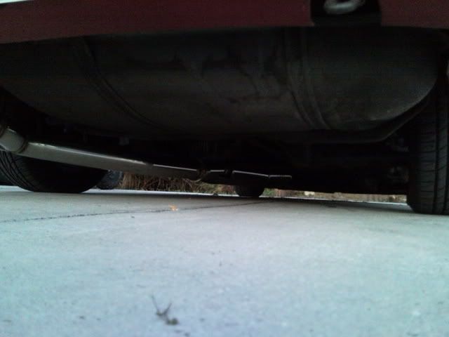

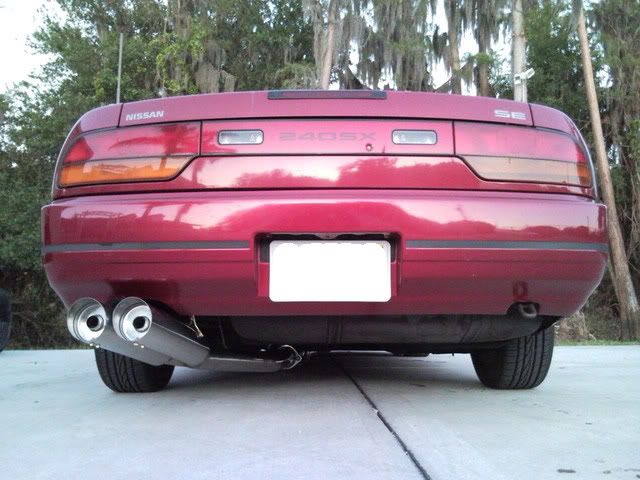

I just installed my reinhard exhaust yesterday and its hanging lower than the diff. So did i install it wrong. Everything is in the place where the original exhuast was. So i didnt misplace anything.
So do i have to modify the hangers so that it will sit flush under the car?
Has anyone else had this problem before?

i had this problem with my hks hipower, all i did was took a few worm clamps aka hose clamps and put them around the rubber hanger bushings and tightened them down, which raised the exhaust up a little bit. I'd give that a try before you actually commit to cutting up the hangers and modifying them.

I was amazed at how much better my exhaust fit when I replaced the bushings. Not only did it raise it up. It also centered it better in the tunnel.

Im going to replace the rubber bushings. They are stretched out so we'll sell if that works

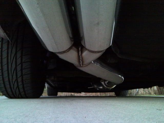

Replaced the bushings and it raised it about a half a inch, maybe a inch. Still too low though. Looks like i will have to get the hangers cut shorter. Ill post some pics of it tmrrw.

Exhaust is on now. Still pretty low to the ground but at least not scraping it

just add metel to the parts that scrape so it scraps off and not the exhaust... just a thought...

Fixed one of the hangers and got some bigger wheels. Its lifted on the ground a good bit now.
