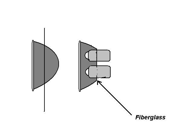

I know exactly what it takes to get more light out of halogen... Ive seen at least 2 or 3 brands of bulbs that are 100w/120w lo/hi and wiring them up is a snap.... also, ive seen bulbs that are supposed to fit H4 or other bulb types that are HID... to retrofit housings...
But about what im saying, let me draw a few pics...
Something like that...

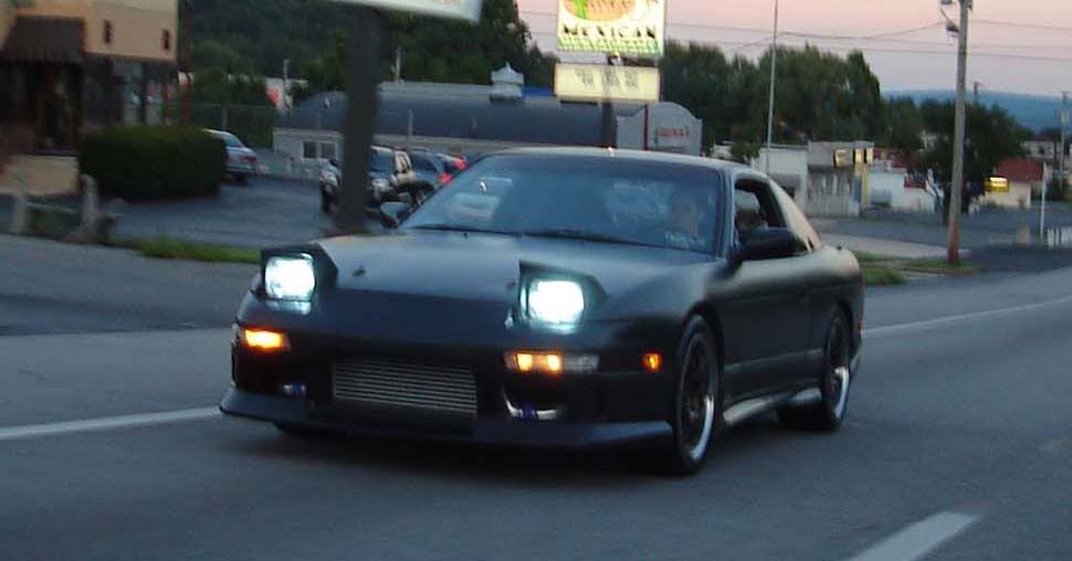

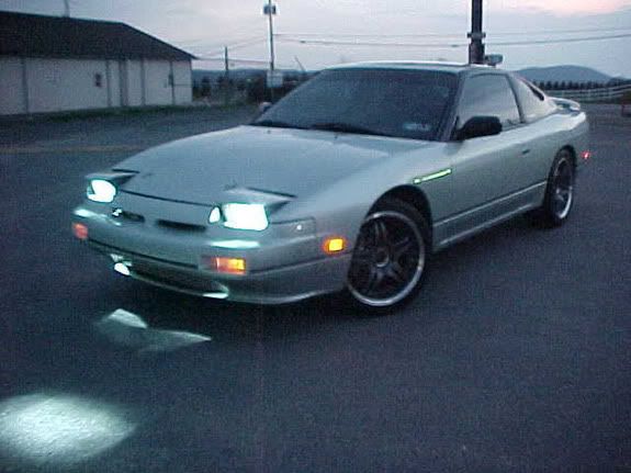

You should do what I did, S14 projectors, fab up a metal frame to fit the projector. Search S13 HID Retrofit, it will come up. In the mean time....

I have ebay h4 conversion, Acura ballasts/ignitors, and 8000k h4 hid bulbs. Lots of rewiring. Out of all the mods on my car I get compliments daily on my headlights...

Looks good. Only thing, need some coilovers. Overall, thats exactly what I am looking for. Pics of the headlights like behind the pop up? Thanks *a
