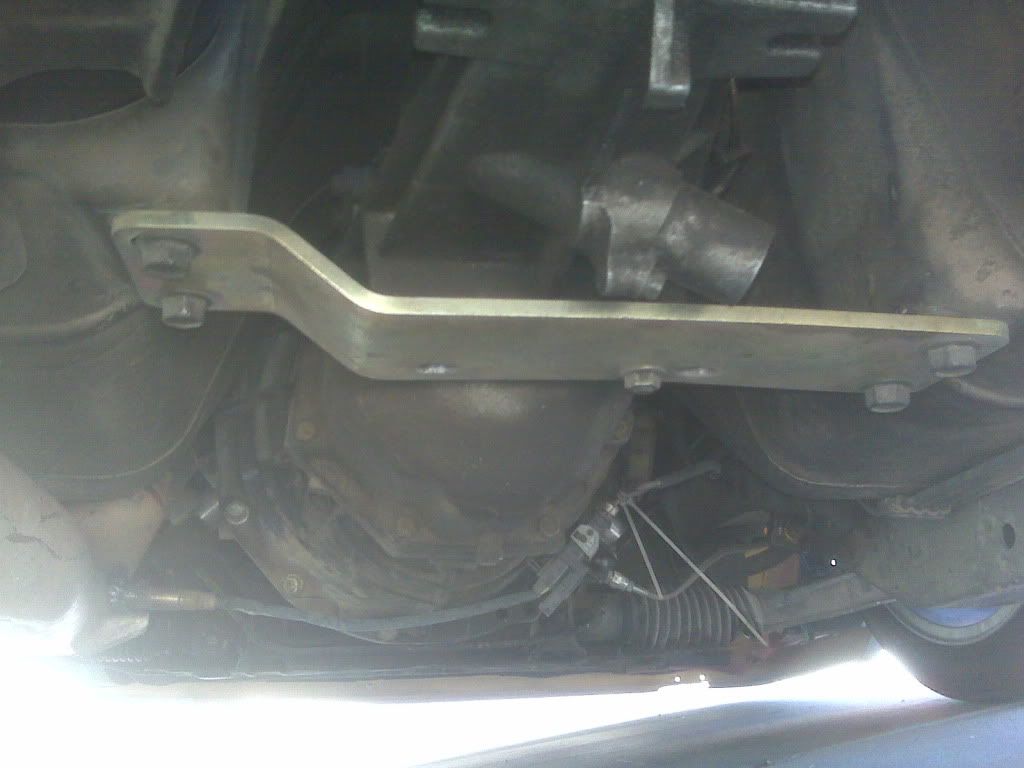

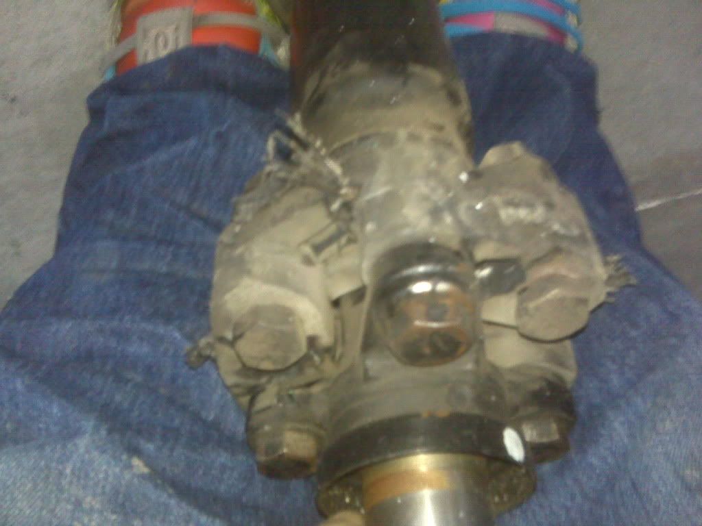

Originally Posted by TheRealSy90 View Post
It's not an issue with the shiftknob. My shifter hits the hole in the sheetmetal where it comes through the bottom of the car. Thus I can't run the rubber boot there because it binds up and won't go into 2nd 4th and reverse. Also due to the new angle of the motor and transmission, I blew up the rubber bushing between the stock two piece driveshaft twice. I had to purchase a Driveshaft shop one piece after that to avoid it.
Found my pictures.
You can see here the holes that were pre drilled, and where I had to drill new ones. I actually didn't get the second hole lined up correctly still and only used one bolt

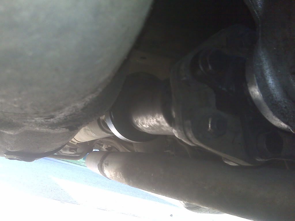

So this was the resulting angle of my stock driveshaft.

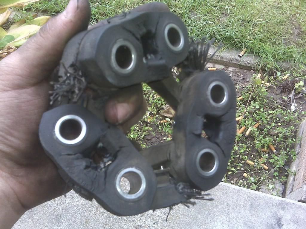

And after a week of driving, this happened.
Replaced the bushing and it broke again after about another week.

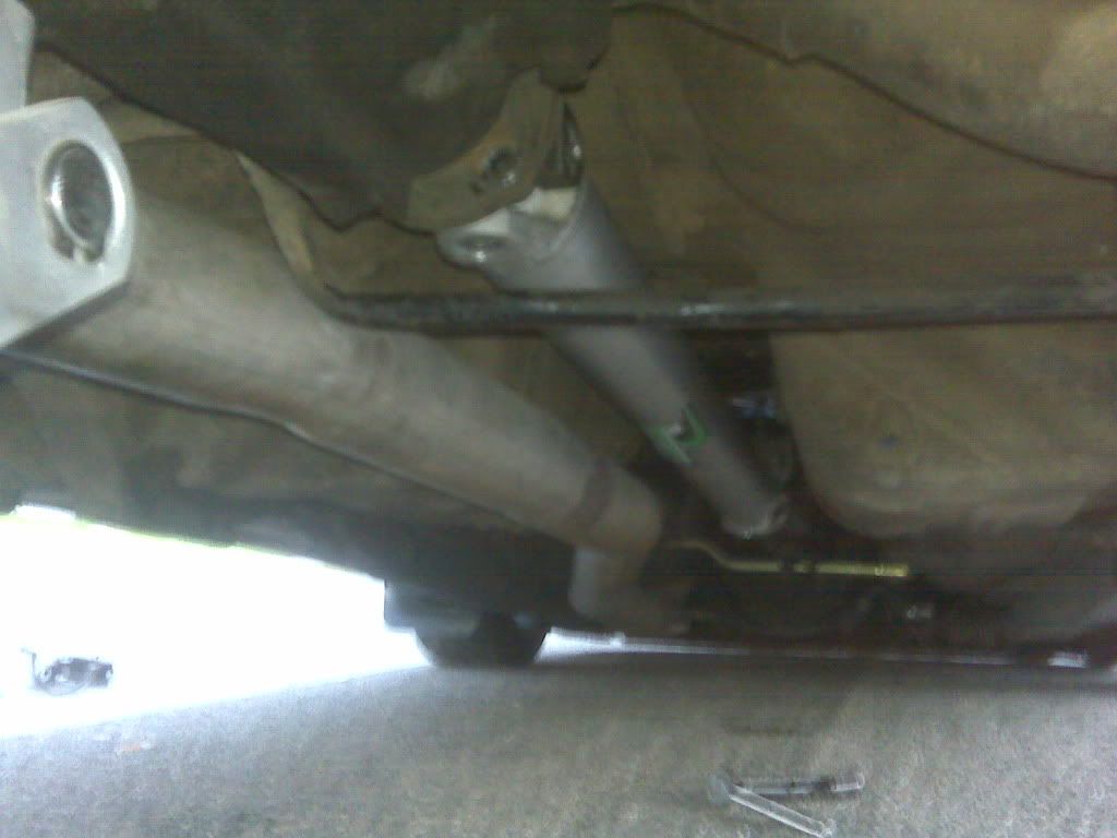

And this fixed my problem from there on. Sorry about the blackberry pictures :$
I forgot to mention I don't have a short shifter lol.
Thought about that but after comparing pictures, looks like yours should be flipped and spun 180 degrees, that should fix your height problem.

Lol no one thought about flipping their mount? Haha

after you flip it...you should also put back that t-mount brace with it like driftnaton did.
