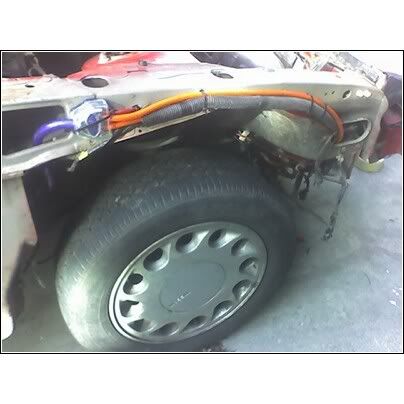

i know that mine is a s13 but i figured it wouldnt hurt to try and help. even if it doesnt lol
thats my old set up. but then went throught he blue power wire.... the new location has it going from the engine through a hole i cut to the inner fender to where it is.......
whatever i dont make sense.......i tried lol
thx but its pretty different lol

Mine is through the engine bay.

Put nails up in the fender well so if you tire tries to mess with your harness, it will get owned.

just yank the box and wire and relocate them both inside
jade
do one of these then stop bitching about how weak your shit is
