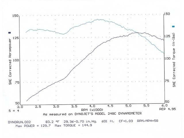

Okay kimosabe', here's a pic of a baseline 95'. Where's the shitloads of power you're referring to?
The KA engine is designed for torque, it's not a B16. Since the torque tops out at around 4300, you're better off shifting earlier rather than later. Of course there can be mods done to boost the HP output and make the engine more rev friendly, but in stock form, there's not much left after 5000. So how about you get YOUR facts straight before you come back.

Oh okay so now it's only "a good difference" of power? Now you're backpedaling. Earlier you said it makes shitloads more power past 5000 rpms.....
....yeah that 5 hp after 5000 is HUGE!!! Hell you can see by the graph that the power only falls after 5500. Really 5500 is as far as I would push a stock KA. So where's this turbo boost you are talking about? Yeah 'shitloads' alright.
The only benefit to shifting at 6500 as opposed to 5000 is that your next gear engages at a higher rpm. But not necessarily in the "sweet spot". According to the graph your optimal range is from around 3300 all the way to right where they crossover, about 5250 rpms. Keeping your car in this range is the key.
It has nothing to do with, "Hey I can rev my car to 7000!!! Can you?" The 240sx doesn't have a B16 with V-TEC under the hood. It's not a rev happy motor right out of the box. And frankly this is common knowledge among the 240 community, you need to do your research more before you go blabbing your mouth like you know what you're talking about.
