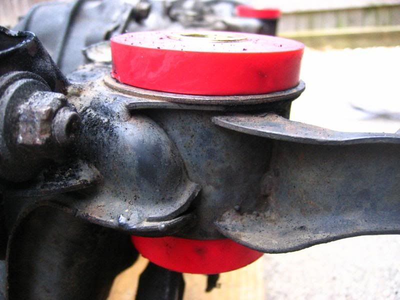

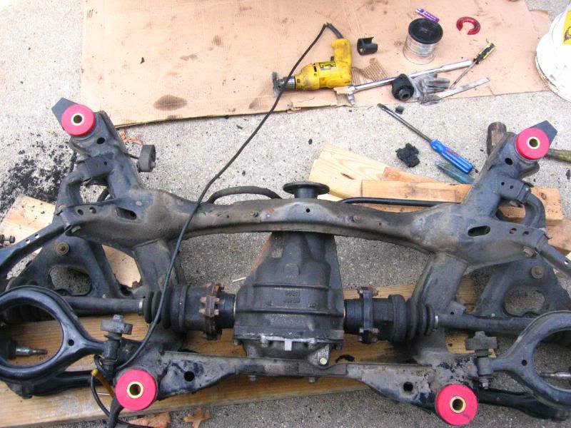

I just did this and i removed the stock ones using a torch, but i didn't melt the shit out, you heat up the outside of the subframe so you make the metal hot enough you can loosen the bond between the rubber bushing and metal.
it does take time and patience, but yeah, of course it's gonna take time if you want to do it right and feel accomplished.
too me 7 hours.
so just get a regular torch from home depot.
drop the subframe.
just heat up the outside as good as you can with the torch to loosen the bond. just jimmy a screw driver in there and pick it out, again each one takes around an hour.
then get a drill and a wire wheel to buff the inside to remove all the rubber that is still stuck.
LET ME MAKE THIS VERY CLEAR, IF YOU USE THE ENERGY SUSPENSION POLY BUSHING REPLACEMENTS (NOT INSERTS) YOU MUST NOT DAMAGE THE OUTER SHELL OF THE BUSHING IF YOU HAVE AN S13. I REPEAT, DO NOT BE A DOOSH AND DAMAGE THE OUTER SHELL OF THE ORIGINAL BUSHING IF YOU HAVE AN S13.
if anyone has a question about this please feel free to PM me, i went through the process recently and it was actually very painless because i had the proper tools and patience.
oh yeah, my rear is friggin TIGHT now.

Originally Posted by s13.dark1 View Post
the bushings where bad so i was just going to put new bushings in along with the spacers or should i just put in solid ones
go solid and call it a day never again have to replace them it would though have ben easier to get the bushings pressed out

Originally Posted by oneviaman View Post
i use an ingersol, with the cutting blade
oh shit i gotta get one of those haha.
yeah i mean i'm talking 7 hours start to finish meaning start the clock at jacking the car up, stop the clock at getting the car on all 4 wheels.
i was by myself so it's hard to fenagle the subframe back up there.
yeah i don't know why these poly bushings don't have more popularity. i mean yeah, aluminum ones are awesome, but these are fantastic too.
