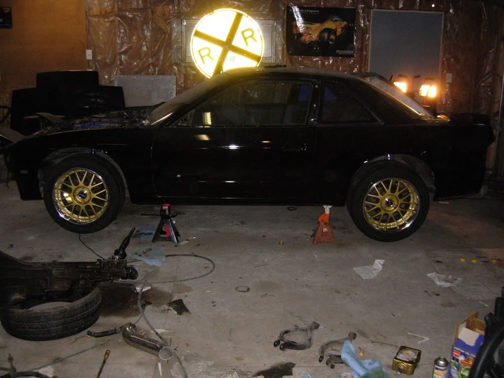

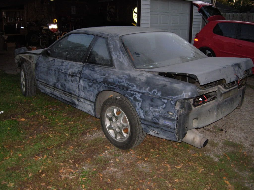

What I started with, about 5 years ago:

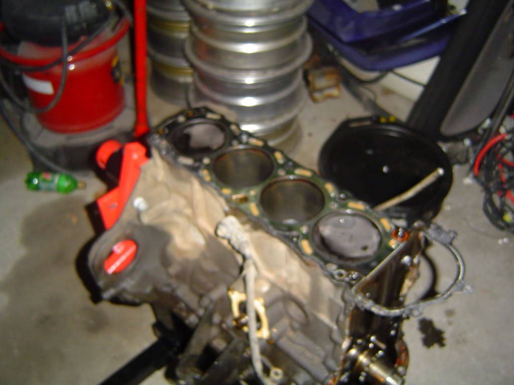

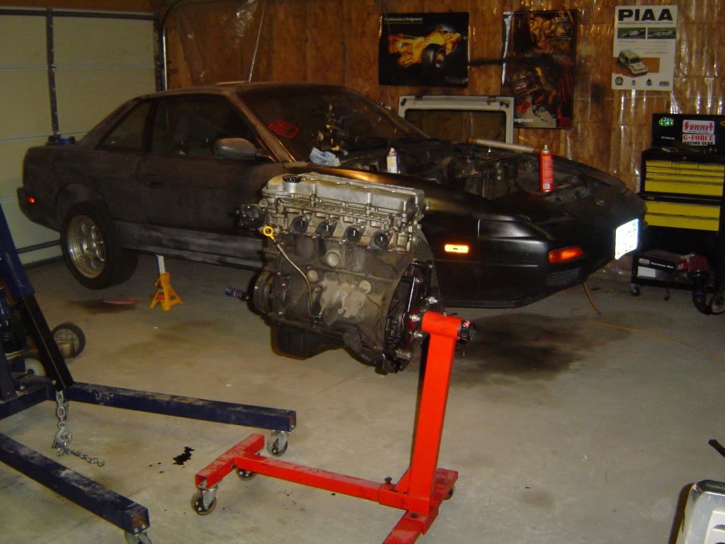

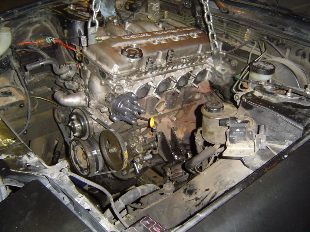

Pulling old motor, tearing it down to send the block off, sanding it down for paint:

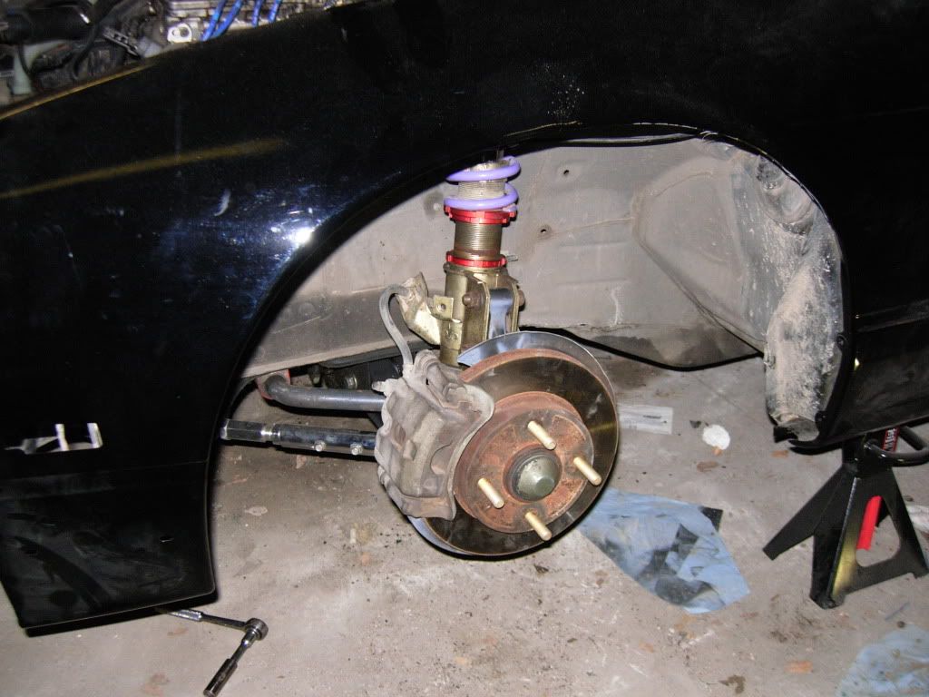

Block back from machine shop, car back from first attempt at paint, put on suspension parts, test fit wheels:

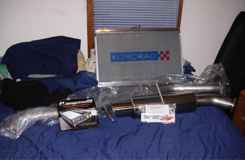

Bunch of the parts I have sitting in my bedroom, waiting to be bolted to something...(no longer have the emanage, sold it to get aem ems)

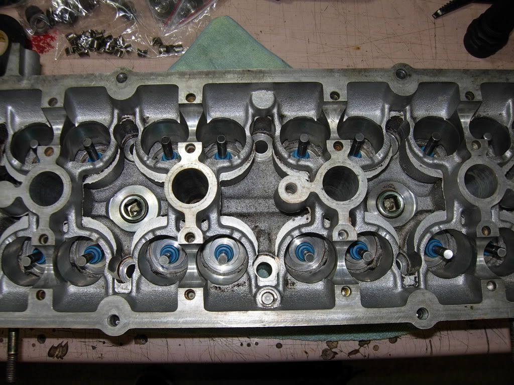

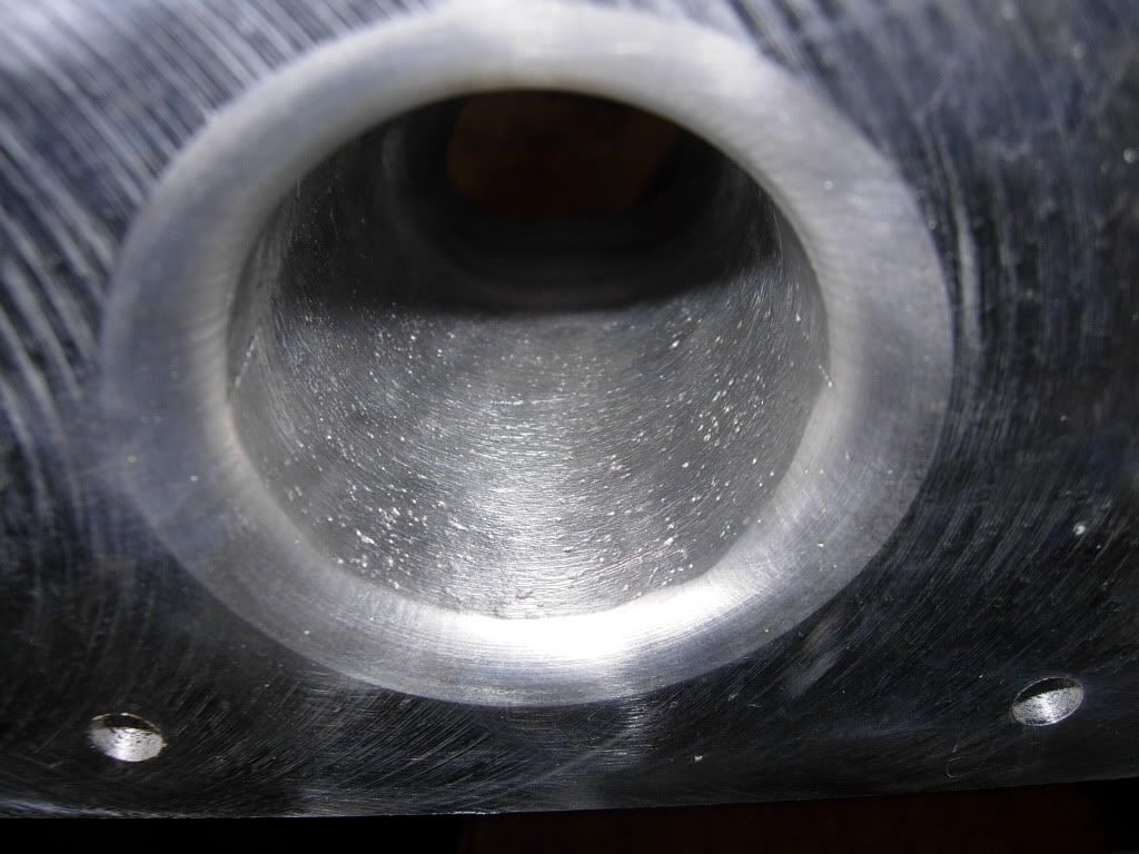

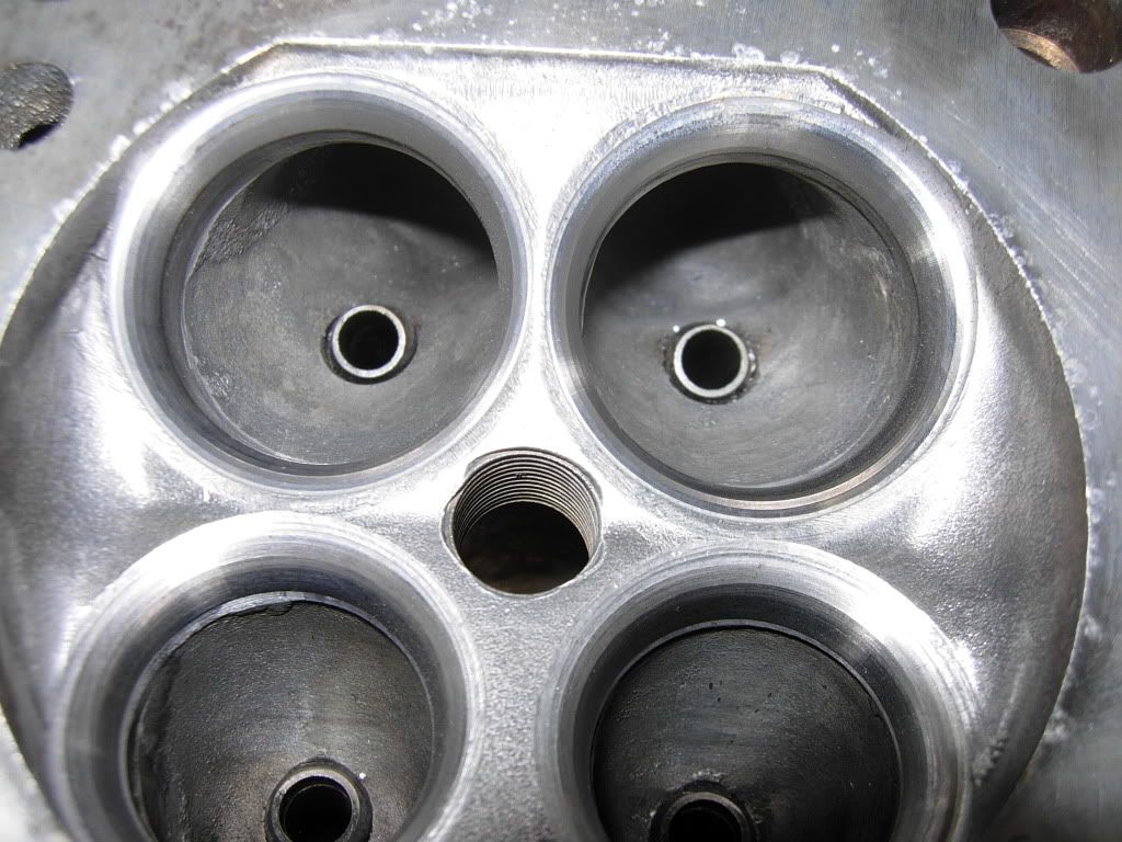

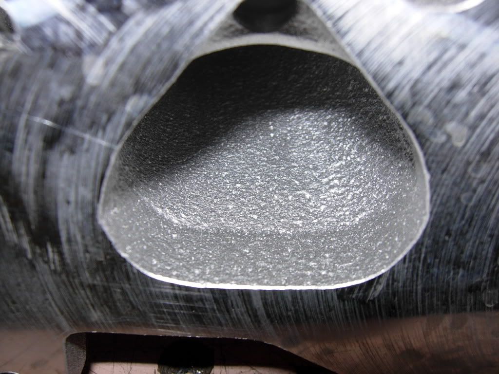

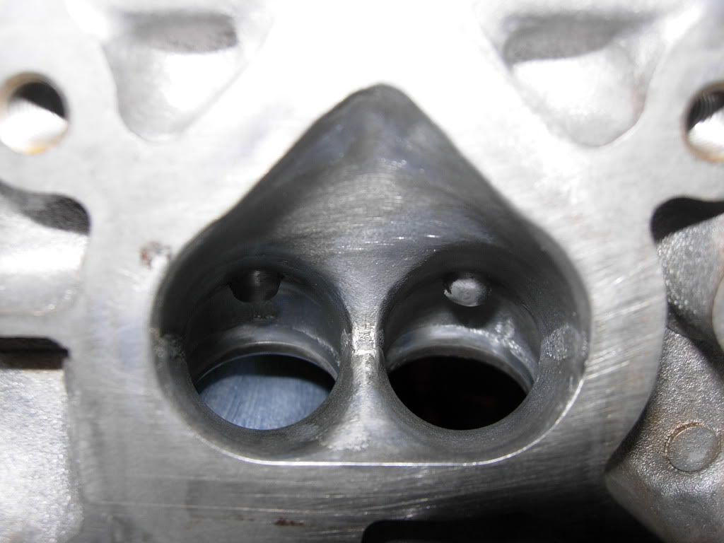

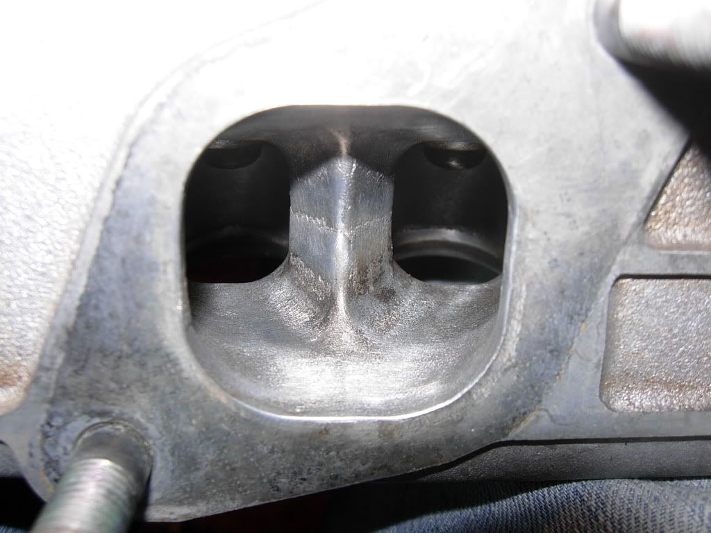

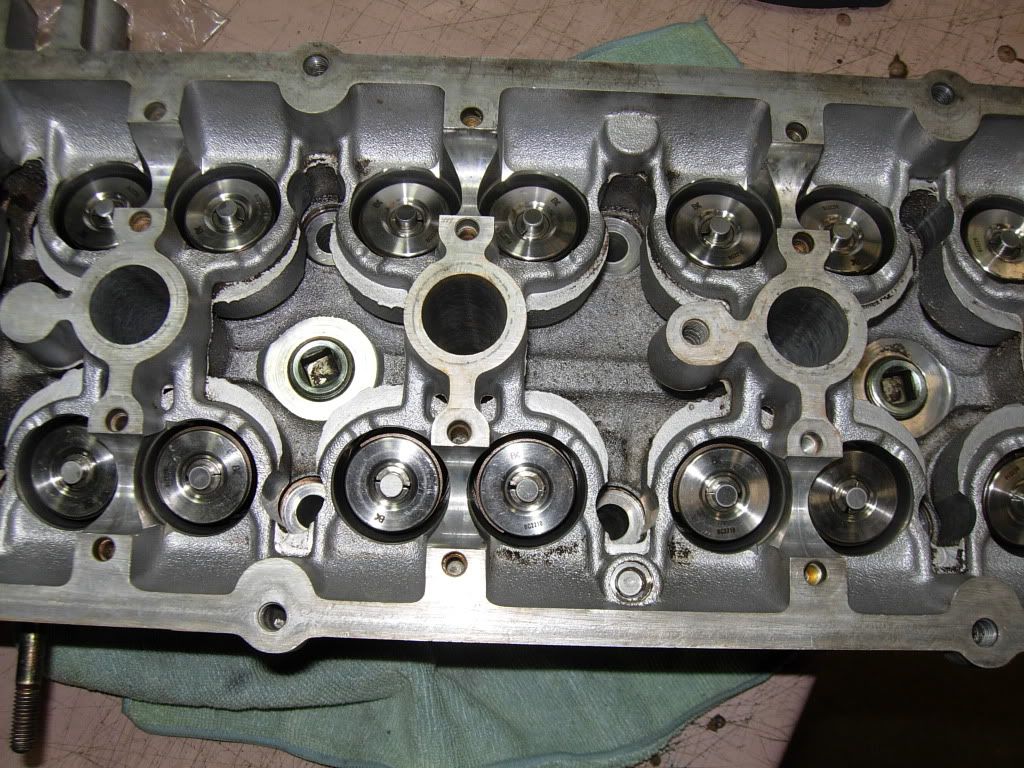

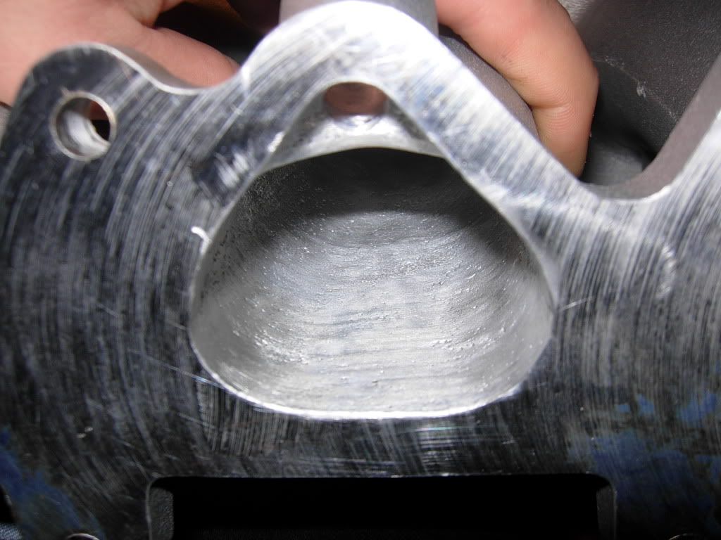

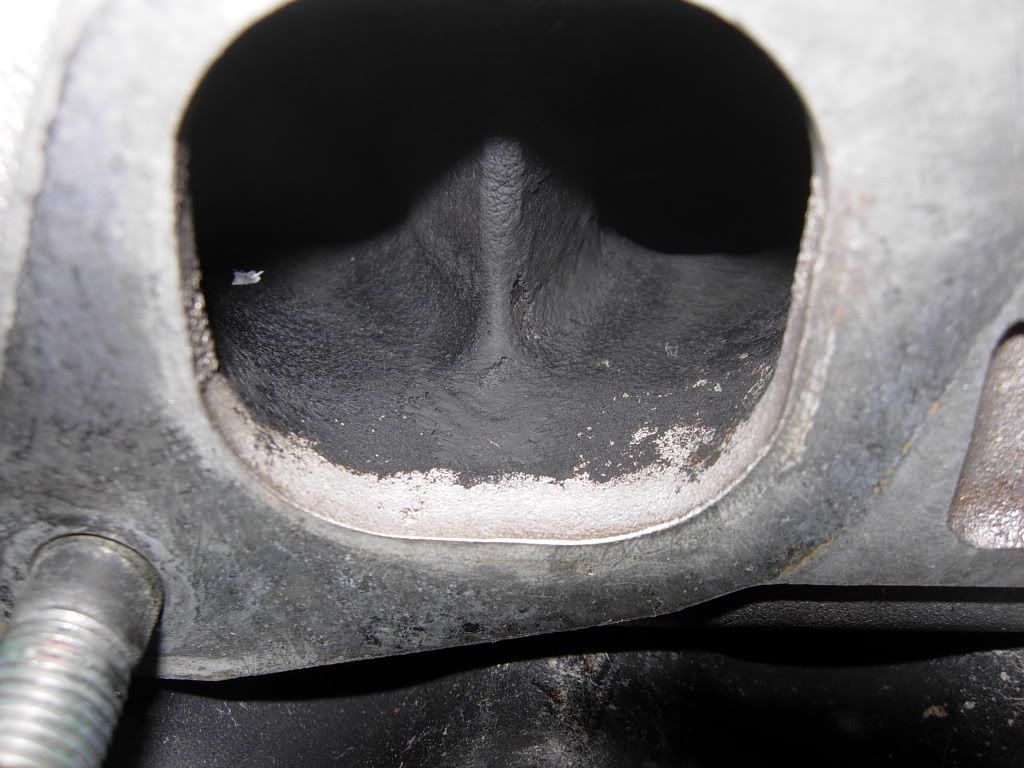

Little update, did some work on the head over the weekend, took it all apart and smoothed out the intake runners and ports on the head a bit...didnt want to go too crazy since I dont have much experience, just wanted to smooth out the flashing from casting and take the roughness down a notch. Waiting on a some valve seals and it will all go back together hopefully towards the end of this week.
Intake mani runners before:
Intake port before:
Exhaust port before:
Intake mani runners after:
Intake port after:
exhaust port after:
cylinder side of ports after:

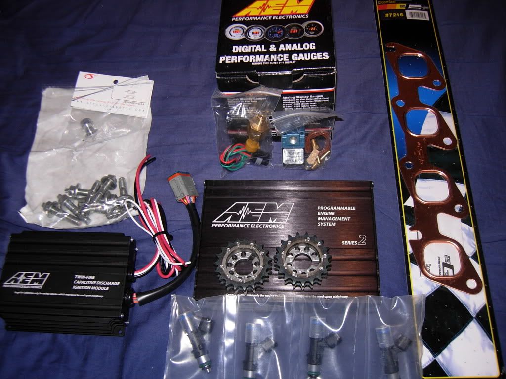

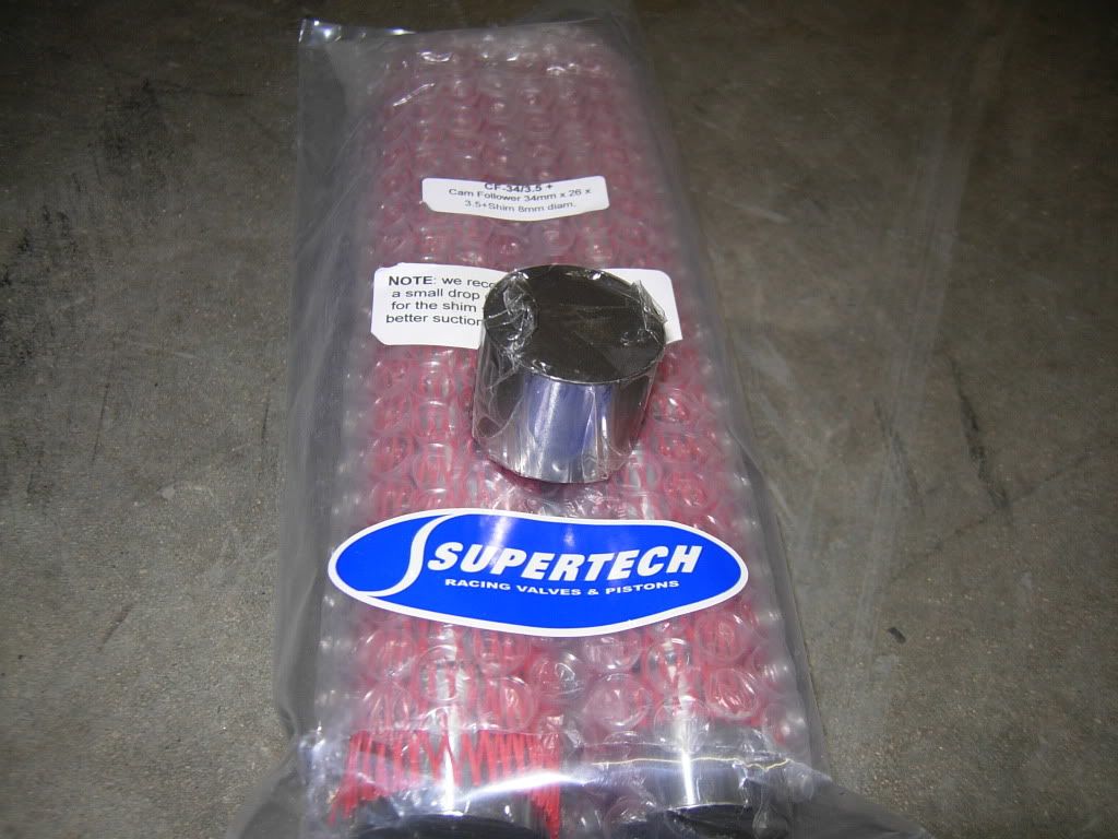

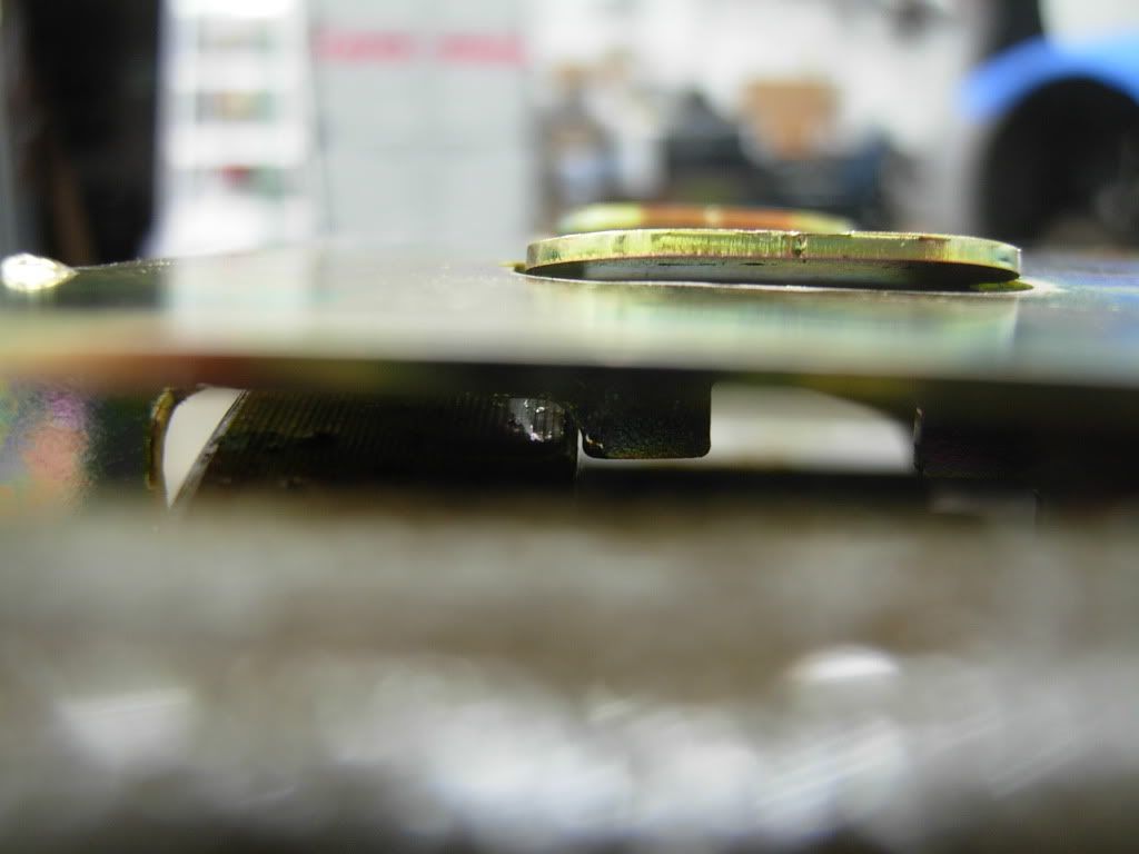

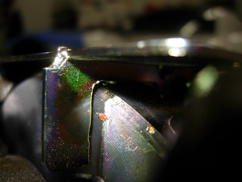

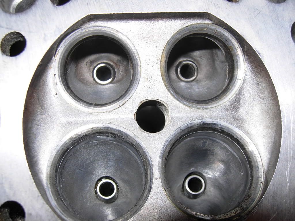

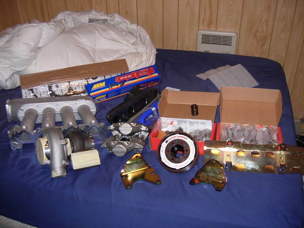

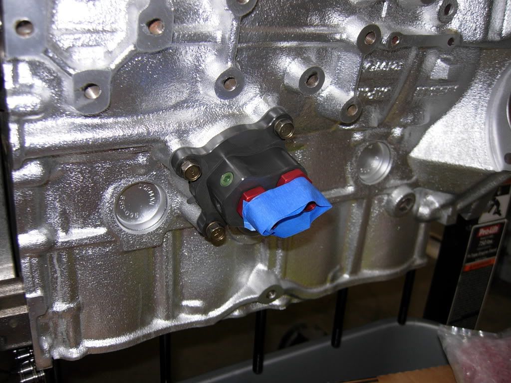

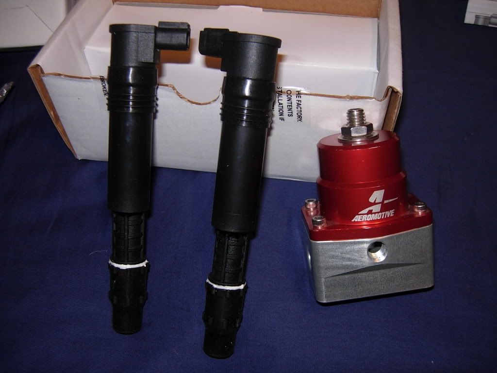

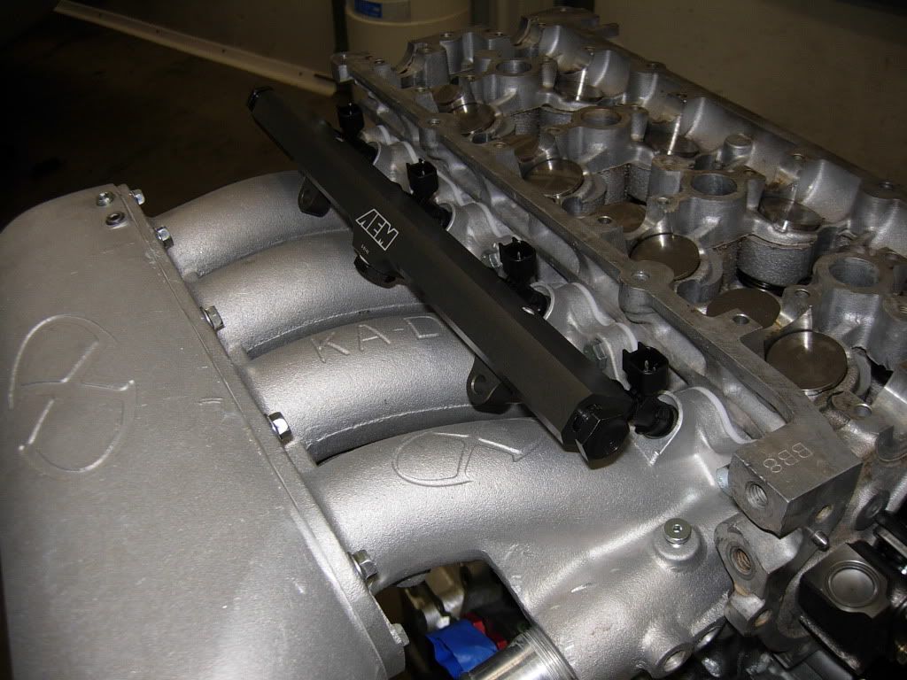

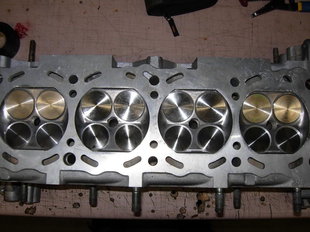

Small bit of progress here. Got some more parts, a Skullworks oil block adapter, some AEM pencil coils, an Aeromotive A1000 FPR, and a set of Supertech cam followers (lifters). I sent the head to the machine shop for a 3angle valve job, and then proceed to assemble the head. I also put the oil block adapter on and installed the Xcessive windage tray/crank scraper, and had to do only a slight amount of clearancing for the crankshaft. Im waiting for a couple more things, hopefully the longblock will be completely assembled in the next couple weeks.
Pics!
Oil block adapter:

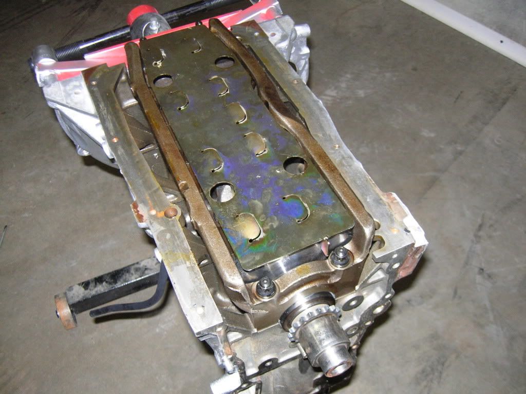

Xcessive windage tray (pre trimming for clearance):
Just back from the machine shop, fresh ground valve seats:
Assembling the head:
revolutionz_s13 is offline   Reply With Quote

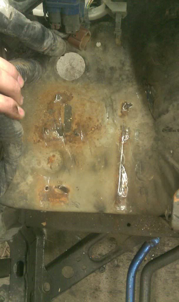

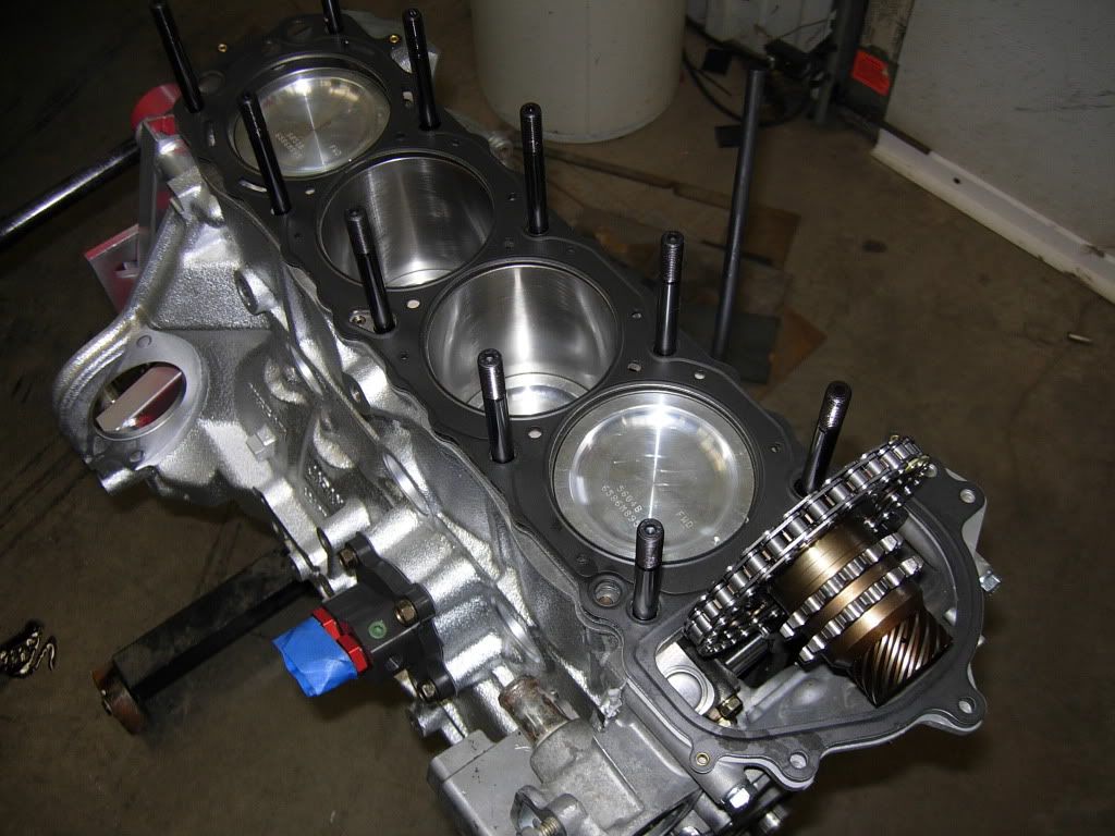

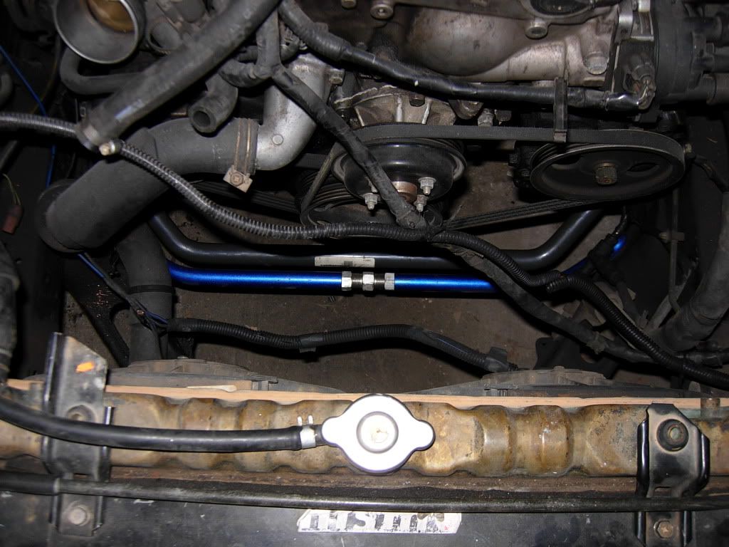

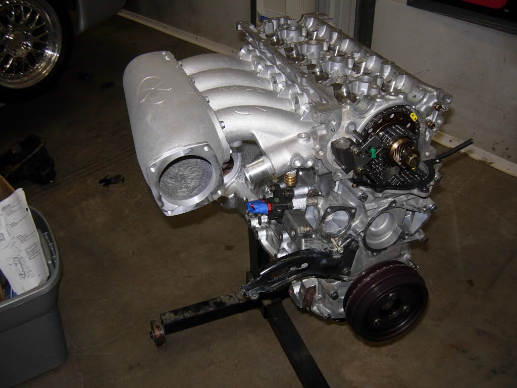

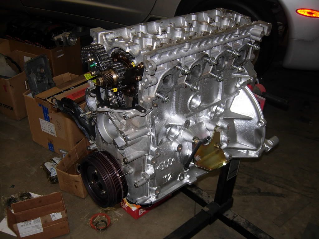

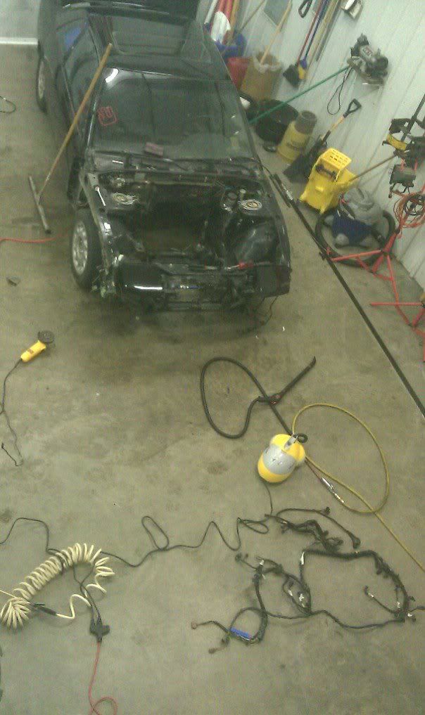

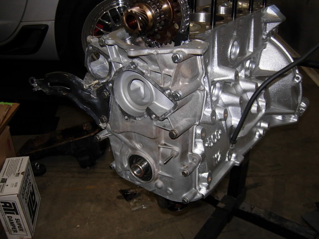

So finally had some time over the last couple weeks to get some more done again. Started cleaning out the engine bay and taking out stuff I dont need anymore. I cut out the battery tray too, that sucked ass. Also pulled the engine bay harness out so I can go through it and check all the wires to make sure they are good, and to add wires I need, and take out ones I dont. I also got everything to start getting the motor more assembled. I was like a 2nd christmas over the last week, a bunch of parts came 8) I ran into a snag tonight, I need to get longer spacers made for the fuel rail, the ID1000 injectors + xcessive mani ends up with a much larger gap than what the spacers came with for the oem fuel rail. Pics!
Parts!
Cleanin a mess
Battery tray removed
A days carnage
Puttin the motor together little by little
Its gettin there slowly but surely, needs lots more time and money tho :? Feels good to be making progress again after a couple years of it sitting though. Comments, suggestions, and flames welcome

looks good i have the xcessive manifold, on my ka-t as well, get rid of that fitting that comes off of the water neck, its a pita to get that hose to run to the back of the thermostat housing, i've been working with xcessive on a new design based on my suggestions, and that was one of them. You will notice when you put the rest of your front cover together that you have absolutely no room in between that fitting and the heater hose return. I am running my hose from the back of the thermostat housing to a tee fitting in the heater hose line that comes off of the block with no problems. That's how Rich from xcessive recommended to run it.
Just a heads up, but other than that your build looks on point
awesome, thanks for the head up man. So did you just get a 3/4npt plug for that hole then? do you happen to have a pic of how you ran your coolant lines?

yeah i'll take one in the morning, i actually just did it on mine a few minutes ago, and its a 3/8th plug. Then i got a 3/4 t fitting from lowes and tee'd it off of the heater hose that comes off of the block
