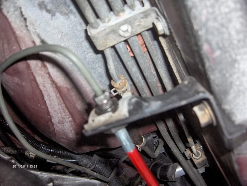

and pics as promised
this second one shows how we bent the hardline to run into the SS line

when i took off the uselles dampener box i just bent the hard line a bit everything and came out good...well

Thanks for the input! So I'm guessing u just kept the rubber hose when u did that. Did u put any kinks in the hardline at all? If not then I guess we know what happens when u keep the rubber hose!

i dont think i put any kinks on the line One Love Silvia
i bent em SUPER CAREFULLY
