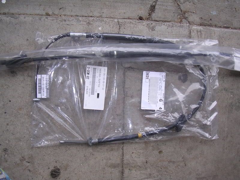

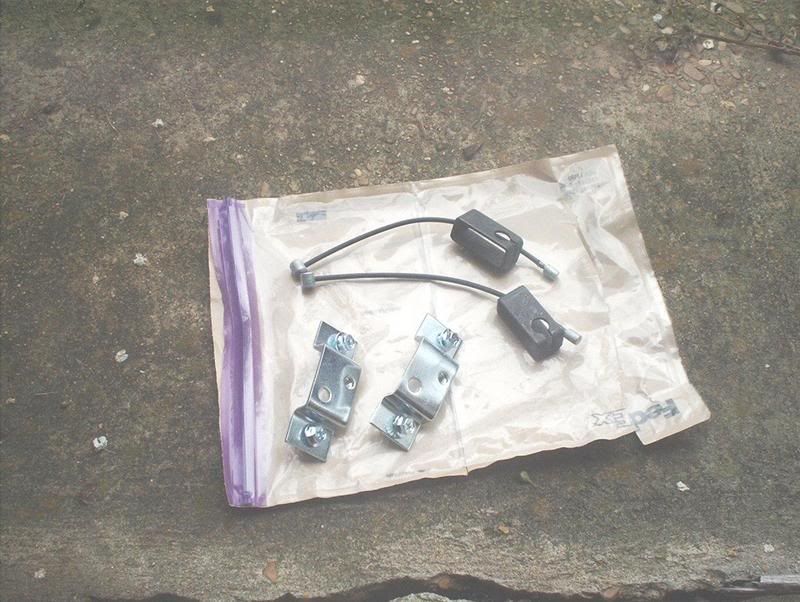

Who sells those ebrake cable extensions now days, im not having any luck
these:
thanks

z32
z32 2 seater or 2+2 cables.
2 seater cables work, but tight. 2+2 cables work really good.

^Z32 2+2 cables work nicely like said before me.

you guys using the z32 2+2 cables. How do they lock up for you? I have ran both 2+2 and standard z32 cables.
The 2+2 cables don't really lock unless I pull the handle all the way up. And it only locks at the top. How do they feel for you? Like the stock e-brake(before z brakes)? And how did you route the cables through the subframe?

I have the extensions, but not the 2 silver brackets. You can have for $20 shipped. Otherwise, just pay a lil more and get from that ebay link ^^^^.

i just got a set of these today. does anyone have any experience with them? i've got the 2 seater cables, and planning on using these...

well it sounds like maybe you didn't have it adjusted right.. the extensions seem to be perfect to me, it's the brackets that didn't work. the brackets that the extensions came with would not work w/ the 2 seater z32 cables that i'm working with, so we fabbed up some strong/small L brackets instead. haven't finished the install yet, so i'll follow up when i'm done.

wel wutangben, did you mount the dark metal piece on the extension any where cause i didnt. I just hook it to the t-bar then tighten it and just yank the ebrake and it broke.

That picture of extensions is from positronone, and he ended up not using them. He used 2 seater cables inseatd. 2+2 cables are better because their brackets are in better design than 2 seaters for s13. I saw one good write up in freshalloy about 2+2 cables.

I used those adapters from Ebay. IMO the're junk. Third time I set the ebrake (in the shop, not even driving the car) one of the ends on the right cable extension came off.
just buy a set of 2+2 cables and be done with it.
Broken:
Fixed:

koolcat, where did yours break? at the same place RPS1392's did?

yup same place as rps1392's, the end that hook into that black metal box is weak. Well RPS1392's where did you get those cable and how much i really dun wanna spend another 100something for them cables

ok so my extensions broke today as well. we spent quite sometime making them perfect, yanked up on the e-brake a bunch of times, everything seemed fine. took it out for a test spin. adusted it a little tighter while at the gas station, pulled up on it, not even that hard, and broke one of the sides. the other side is about to come off as well.
these things ARE junk, but hey i had to try em...
i think i'm going to just splice both sets together to make them reach... my car needs to be ready in 9 days, so i don't have time to source out the 2+2 cables.

take bens advise i did the install for him and these things are junk!!! dont waste your money just splice the existing cables

why dont u guys buy some home depot cable clamps and rig it together with a lenght from ur old lines? search for my diy thread there is a pic of my method

just got back from the hardware store with some good clamps! 69 cents a pop. guess i should have done this from the start, oh well. STILL had to make brackets for the 2 seater cables anyway.
since it took us three tries to get it right, i have '3-way adjustable' e-brake cable brackets! just going to chop the s13 cable ends and use whatever the length of the extenions were, and it should be perfect.

Finally over and done with, took the splicing advice and it worked. Tried to order rockauto parking brake cable for the 2+2 but they dun even know when they will have it in stock so i just spliced it. Went to home depot and bought some 1/8" clamp for metal cable which was $4.79 for a pair but some how rang up to be $.02 for both set, lol. So i knew it was my lucky day. I used the stock position on the subframe to mount the cable and also splice the z32 cable with like 8 inches or so of the stock 240sx cable, just enough to reach the t-bar. Also it was nice that i could still use the stock mounting place near the t-bar by cutting and reusing the stock tube.

it's hard to tell by your pics, but did you clamp the cables w/ the plastic coating or whatever still covering them? my clamps had warnings not to do that so i grinded the plastic off...

also looking at how you used the s13 cable brackets, does that actually work? can't the cable travel as far as it wants through the casing that the bracket is connected to? i mean it would obviously either hit the pit or the clamps, but i thought it need to be more 'fixed' for lack of a better way of putting it. i should take pics of my setup.
