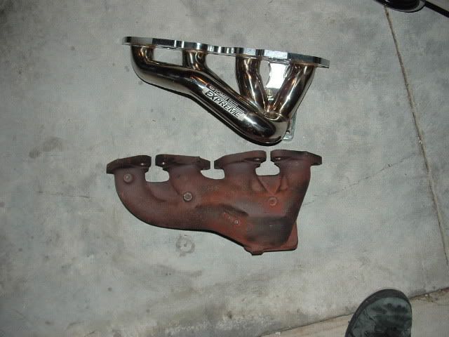

Mind telling us if you felt any difference compared to the stock manifold?
I read a long time ago that these short tubular manifolds gave a quicker response than the longer tubular ones (a la Full-Race or Megan racing).

Megan racing is now "long tube"? My Megan mani looks almost just like the Tomei. With something as small as a T25/T28, you're not going to notice that much of a difference in spool or response... The advantage of tubular manis is that they flow better at higher rpm, and therefore can give much better response on the really big turbos. I've noticed a much bigger difference in response and power delivery when going to a 3" elbow/downpipe than switching manifolds.

Thanks, what i meant to say was that the megan manifold has a 4/1 collector that has a different design. The tomei one seems to merge the two middle runners first. And also if you look at tomei manifold, the lenght of the 2nd, 3rd and 4th runners are distinctively shorter. Here is a megan for reference.

Yeah the Megan is an "equal length tubular manifold", but it's by no means as long as some of the top mount manis (Full Race, custom drag manis, etc). I guess the Tomei isn't an equal length design or a pulse-tuned design (where two runners are long and two are short) but more of a tubular stock mani - quicker spool, not the same top end potential.

^ I'd go out on a limb to say it probably dissapates heater faster than the cast stocker.
