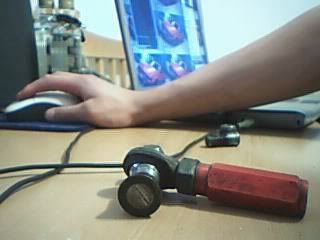

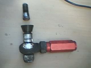

those are the kazama ones I had on my car for less than a year, didnt even get to track it, barely drive it (got an 86 daily), and I was just making a very very low speed u turn into my shop. the thing that pisses me off the most is that more japan wouldnt sell me just that cone shaped bolt that goes through the tie rod end and steering knuckle. they wanted me to buy the whole set...I installed these properly myself less than a year ago and got the whole car aligned at my shop...
ive heard the kazama ones break but never believed it cuz the ones I heard that break are at the track...time to buy the SPL ones!!! cuz all I hear is good stuff about them
