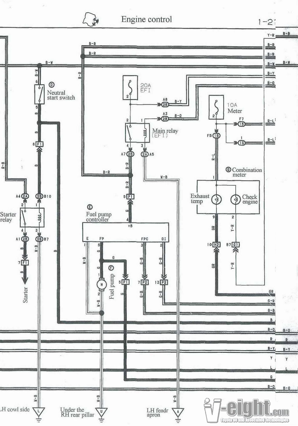

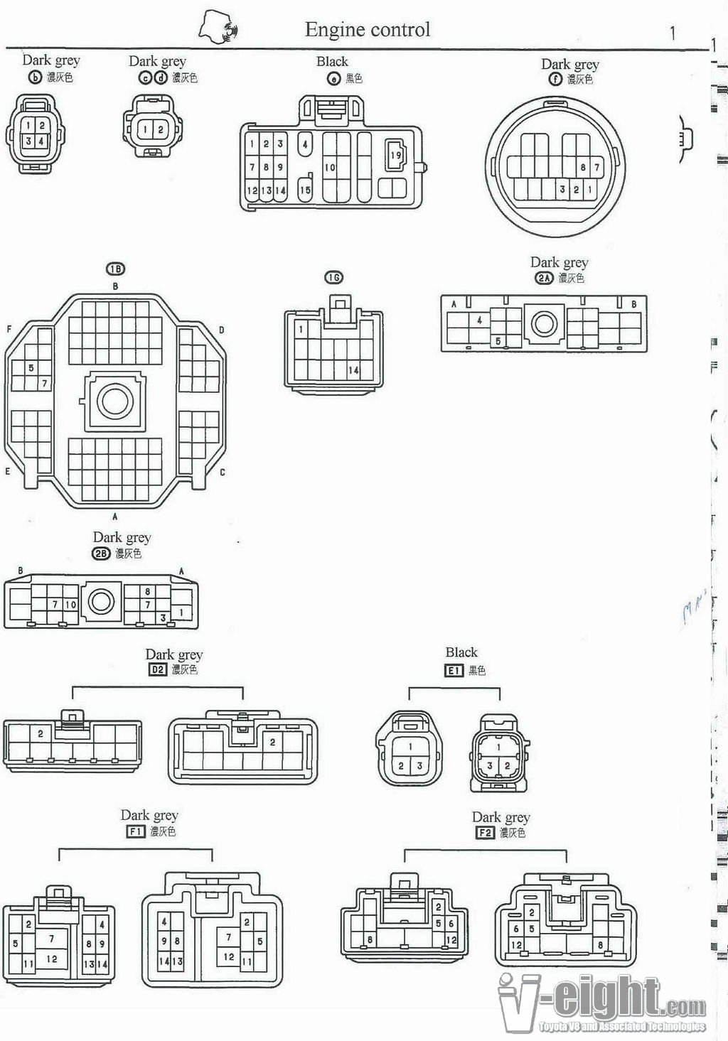

So here it is. i know many people are doing the 1uz to s13 swap so lets get a wiring thread for this down. im going to post all the s13 ----> 1UZ info i have gathered. LEGGO!
Toyota wiring follows a certain kind of logic,
  • ... heres that key to that logic,
  • ... Each pin usually does something, its not always something important,
  • ... you can just de-pin or remove the auto trans by snipping the wires,
  • ... a few pins are sometimes blank across various engines are various things are there or not,
  • ... but the core shit's always there, like crank sensors (which sense where the motor is in its revolution), and the two cam sensors in each head.

NOTE: the long description for pin 1 (FPR) is wrong. The output is actually 0.004 volts which is too low to trip a relay. Ideally you want the ecu to turn the pumps on and off depending on whether or not the engine is running. Because if you have a crash you want the pumps to stop. This is the pin you do that from, (thats from memory), but the out put is too low to do that. I'm sure some smart cookie will tell me a way around this so I can publish it here.
- (Core Wire:A must connect) - = The engine will not run without this wire.
- (Core Wire:B must connect eventually) - = The engine will run without this wire, but in default map. You should sort this out.
- (NOT A Core Wire) - = The engine will run without this wire, perhaps not with the Automatic Gearbox, with a manual you dont need this.
Note: it makes me unfortable to not say this: TPS and the o2's do need to be there for it to run well, so does the MAF, the Idle Control stepper motor, etc. But, it'll start and run without them (MAF is questionable with some models).
Break down of the codes above.
  • ... (NOT A Core Wire) - FPR Across Fuel Pump Relay, - this does not trip a relay, the output I measured today was 0.004 volts not enough to trip a normal relay.
One installer recently emailed me and noted:

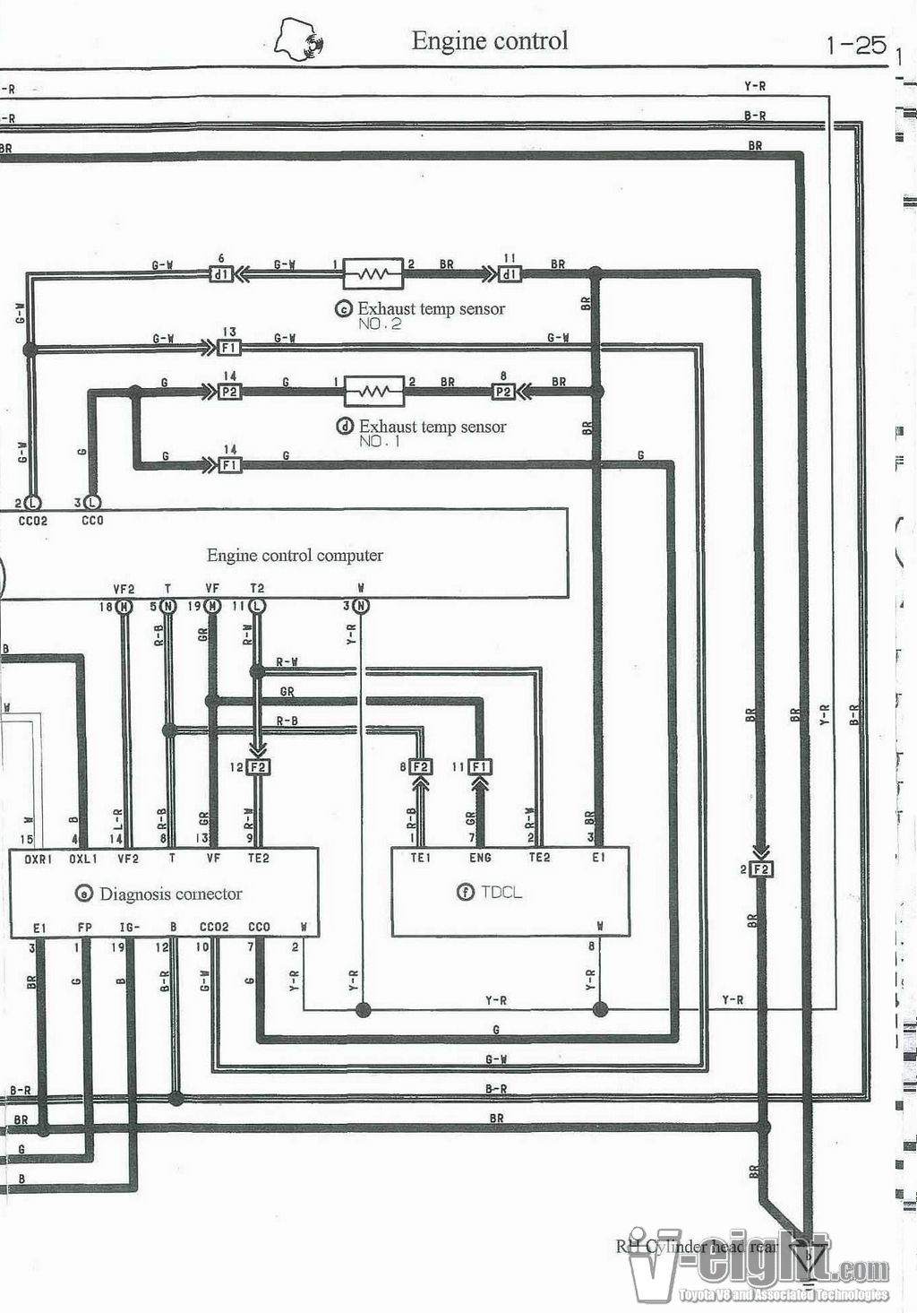

FPC/FPR would control fuel pump computer. They are to be inspected with oscilloscope, you will find 5v pwm signal there. There are ways of setting these outputs to control your pump without stock fuel computer
  • ... (NOT A Core Wire) - THG Deleted EGR Gas Temp Sensor - this is normally in the body loom with the extra o2's sensors that are located after the Cat-converter. Rare to get this sensor. No a needed sensor, motor runs fine without it,
  • ... (NOT A Core Wire) - W Check Engine Light - this is an earth wire. Apply power from stage two on the key (IGN) second position, to the other side of a 12v light using W as the earth for the light. this will give you a check engine light. When you earth out TE1 to the engine this light will flash and give you codes (refer to diagnostic how too for more information)
  • ... (NOT A Core Wire) - FC Fuel Pump controller - you dont need this wire, this is 'half the speed wire' it sends a signal to the fuel controller ECU to half the pumps speed at idle, this does not trip a relay, the output I measured today was 0.005 or 0.003 volts not enough to trip a normal relay.
  • ... (NOT A Core Wire) - TE1 TE1 is the diagnostic switch in the ECU, earth this out and the ECU goes into diagnostic mode,
  • ... (NOT A Core Wire) - OIL Traces into Auto Loom / this is the Oil Temp sensor wire for the Automatic transmission - you dont need to use this wire,- I connect this when running the auto

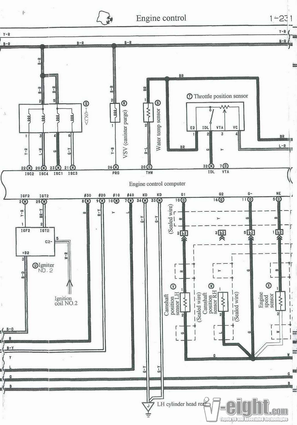

  • ... (Core Wire:A must connect) -#60 Injector 6 Earth / ECU fires injector from this by earthing out the wire,
  • ... (Core Wire:A must connect) -#50 Injector 5 Earth / ECU fires injector from this by earthing out the wire,
  • ... (Core Wire:A must connect) -#40 Injector 4 Earth / ECU fires injector from this by earthing out the wire,
  • ... (Core Wire:A must connect) -#30 Injector 3 Earth / ECU fires injector from this by earthing out the wire,
  • ... (Core Wire:A must connect) -#20 Injector 2 Earth / ECU fires injector from this by earthing out the wire,
  • ... (Core Wire:A must connect) -#10 Injector 1 Earth / ECU fires injector from this by earthing out the wire,
  • ... (NOT A Core Wire) - S1 (Auto) Electric Solenoid #1, - I dont connect this unless running the auto

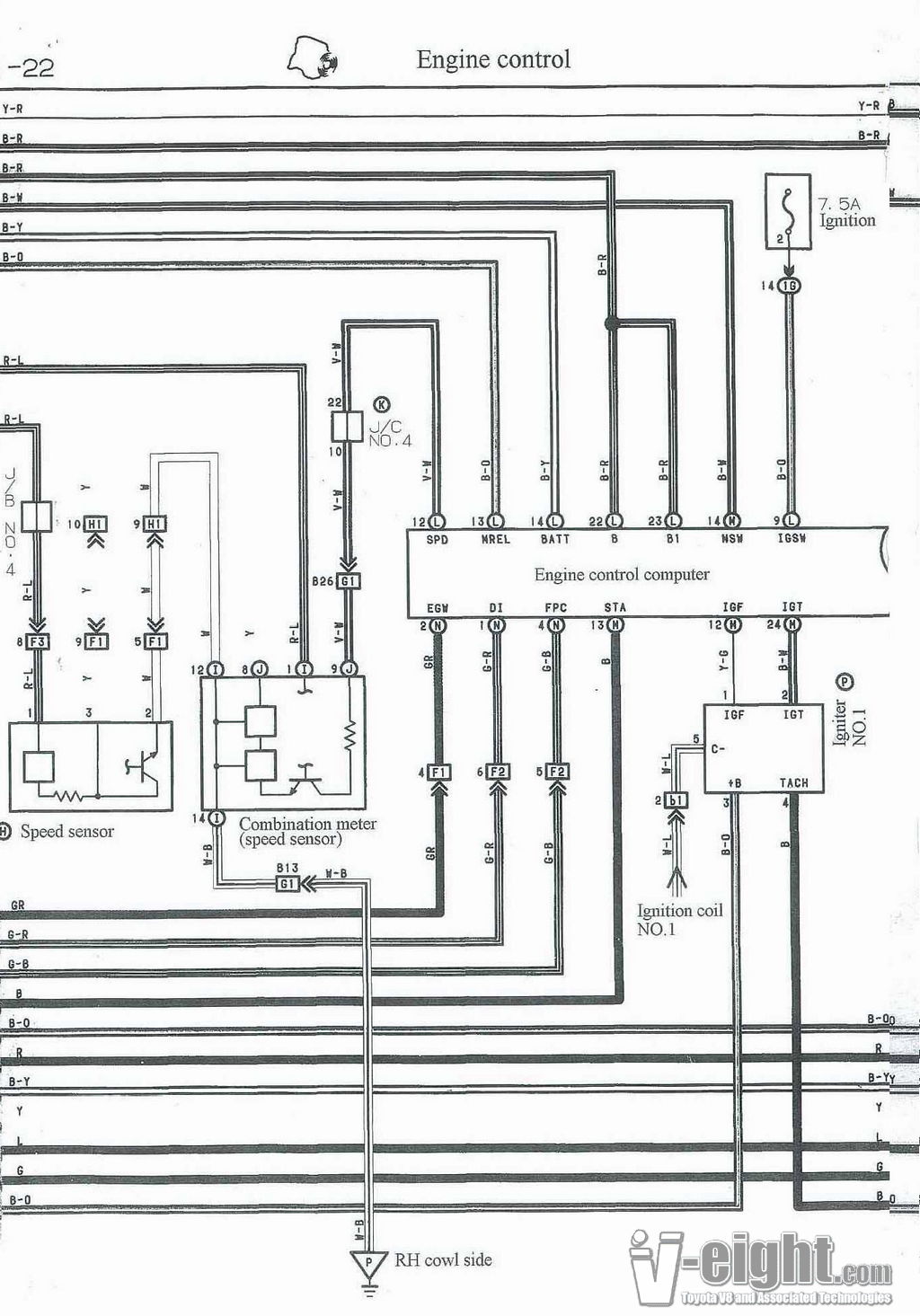

  • ... (Core Wire:A must connect) -IGF1 5 Pin Ignitor pin 1 (on that plug),
  • ... (Core Wire:A must connect) -STA Tells Ecu engine is being started - connect this wire to the starty relay output, or the black starter SOLENOID wire, not the main cable.
    ... It must have power, when the engine turning over and starting (if not power, no start / couple of fires thats it).
I would strongly recommend to connect STA/NSW pins as per toyota diagram. Though the engine starts without both of them connected just as fine.
- I'm pretty sure that STA is the pin that tells the engine that it's being turned over, and without it, the ECU has no idea it's being started. (In my humble opinion)
- I'm fairly sure that NSW must have 12v+ on it, other wise the engine thinks the Automatic gearbox is in drive, so it refuses to fire at all. (In my humble opinion)
  • ... (Core Wire:A must connect / deal with.) -NSW Neutral Start Switch: has 12+ when in neutral - pair with 'STA' wire so 12v+ is present during starting, in a manual conversion, if your running the (factory) auto and the auto loom is present in factory condition the NSW tail out of the loom (near the plugs and NOT part of the auto loom) is meant for the dash display DO NOT connect that to +12v it WILL prevent starting completely, engine wont even fire (more than once) -
  • ... (Core Wire:A must connect) -#80 Injector 8 Earth / ECU fires injector from this by earthing out the wire,
  • ... (Core Wire:A must connect) -#70 Injector 7 Earth / ECU fires injector from this by earthing out the wire,
  • ... (NOT A Core Wire) - S2(Auto) Electric Solenoid #2 - I dont connect this unless running the auto,
  • ... (Core Wire:B must connect eventually) - ISC4 Pin (3) Idle Control Valve,
  • ... (Core Wire:B must connect eventually) - ISC3 Pin (6) Idle Control Valve,
  • ... (Core Wire:B must connect eventually) - ISC2 Pin (1) Idle Control Valve,
  • ... (Core Wire:B must connect eventually) - ISC1 Pin (4) Idle Control Valve,
  • ... (Core Wire:A must connect) -IGT1 5 Pin Ignitor pin 2 (on that plug),
  • ... (Core Wire:A must connect) -IGT2 4 Pin Ignitor pin 2 (on that plug),
  • ... (Core Wire:A must connect) -IGF2 4 Pin Ignitor pin 1 (on that plug),
  • ... (NOT A Core Wire) - EGR4 EGR Valve - ,
  • ... (NOT A Core Wire) - EGR3 EGR Valve - ,
  • ... (NOT A Core Wire) - EGR2 EGR Valve - ,
  • ... (NOT A Core Wire) - EGR1 EGR Valve - ,
  • ... (NOT A Core Wire) - IDL2 Pin 1 – Idle This is used by the traction cntrl system, I ignore/remove it,
  • ... (Core Wire:B must connect eventually) - IDL1 TPS - Pin 2,
  • ... (Core Wire:A must connect) -E02 Earth Left Rear Cylinder Head
    ... (there is an earth point on each head at the back, under the plastic cam end seal, I use these earth points, both of them.
  • ... (Core Wire:A must connect) -EO1 Earth Left Rear Cylinder Head.

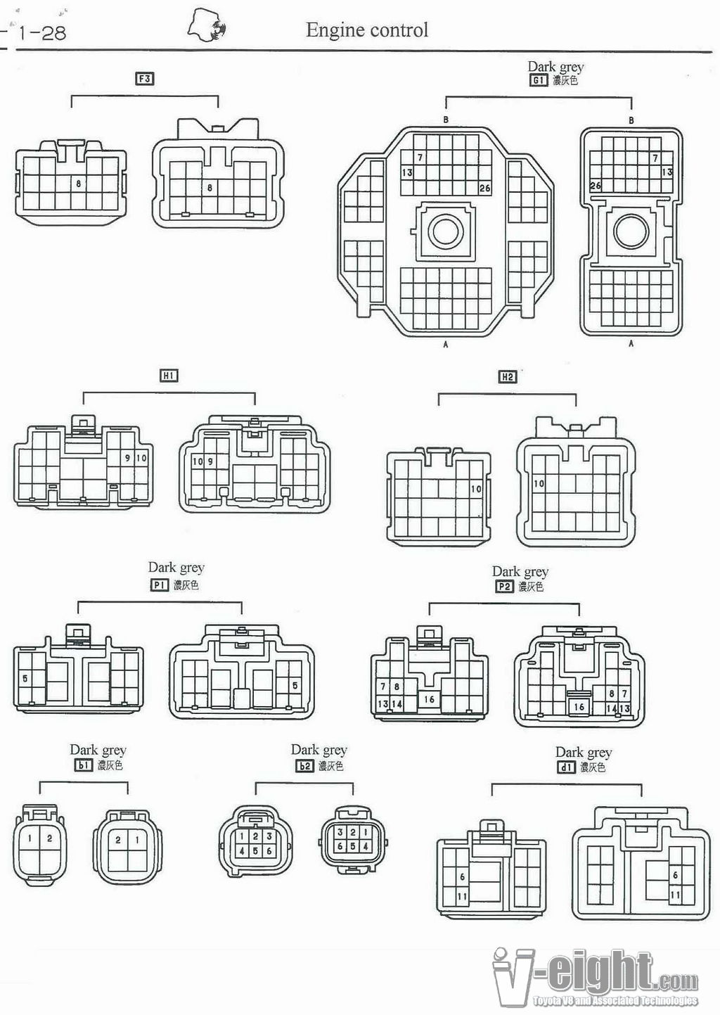

1993 1uz-fe diagrams
http://i977.photobucket.com/albums/a...rdcapri/04.jpg
http://i977.photobucket.com/albums/a...rdcapri/05.jpg
http://i977.photobucket.com/albums/a...rdcapri/06.jpg
http://i977.photobucket.com/albums/a...rdcapri/07.jpg
http://i977.photobucket.com/albums/a...rdcapri/68.jpg
http://i977.photobucket.com/albums/a...rdcapri/69.jpg
http://i977.photobucket.com/albums/a...rdcapri/70.jpg
http://i977.photobucket.com/albums/a...rdcapri/71.jpg
http://i977.photobucket.com/albums/a...rdcapri/72.jpg
http://i977.photobucket.com/albums/a...rdcapri/73.jpg
http://i977.photobucket.com/albums/a...rdcapri/74.jpg
http://i977.photobucket.com/albums/a...rdcapri/75.jpg
http://i977.photobucket.com/albums/a...rdcapri/76.jpg
http://i977.photobucket.com/albums/a...rdcapri/77.jpg
http://i977.photobucket.com/albums/a...rdcapri/78.jpg
1992 UCF11 (Celsior) diagrams
http://www.v-eight.com/images/Images...Diagrams/1.JPG
http://www.v-eight.com/images/Images...Diagrams/2.JPG
http://www.v-eight.com/images/Images...Diagrams/3.JPG
http://www.v-eight.com/images/Images...Diagrams/4.JPG
http://www.v-eight.com/images/Images...Diagrams/5.JPG
http://www.v-eight.com/images/Images...Diagrams/6.JPG
http://www.v-eight.com/images/Images...Diagrams/7.JPG
http://www.v-eight.com/images/Images...Diagrams/8.JPG
http://www.v-eight.com/images/Images...Diagrams/9.JPG
