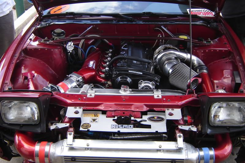

Looks great, works ..... ok.. They havent come loose in 3 seasons. But we are welding this year. Its will be a little stiffer.
[IMG][/IMG]
