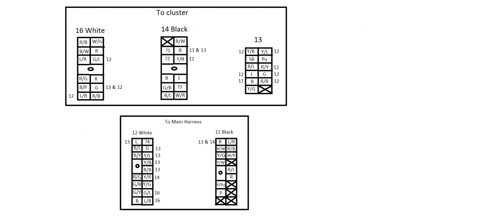

Old 02-16-2013, 02:26 PM   #9
s14boy
Location: chicago
Posts: 1,077
Trader Rating: (26)
s14boy is an unknown quantity at this point
Feedback Score: 26 reviews
ok here is my layout so far from what i can gather from the FSM and the Pictures sir provided above.
i still need the 4 unkown wires i have as well as were each goes. the picture is coaded as follows
?# are unknowns Ex: ?2
all the letters in the boxes are the colors Ex: L/W (blue with white stripe)
and the numbers to the side of the connectors corespont to the conector in whice the wire goes to Ex: a 12 on the side of the wire color means the wire goes to connector 12.
the conector numbers are per FSM as well as all color coads.
if some one could please provide me with some more pictures of the harness so i can finish tracing it out or if you could fill in the rest of it to help me out.
thanks
-Mike
s14boy is offline   Reply With Quote

anyone else wana help out?
-Mike

someone help me get the last few figured out please.
