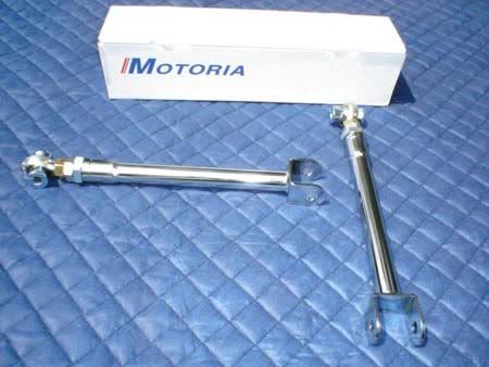

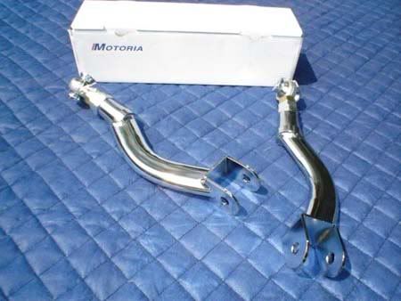

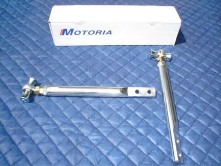

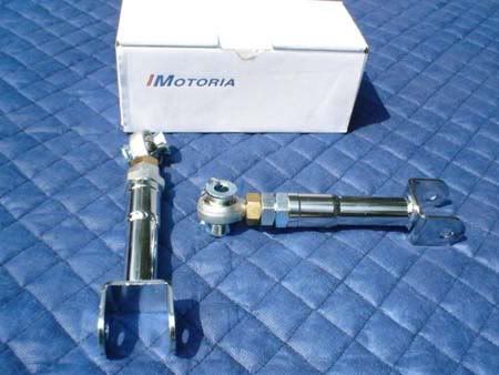

i was searching though ebay and apparently ss autochrome makes suspension parts for 240s now. they have a package which you can get for under $200 does anyone know what the quality of these part are and has anyone ever bought suspension parts fromm ss autochrome? what do you guys think. (PICS)
kit includes
traction rods (set)
s13 rear camber arms
s13 tension rods
s13 rear control rods
and thier diagram

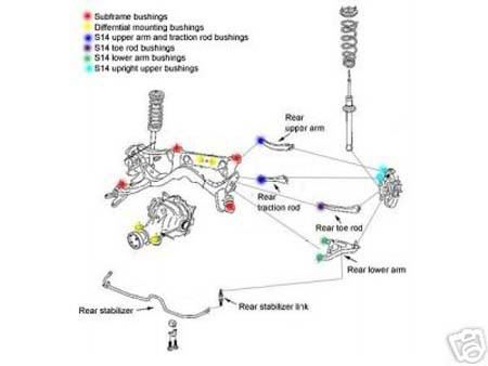

u mean FSM nissan diagram? lol.... those spherical's is what costs so much. im sceptical when it comes to ssac stuff

isnt that the same picture that splparts uses?? i know its from teh FSM, but they had teh parts labeled like that too didnt they?

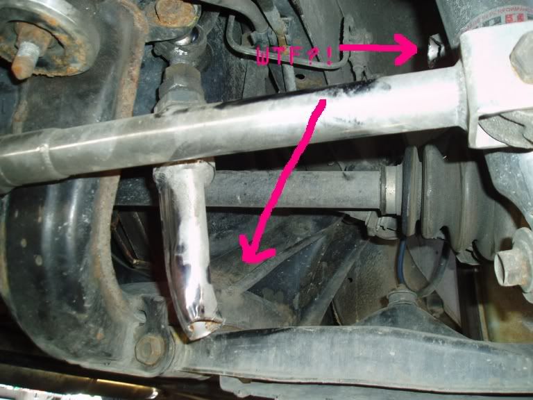

I bought the SSAC suspension kit towards the end of June. I've daily driven it along with 2 drift events. Then I went to a drift event yesterday and was comin around the bank noticed something wasn't right. Pulled back in the pit and took a look.
Adikt is offline   Reply With Quote
Old 10-02-2006, 07:46 PM   #22
Adikt
Adikt's Avatar
Join Date: Dec 2003
Location: Chicago
Posts: 278
Adikt has a spectacular aura aboutAdikt has a spectacular aura aboutAdikt has a spectacular aura aboutAdikt has a spectacular aura aboutAdikt has a spectacular aura aboutAdikt has a spectacular aura about
Send a message via AIM to Adikt
If you're cheap and you have a death wish buy them.
BTW in the whole time I had them I've driven about 2k miles on them and never hit anything

you should try contacting them so they can improve thier product or bitch at em to replace it.. but they might try to say "not for racing application or you probably hit something"
Looks like thier arm cant stand binding.. maybe thats what happened..

yeah so im going to say fuck it after seeing that pic.

I don't think it was binding. I greased up the balljoint before I put it on and when I checked yesterday it still moved very easily.
binding does make things break. but the joint is clearly not frozen (or even remotely rusty) in that picture. bind can also be caused by contact... but just looking at the picture, i don't see anything that the rear traction arm could possibly hit.
stuff tends to break where it is weakest. you'd think the weak section would be the threaded section or along a weld. but i guess the arm itself is the weak link? scary.
