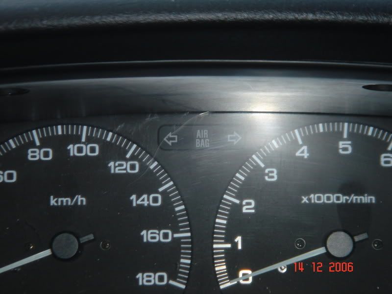

i wierd with the light throwing me off. My car runs on both the 62 and the E5 but with that light i assumed it was a 96+. Here are some picks of the light and the engine

but yea a 94-96 PFC will replace your e5.
the e5 and 62 ecu's since they have a shared pinout configuration... and i tried a 62 ecu in my car today, with the chips out of my daughterboard and the o2 works still... i drove around the parking lot and burned em off sittin there a lil and it seemed perfect -if anyone wants to see the log - i can send you it.
