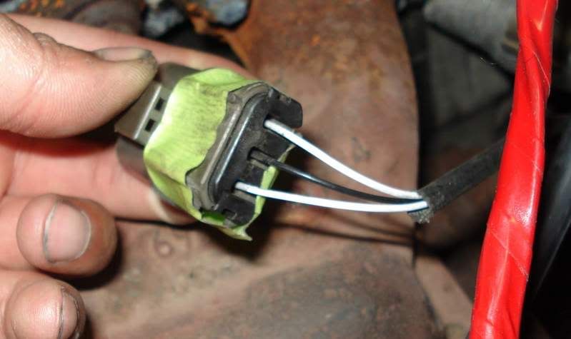

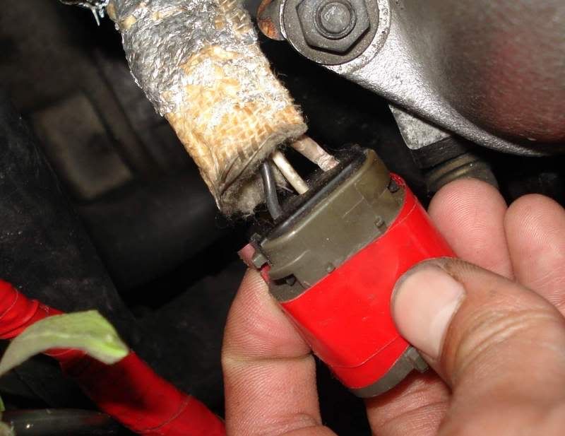

As for the o2 sensor, I am not sure if I should be rearranging the wires when I extend them because on the SR harness the wires are:
black
white
thick white
and the o2 sensor wires are:
thin white
black
thin white
Correct me if I am wrong, but to my understanding.. the o2 sensor plug is the one right beside the coilpack plug?
