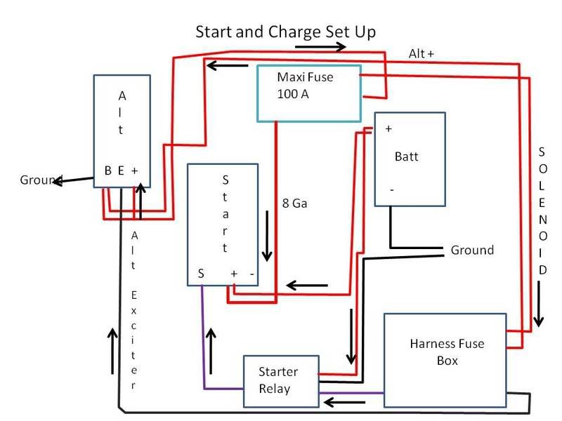

Originally Posted by CursedGTR View Post
Now this wiring thing is a pain int he fucking ass. However, I think I amstarting to figure it out. I would love to be able to beat this thing with a hammer and make the wires work but that is not going to happen.
I am using an EZ Wiring Harness and between their manual (which sucks butt) a painless manual (which is much more thorough) and an FSM I have come up with the following diagram that should depict how to get power to the harness. Now I have not included switches and all that jazz but I will as this little project evolves. I will even include pictures but for now this is what I have for the start up and charging system. Some of my arrows may be pointed the wrong way but I am pretty sure I got it right.
If you know what you are doing with wiring like this please feel free to comment or lend advice. I Would love to turn this little section of my build into a how to, for guys that want to do this kind of stuff int he future. I always see it done or alot of questions asked, but have never seen a thorough how too.
Red = Power (However each type of marked power has its own wire as depicted in the picture).
Black = Ground
Purple = IGN Switch Start
Dark Grey = Alternator Excitor
PowerWires Explained:
Battery Pos - Starter Pos Post
Alt Pos - Alternator Boot
8 Gauge Power - 100 Amp Maxi Fuse (Used in place of Fusible Link)
Alternator Boot - Maxi Fuse
Maxi Fuse - Solenoid Power on Harness (This is where the Harness gets power from)
Alternator Excitor From Fuse Panel - Alternator
An Additional wire is added from boot-alternator terminal
Alternator is Grounded to Engine Block
Ground is Ground
Starter Relay
Ground
Power Constant from fused Wire to Battery
Purple Ignition Switch from fuse box to Relay From Relay to Starter Signal.
Maxi Fuse replaces Fusible Links at 100 Amps Rating
Sounds like quite the project. I'm familiar with wiring for the most part and can double check a few things after work... but so far that looks correct.
Did you decide which engine management unit to use yet?
BTW, the car looks incredible, going to be a sad day when you have to leave Okinawa.
dude a double check would be quite appreciated. I am going with a Microtech LTX12 got a line on one already loomed for RB at a good price so I am going to get it. Should that fail to do what I want it to do, we might go back to the basics and put a Power FC D Jetro in there.

The wiring still looks correct, I couldn't find anything wrong with the routing. Double checked with my friend who is an electrical engineer, and he said it looked up to par.
