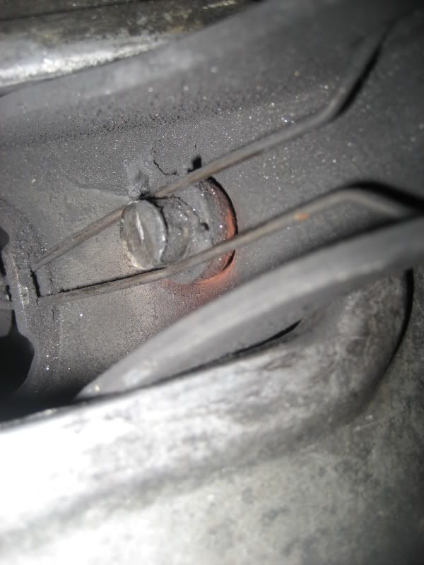

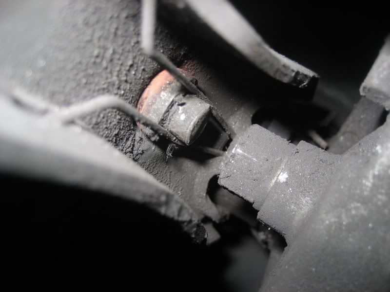

WTH Caused this? pic inside!!!
For those of you that do not know what that is, it is the clutch fork pivot ball.
anyone have an idea why this snaped?
Do you guys think it is possible to fix this with out taking the tranny off?
Is this a part i can buy anywhere such as a dealership or a auto parts store, and also is the ka pivot ball the same as the sr?
thanks, brent

Happens a lot, that's why Nismo makes an upgrade. Too stiff a clutch will do it easily, so will abuse.
Transmission has to be pulled to replace it.

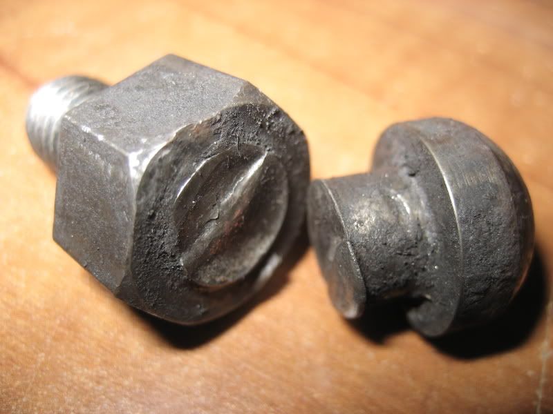

damn,
im running a act 6 puck unsprung clutch and a act streetlite flywheel.
update pic, got the pivot ball out (having ratchet wrenches is the best)

Red hole between the input shaft and the fork hole.

Originally Posted by DisEpyon View Post
damn,
Was there any grease on that?

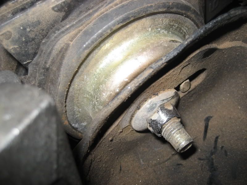

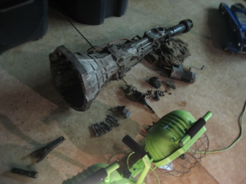

i do not remember. if not i bet thats what help caused it to snap.
update:
Got the tranny out, now just waiting on the pivot ball and rear tail seal.

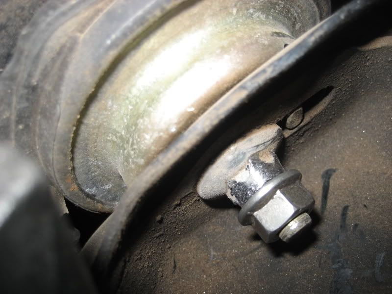

then i ran into another problem. I was trying to loosen up the nut for the engine mount so the motor can have some play to swing back a bit, consequently, the nut strip. I tryed the bolt out method and that didnt work. however i came up with a new idea.
that idea is to take another nut and weld it to the pre-existing nut and try that, so far i havent got that far yet.
DisEpyon is offline   Reply With Quote
Very common, with the nut on the lower side it sees more moisture and seizes to the stud. It's also at a slight angle when you hit it with a socket so it doesn't sit flush on the nut. I cut one off a car with a sawzall not long ago that was rounded off.
