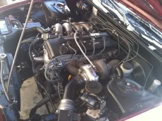

Ship2236...Setup info please? Pics?

96 long block w forged Internals,370's, 50trim Godspeed t3/t4, Godspeed cast mani, z32 maf, rom tune, 288hp 302tq 10lbs.
