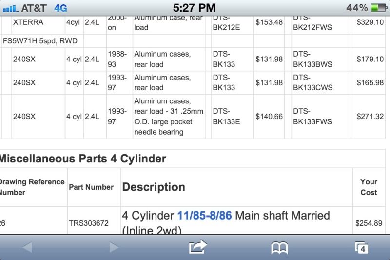

Well since the thread is already started I'll go ahead and ask this question. How can you tell which years your tranny is? I'm looking at buying a rebuild kit for my transmission from this website: Nissian 4 and 5 speed FS5W71 Manual transmission Rebuild kit parts | FS5W71C overhaul kits - Drivetrain.com
Which has different prices for the 88-93 and 93-97 and then different pricES for the 93-97. Anyone know?
Here is the picture that may explain a little better.

i'm pretty sure the acronyms at after BK133 mean that they come with different things. if i were you i'd just call that place and ask the questions to them. they'll be able to answer your questions alot better and be able to give you more advise on which will be best for you and you're application. also provide your vin on the car and also try and find the data plate on the tranny and that stuff will help with their timeliness.
