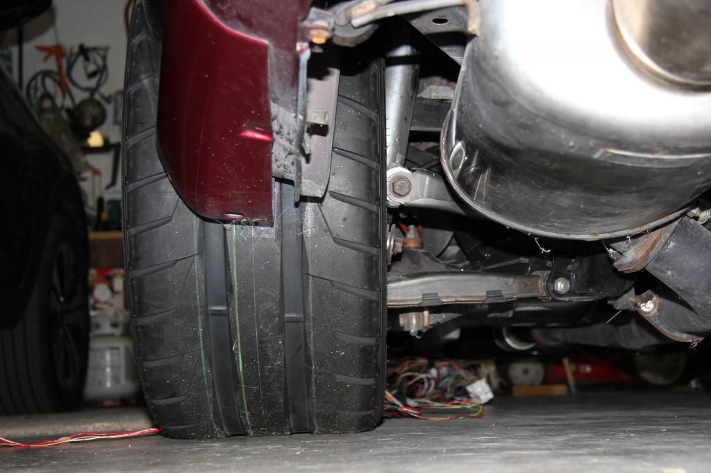

Question for you guys.
I'm running 18x10+38 RPF1's with 275/35/18 on the rear of my S14.
I was rubbing wheels on the Rear LCA [the forward portion of the "A" arm] when the car was lowered[tucking 1/2" of tire in the rear with about 0.5degree of camber, 0 toe, 3/4" fender pull/roll on stock metal] on coilovers.
I have sold the coilovers and now am on KYB GR-2's with Tein Lowering springs so no more problems, but I will eventually lower the car back down to it's previous height.
How can I modify the stock LCA to keep it just as strong but give me more wheel clearance? [with out buying after market tubular arms of course]

Absolutely... You'll have to notch where the wheel was hitting and box it back in. If I recall correctly, Toby has the same thing done on his S13.

I'm assuming you hit because the angle of that arm was actually at an upward slope towards your ball joint, rather than remaining level/flat to the ground. If this is the case, you have a few options without really modifying the control arm.
1. You could get roll centers, which would correct some of your geometry in the rear and move the arm closer to level. This would probably let the car ride better and lessen the amount you may have to clearance on the control arm.
2. Add a small spacer in the rear (2mm or so). However, you'll have to pull the rear fenders slightly more.
3. You could grind the lip of the control arm away just where the rim impinges.
4. Aftermarket LCA's are an option and would give you the best all around combination of clearance and adjustability.
However, if you want to absolutely modify and give the best clearance, I would mark and pull the arm. Notch it, then reinforce the LCA with the same or heavier gauge material, connecting to the existing portion of the arm not needing clearancing.
I have roughly .500" between my LCA and wheel. Im also running +36 rear wheels and not nearly as low as you were. I intend to have my fender arch even with the top of the tire, not really looking to tuck.
I've been looking for photos of notched LCA'S but no dice as of yet. It seems that everyone wants to be herraflush and sacrafice grip for fitment.
Roll center adjustment with stock LCA at that height would also require a notching/reinforcement, because at that point, the LCA would be berried into the wheel.
spacer is not an option as I absolutely want to be able to stay hub-centric, so the minimal amount of spacer I would use is 10mm slip-on with built in hub-lip/ring.
I have ground down the lip leaving about 1mm of metal on it still not wanting it to bend, but it's still so scary close to the wheel.
I don't care for the aftermarket LCA's as I am not doing any professional racing or drifting.
yeah, i have no luck in finding anyone with notched LCA's either. but I want to be herraflush and have no camber either
i unno..trying something new here, not trying to prove anything to anyone but to myself.
I want to be about 1/4" lower then this picture eventually.
