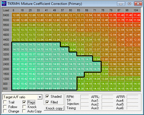

Ok BigVinnie I wanna see what you know tell me where;
1) A boosted KA24DE (stock ECU) with 370cc injectors will hit zero vacuum in this map with a stock MAF sensor:

Well case in point the stock ECU never know's what size injectors it has, and a boosted KA24DE will hit 0 vacuum/boost transistion right about the ~64 LOAD section (I knew I should have wrote this down when I logged what a stock ECU boosted did on the map):
At this time between 1,400rpm and 3,000rpm (remember its interpolated to above and below cells) your are stuck in the ECU controlled part of the map which is commanding a 14.7 AFR (NOT GOOD) because by this time you are making boost allready.
To further put salt on the wound your timing is a 23* to 32* and this point in time depending on rpm ofcourse.
After you adjust your k value aka injector multipler and latency for the 370cc injectors so your shit runs right, you will access a different load at 0 vacuum/boost transition it will no longer be ~64 it will be different, it will actually move lower which means to the left of the map which means more timing and leaner AFR's, and the larger your injectors the smaller your k needs to be and you guessed it you move more to the left of the map, ofcourse this is all with only a change to injectors.
