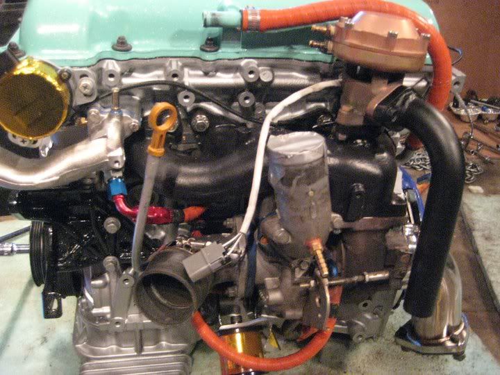

I use an Extrude Honed OEM manifold, with a provision for external wastegate.
Even without the wastegate flange welded on, you can't beat hte stock manifold in regard to reliability, and results. The heat retainining ability lights the little turbo super fast as well. Tubular manifolds are just plain unreliable if you ask me...way to many crack, from cheap to good ones.
For the cost of Extrude, I'd go that route, as it's cheaper than a Tomei. For another 100 bucks you can have the external gate modded too like I did.
With gate:
Extrude GOodness:

High Performance, High Output Racing - GetHoned (Extrude Hone)
They take roughly a week to 10 days turnaround for it...it's easier to just buy another stock manifold and send it out, limits the downtime of your car.
In regard to the external gate, that takes about a week from JPC depending on how busy he is with other stuff. If you want that done, shoot me a PM and I can get you his contact info. I typically have the manifolds shipped to me, and then he picks them up as he comes/goes from work at my house.
