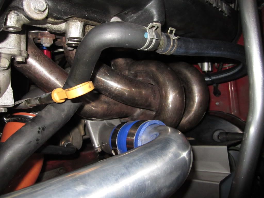

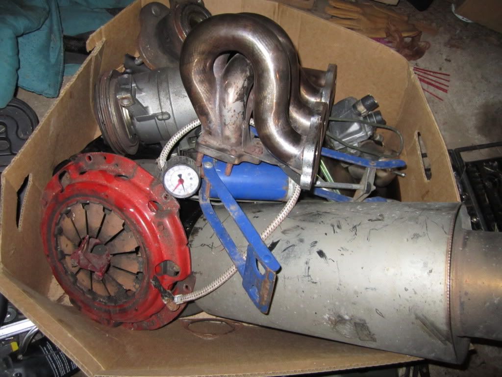

update, sorry for taking so long stupid life has been keeping me busy lol
heres the SUCKY sr
Manifold in question'
lol
Found the problem.
into the scrap metal bin!
anyways, i think the only aftermarket manifold im ever going to run is Full-Race. my SR runs fine now, few kinks here and there i need to find time to straighten out but i fixed this, no more leaks! got me to work yesterday. thanks duders fot your help
