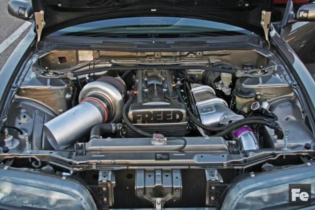

Ben, what radiator is that in your S14?
custom Griffin
